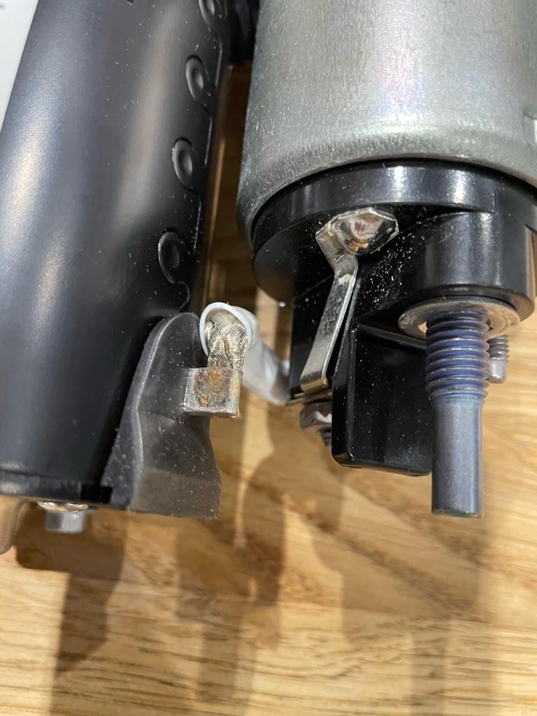

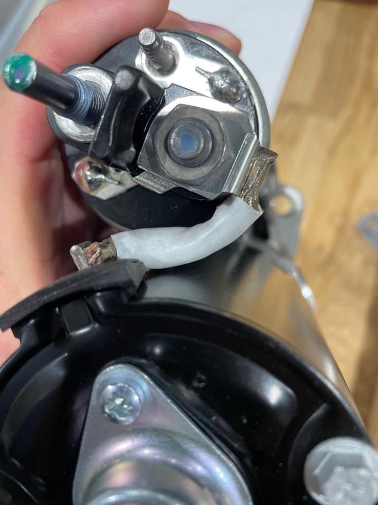

Does anyone have a picture of the starter motor installed with the manifold in place? I’m trying to gauge how much space is around it as I’m looking into heat wraps or shielding (in addition to what’s there already). As you can probably guess I’ve killed another one and I’m looking to engineer some longevity and reliability into the setup

I wish I knew the answer. Probably the shitty exposed wires. I’ve got a brand new OEM one waiting to go on, the one that I had fitted last time was a reconditioned Bosch unit
I’m going to try and wrap the unit itself but also see if I can do something to properly thermally insulate the exposed wires.

See if you can get some heat protection on the brazed wire connections that’s where they seem to fail
What’s your plan? My concern is creating something that then shorts on the manifold / heat shield, RT125 epoxy is used in harnesses which might be an option to create something that shields and protects
My plan is to remove the brazing and maybe add some crimped terminals on each end. Drill through the tabs of the motor and create a system where the wire terminals are bolted rather than brazed. Then I plan to wrap the whole length of that wire with heat wrap. Then also wrap the body with a Funk Motorsport wrap.
