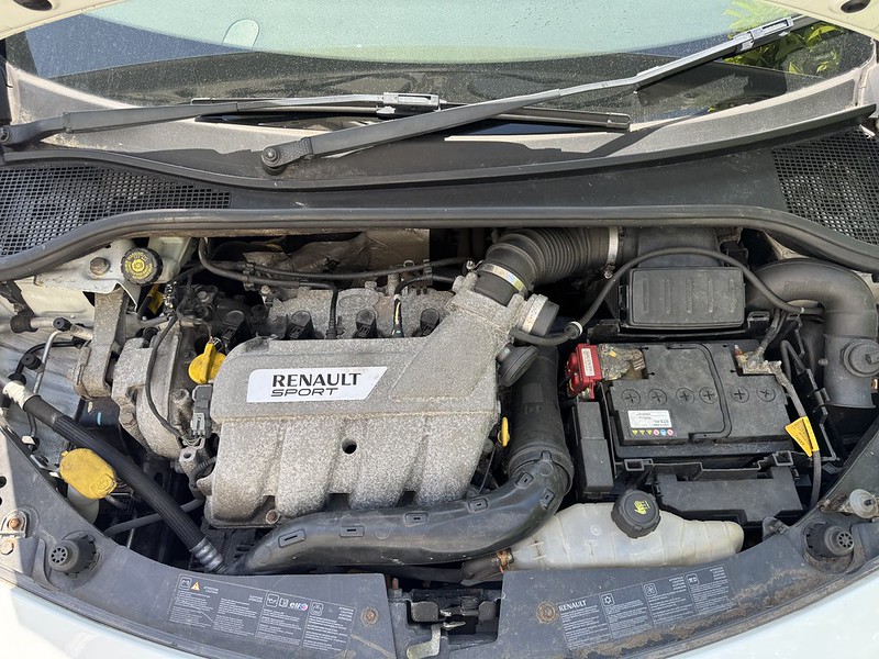

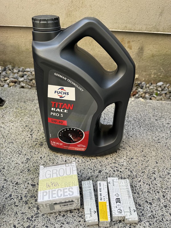

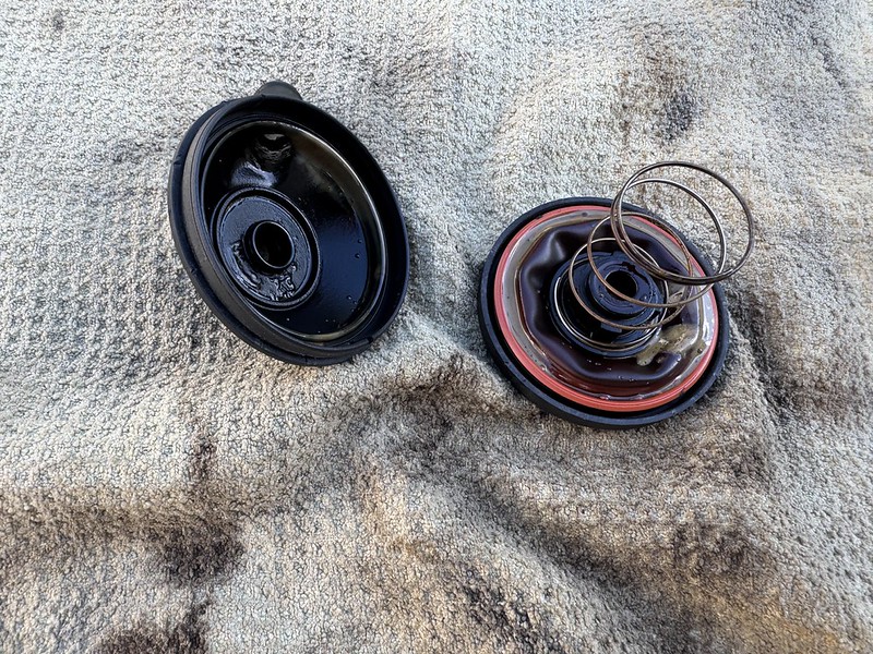

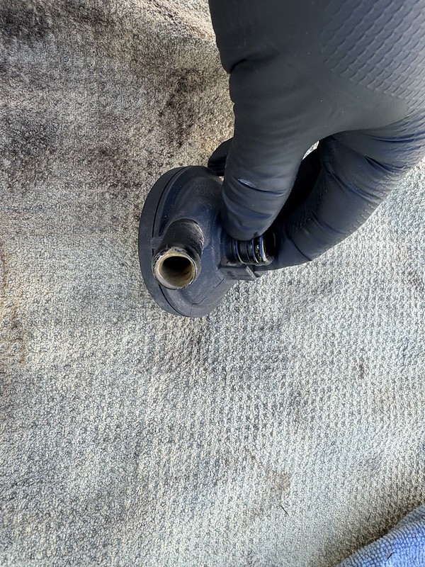

I’m going to give it a service and make sure to get some decent oil in it. Upon delivery, it had a strange beeping noise coming from the engine bay. Turns out it’s coming from the PCV valve (a new one on me!). It only does it when cold. I had intended to just replace it, but the part isn’t available until August so I’ll have a go at cleaning it.
[/url]

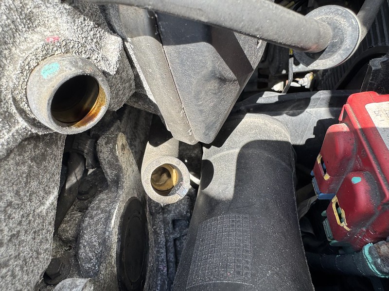

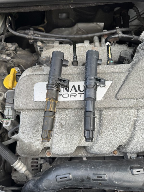

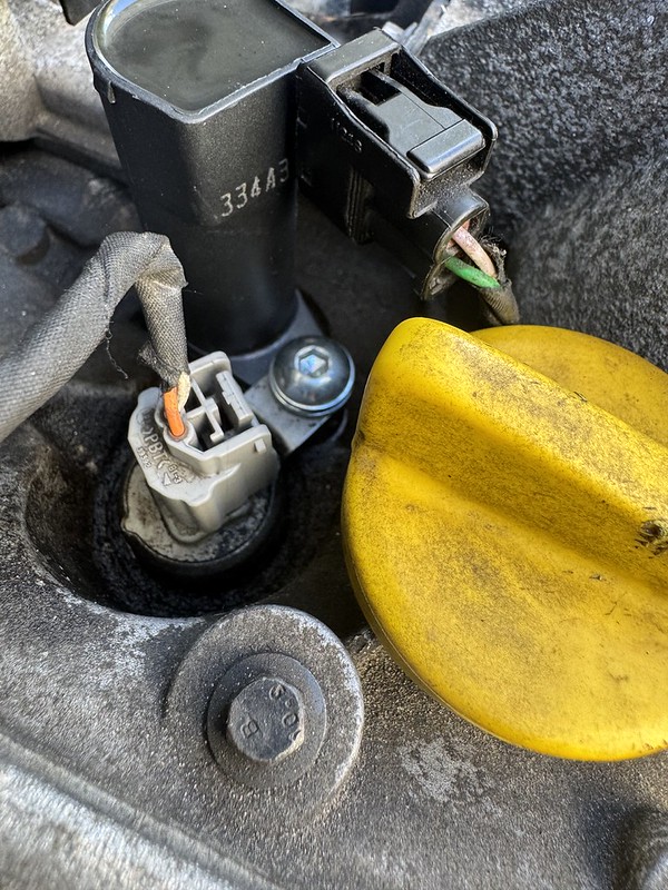

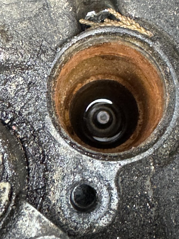

I also found that one of the coil packs was loose, and when I took it out, I found some water around the spark plug. I know it’s common for these to leak rainwater past the washer jets, and for the washer jet hoses to disintegrate from engine heat. Water then pools on top of the engine. It looks like mine is the former, so I’ll get that sealed up and replace the coil pack and plugs.

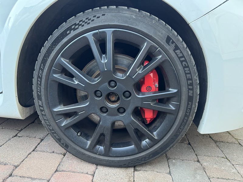

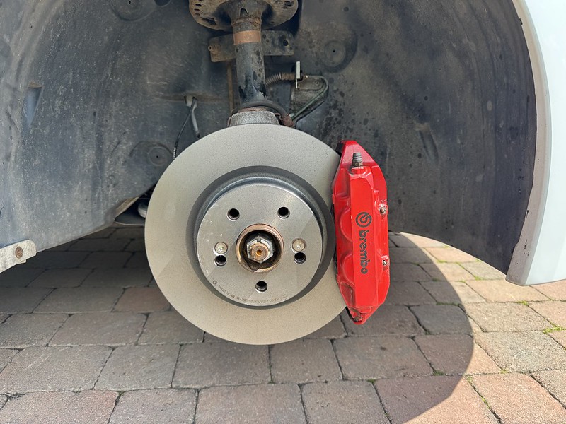

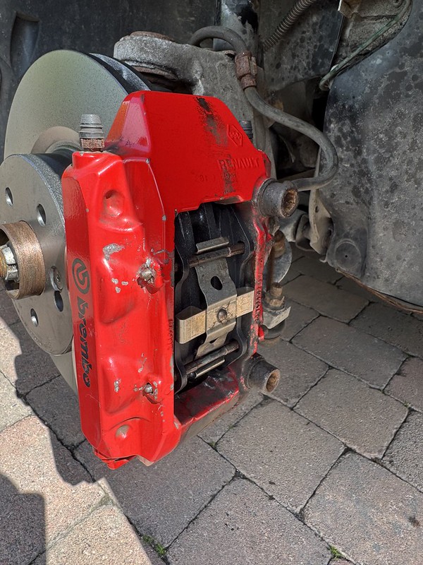

Will likely replace the front discs. They look like they could do with a freshen up. Will see what the pads are like.
