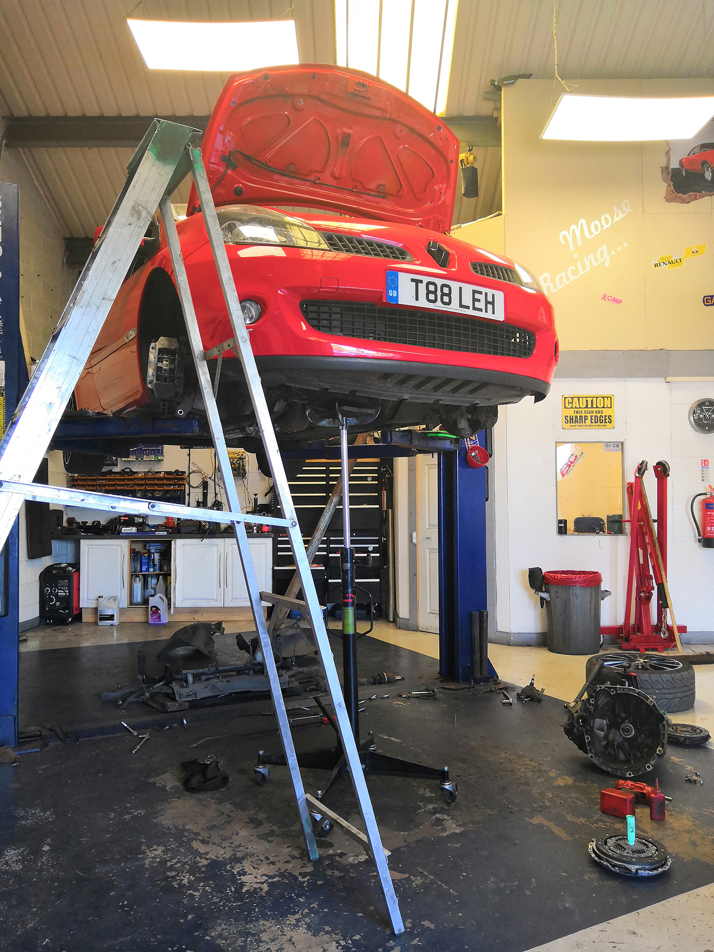

Also big shout to Mark at Midlands Renault Specialists! Unreal speed and quality of work. He had the subframe off and the box out in an hour, probably would have been back on the road in three if it hadn't have been for the clutch master cylinder.
Couldn't get a new one for that day so let me borrow his black 197 for a few days to get me back to Peterborough!
