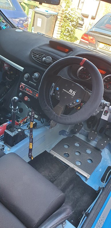

Stripped interior, including all airbags and used a friends clip to remove airbags from firing = No warning light :smiley:
Fitted:
-R020 Safety devices rear cage
-Corbeau clubsport XL bucket seats with side mount direct to sparco subframes - No runners
-Securon blue 4 point harnesses
-Painted rear ultra racing bar satin black to match cage
-Motamec driver and co driver footplates (No pics im afraid but you can use your imagination!)
-Sprint booster - another eBay bargain - Makes a big difference!
-Ram air panel filter in original airbox
-New battery as the original Renault one failed!

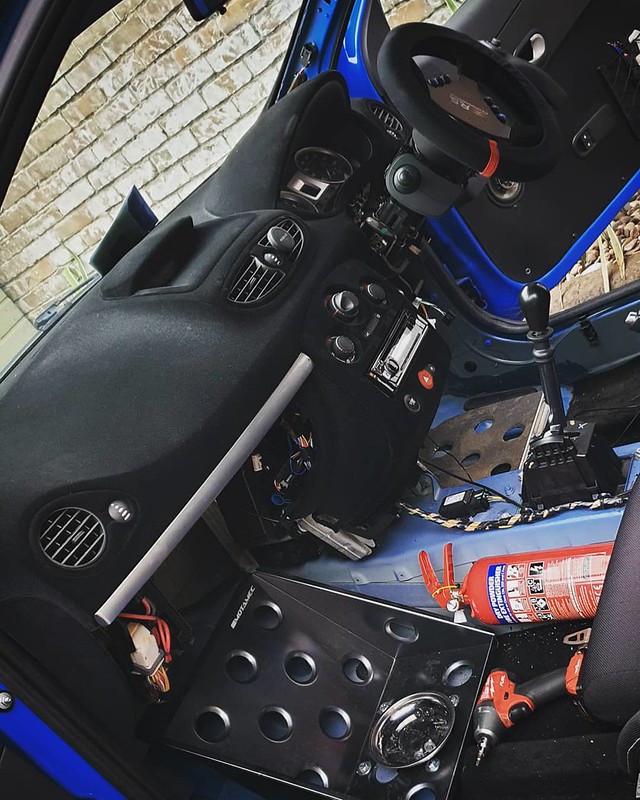

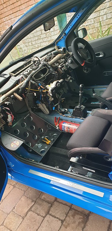

Latest update! Ive been busy...
Fitted:
Next up is to:
-Fit turboguage (Scangauge copy) - Live data on a basic screen that should be able to fit in the original clock location which is now defunked
-Lower steering column
-Door handle micro switches and paint gloss black
-Make some door cards from ABS sheet
-Black headlights
The never ending project! Hoping to get on a track day before the year is out:french:

Update:
-Black headlights fitted
-LED nighteye h1 dipped beam bulbs - MUCH better + Beam pattern is good
-Front door cards made from scratch with 1.5mm ABS plastic
-Thin campervan carpet glued down in front footwells to save floor being ruined!
-Turbogauge (Scangauge copy) fitted for live data
-Helmet hammock fitted also
That's about all this year, hoping to get on track at the start of next year! :smile:

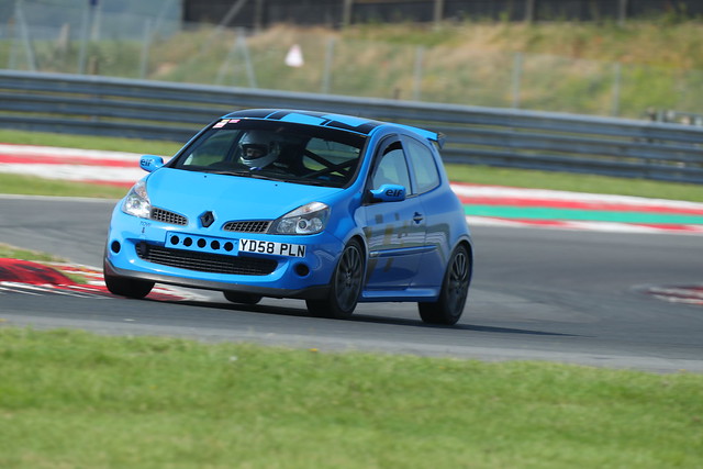

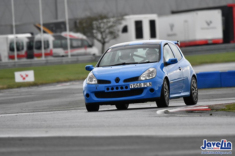

Went to Bedford for a track day back in February, 1st track day in the baguette and it performed well!
Was quite damp and struggled for grip coming out of the bends. Also had quite severe brake fade after not long!
Also managed to carry out what seems to be standard procedure and melt the rear splitter!doh!
Since track day I did have castle Combe booked but unfortunately this has been cancelled. Hoping When this all blows over to get straight back out on track!

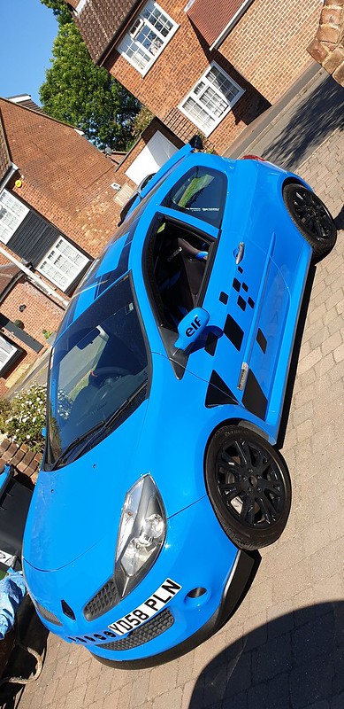

So since last post I have managed to spend some time on the car. Have done the following:
-Fitted rear tow strap
-Remove rad support mount and cut off legs and paint
-Fitted front Renault Sport splitter

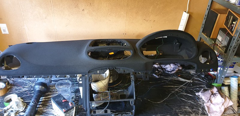

-Flocked the dash
-Larger customer pedals with grip tape

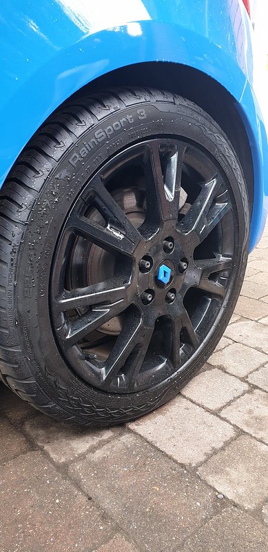

-Speedline wheels added

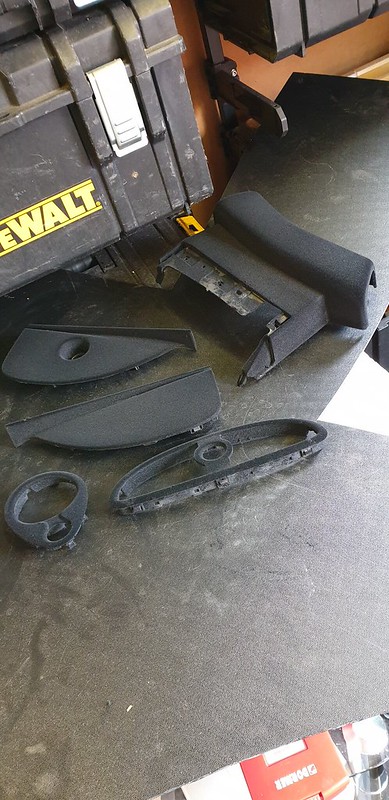

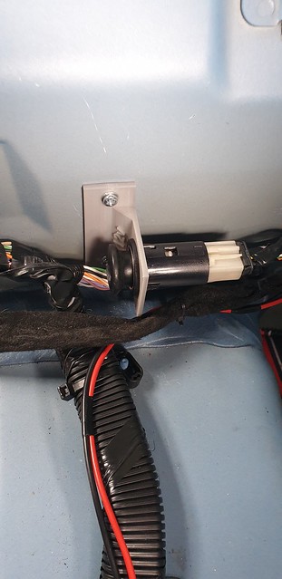

-3D printed a 12v socket extension
-3D printed a go pro mount
-3D printed a light switch panel mount
-Side graphics added

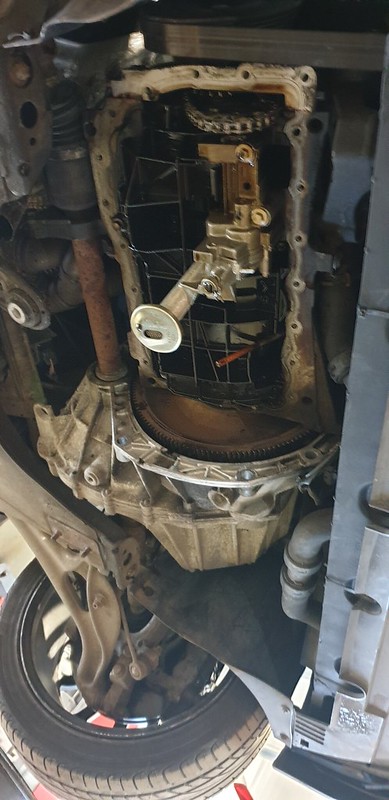

-Sump gasket replaced

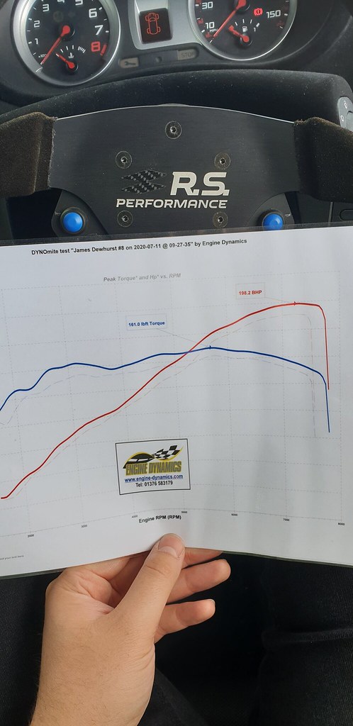

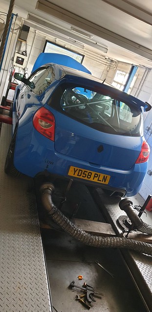

Remap completed yesterday down at Engine Dynamics, Chuffed with the results. Other than additional power, the drivability and smoothness has improved greatly! Definitely recommend! 198.2hp - Nice to know the engine is healthy
:smile:

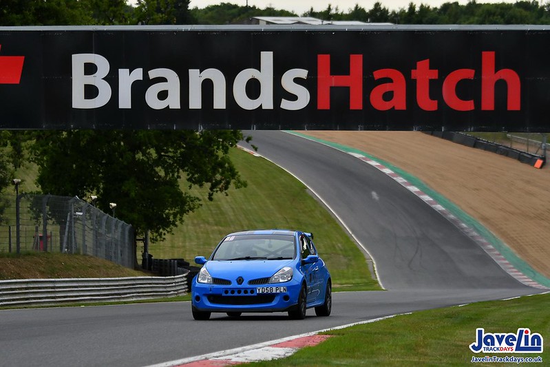

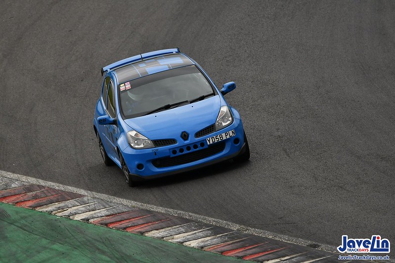

So 3 days after the remap we had an evening at Brands Hatch - Brilliant track!
Also bought a ZPO shifter - wow! Why didn't I buy one of these before!
Next track day is Castle Combe 17th August :smiley:
