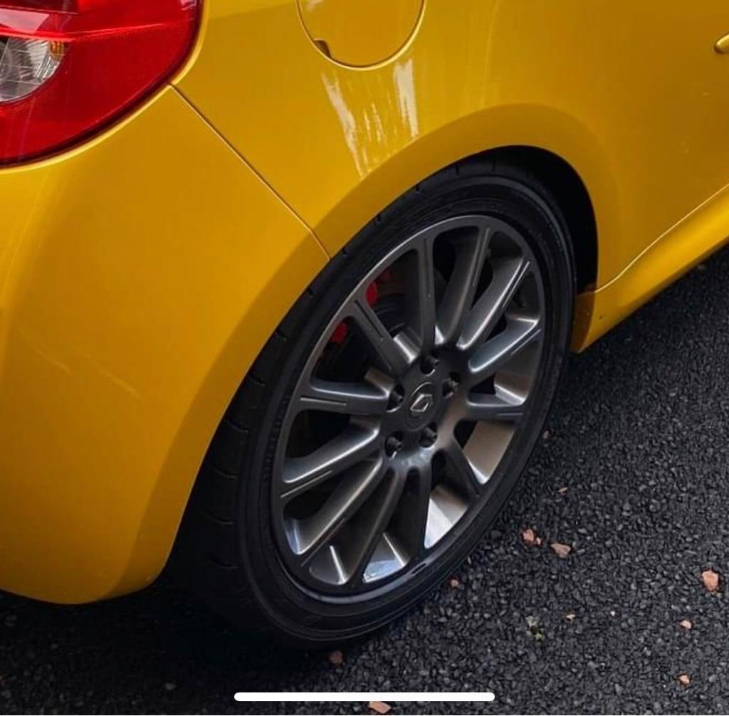

Does anyone have the paint code for the graphite/grey wheels on the F1? I’m having a set refurbed for my car and would ideally like to get them colour matched so the wheel centres don’t look out of place. I’m guessing wheel centres are still obtainable?
Pic for attention but not mine!
If only I’d thought to search first, once again answered my own question ....
I cant find anyone who can paint the wheels the right colour most say the true colour is not available in powder coat. The 197 Anthracite colour (205-272) so they want to paint the colour they want, you need to be careful asking as well because the 182 Clio is a darker Anthracite so saying to someone Renaultsport Clio Anthracite can be different colours. But a place in Derby says they can sandwich the true colour between the undercoat and clear which after the BSB announcement today starting the championship at Donnington in August I might bring all my wheels over to get done while I am there.
