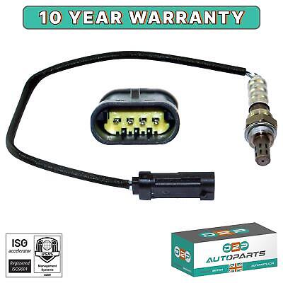

Buy this on eBay. Get the car up on a ramp, swap it out for the first pre-cat O2 sensor, get it warmed up and take it for a retest.
If it doesn’t work, you know it’s not that. If it does work you can either stick with the £20 sensor or replace it with an OEM one knowing that was the issue and throw this one in your spares box.

It does smell rich, and mpg not good- so as other contributors suggested have asked for the pre cat 02 sensor to be changed, then see where we are
Am doing this- hope your advice is sound :smile:
