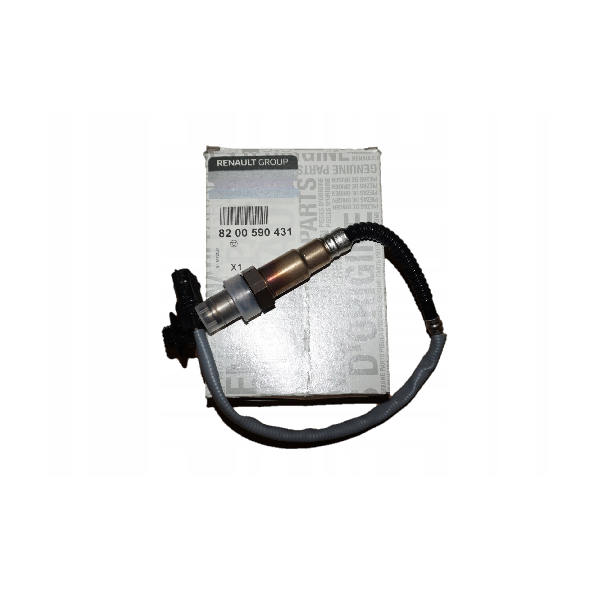

Just phoned Renault Main Dealer spare parts for info- and I know theres lots threads and comment on this site bout LAMBDA sensors
So- 7700107433 is the correct pre Cat sensor (£168.07 + VAT)
They then said the after CAT sensor was 8200590431 (£168.06 plus VAT) when around this site it says 8200830903: so, which is right?
Was gonna try replacing both sensors before thinking the CAT has gone to its grave, and buy one of them

These part numbers on Dialogsys could be old and have been superseded. RPD have been good for me in the past, I'd take the punt on 8200590431 if I was you, as it says suitable for the F4R engine in the Clio.
