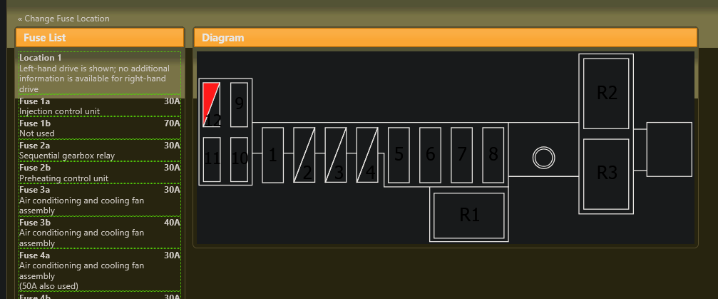

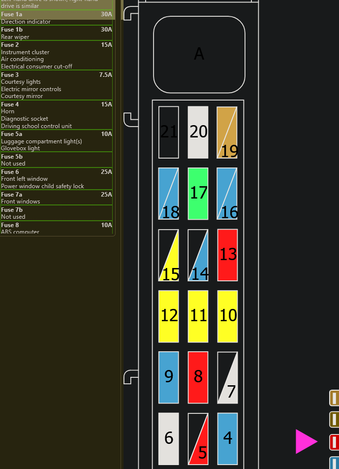

AA came and checked all fuses, tried it on jumper packs. His OBD reader powered on but could not connect to the computer. He then towed me home.

My code reader does not connect to the computer. Says it is not plugged in or ignition is not on. But it is because it powers up the code reader.
TLDR ignition powers on, but no crank and no start. No power to OBD port to read. Starter motor turns ok when solenoid directly triggered.
