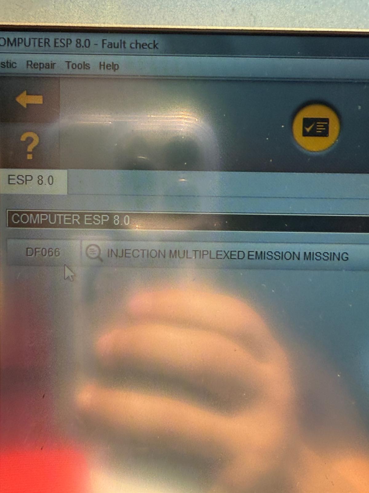

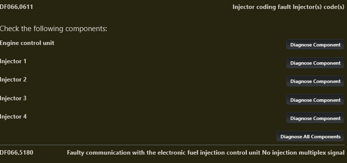

So i actually bought a Clip diagnostic and the first thing I did was run RZ005 adaptations program but it made no difference,however now I can see a new fault code: DF066 Faulty communication with the electronic fuel injection control unit No injection multiplex signal.
As i seem to understand it it's somehow missing the power supply to the ecu from the uch or injectors?
Putting that code in Haynes it comes up with testing the injectors 1 to 4:
I was able to easily check the 4 injectors,voltages on Pin 1 and all the resistances on pin 2 which are 0,5 ohms which is correct.however if i click on engine control unit:

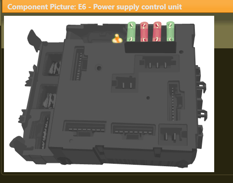

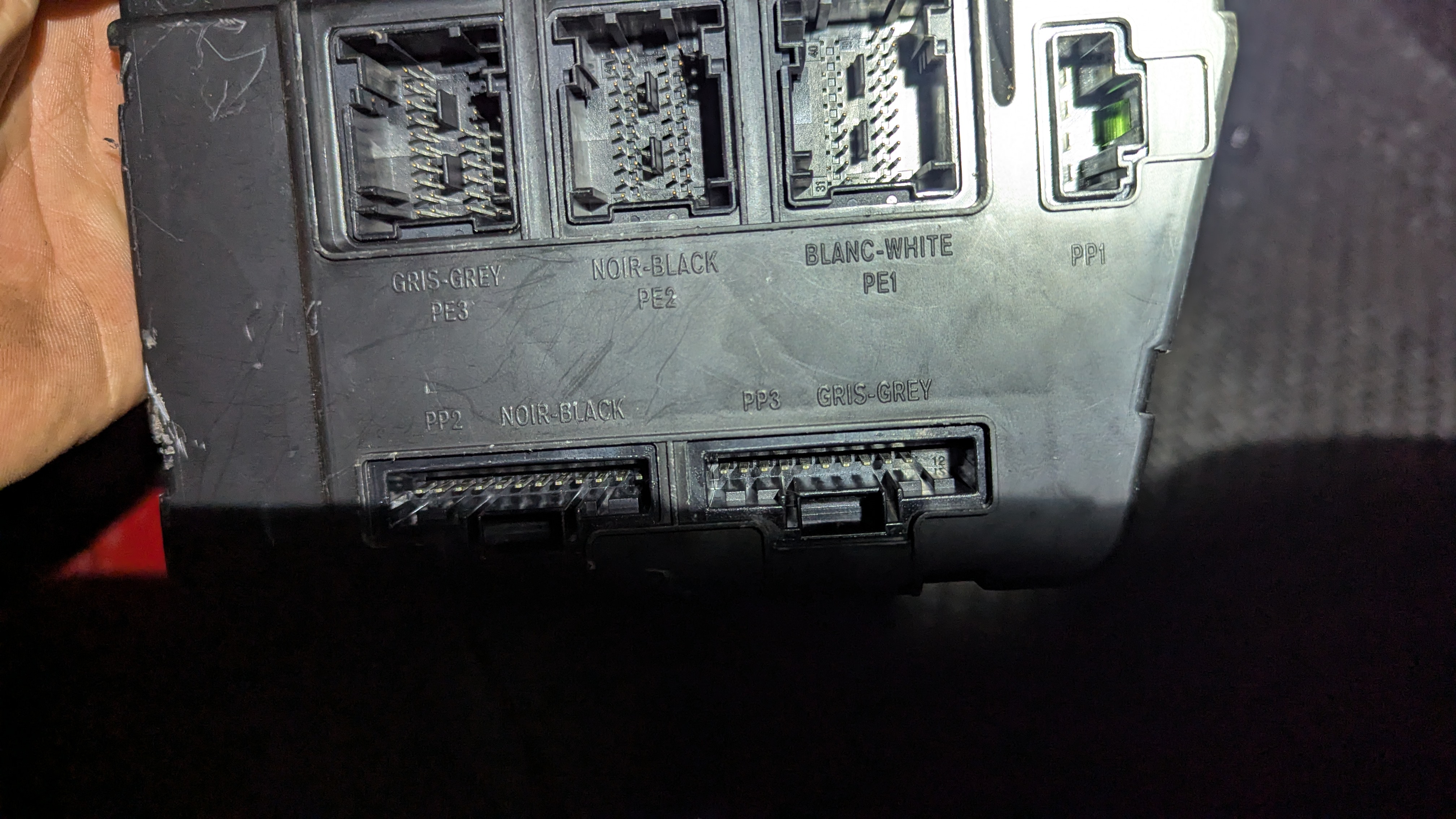

it also tells me to check the resistances (six of them) between the ECU and E6 power supply unit below (which is the UCH as I understand it in the engine bay passenger side) picture seems similar to the uch:

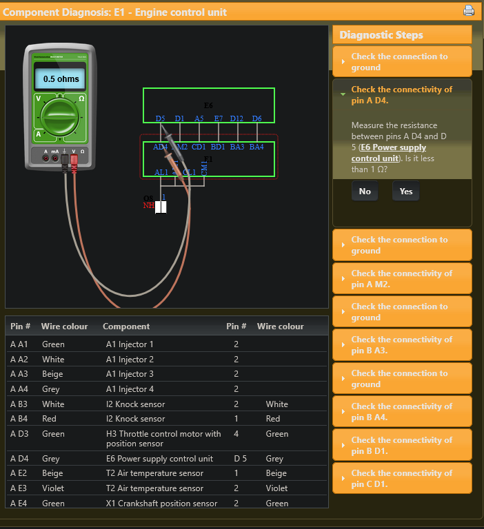

However now i'm a bit stuck as it tells me to check the following resistances from ECU connectors (which is all marked and easy to find) to the power supply unit (UCH) which i have no idea where to find as I cannot see any markings?
-pins ECU A D4 and D 5 - E6 power supply control unit
-pins ECU A M2 and D 1 - E6 power supply control unit
-pins ECU B A3 and D 12 - E6 power supply control unit
-pins ECU B A4 and D 6 - E6 power supply control unit
-pins ECU B D1 and E 7 - E6 power supply control unit
-pins ECU C D1 and A 5 - E6 power supply control unit
So i am really not sure how to find those pins on the right side on the UCH.

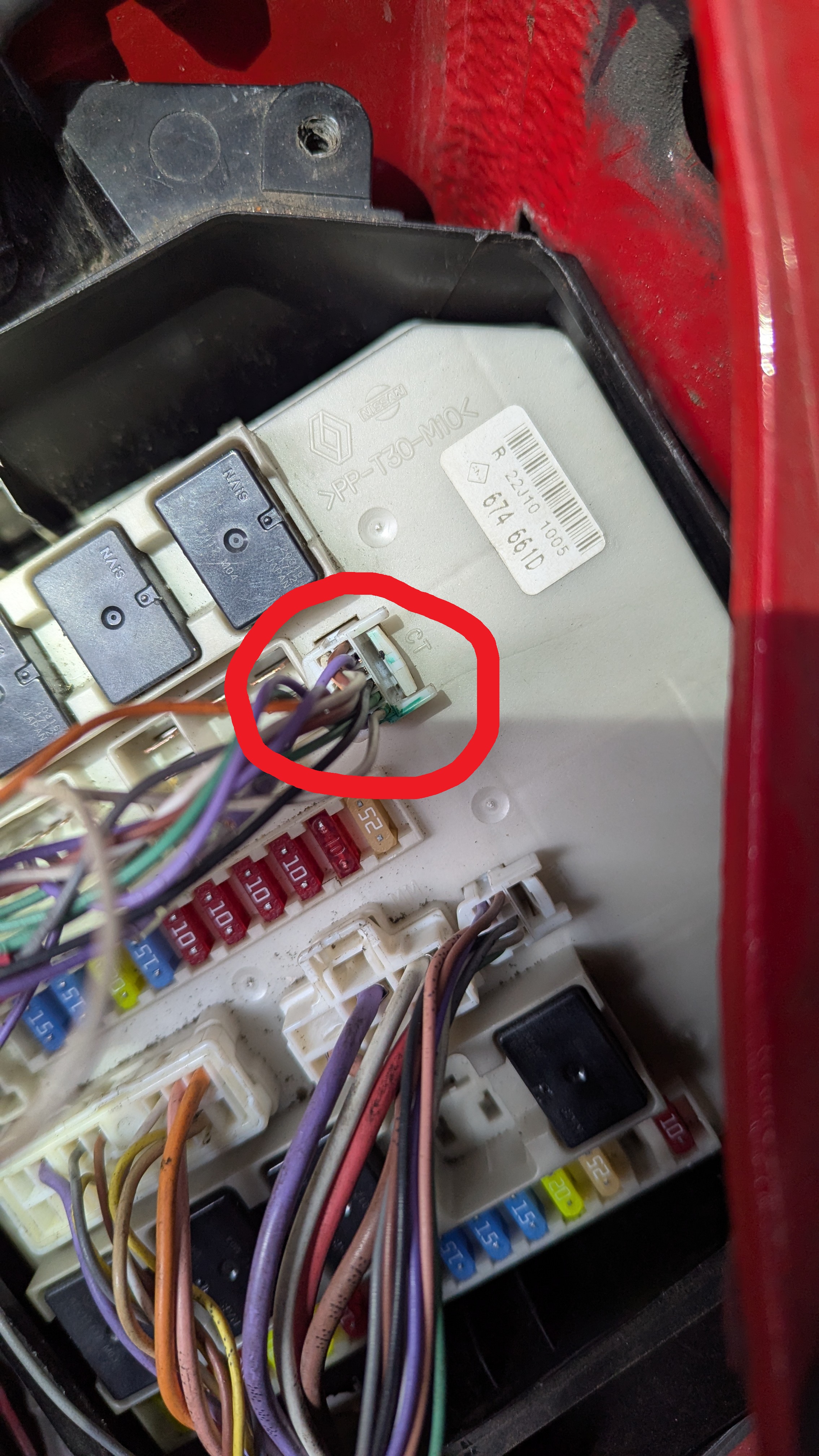

This below is the connector that is refered to above I believe?
I noticed there was infact more than one previous repair done to the wiring the one below which was soldered and now I just used crimped terminals,but it didnt make any difference to the issue anyhow.

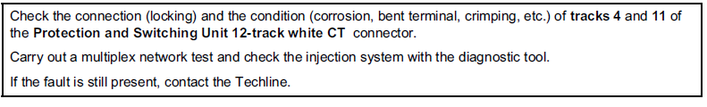

Thanks so much,I will go ahead and print these for future reference altough I can't see anything related to the injection that would affect the engine on the interior body module.

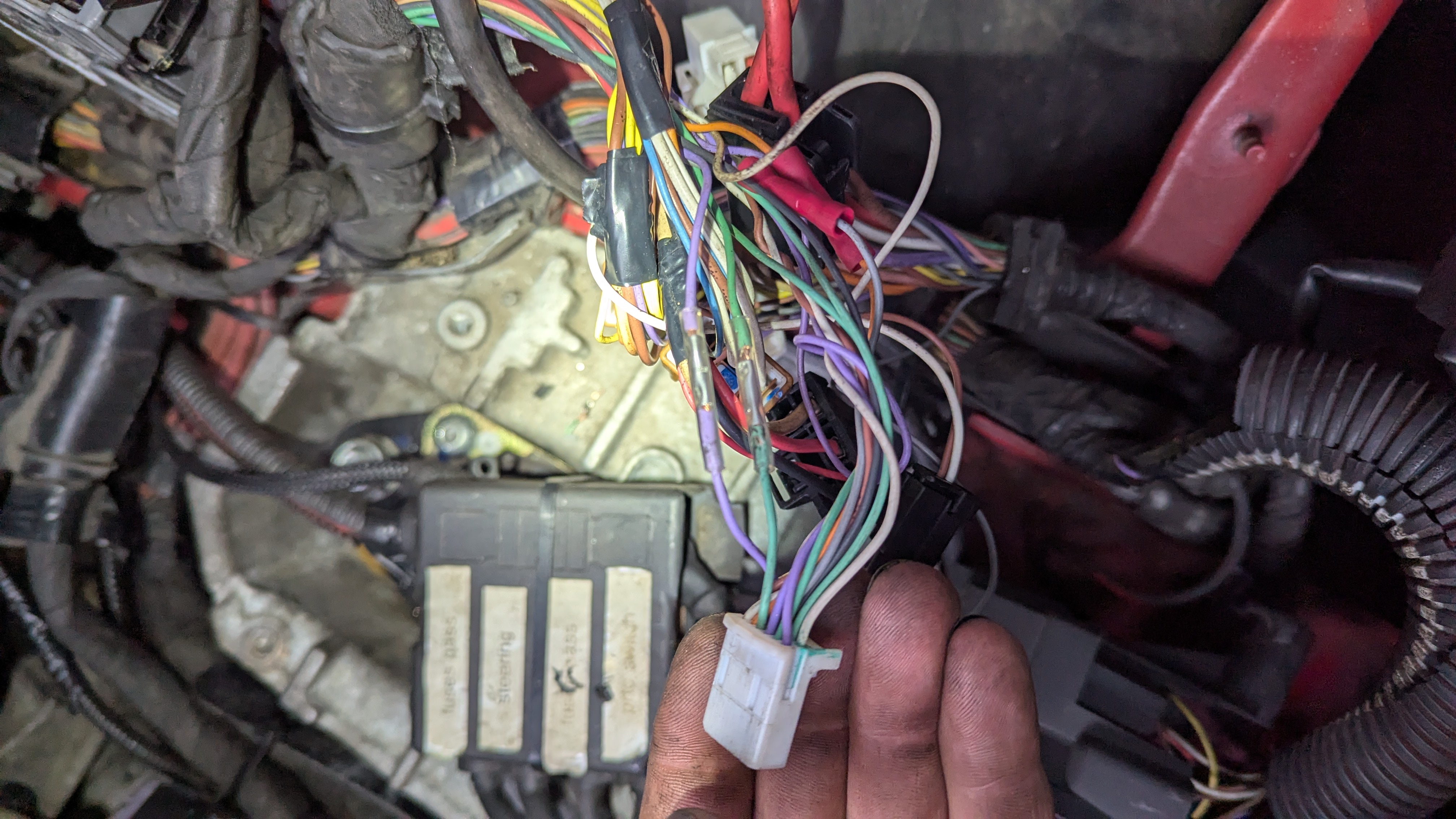

I can see on my UPC on the white CT connector there is been previous repairs on both track 4 and 11 wire grey and orange,ABS CAN high signal and Low signal,I will inspect these hopefully will find the problem there,thank you.
Yes indeed,about 4 wires have had a repair on them, although they all feel solid and can't see any breaks.
Can bus works on resistance between the two wires for communication I can't see why that has been done you said the second Lambda was dead on the car that needs fixed and will affect fueling and engine running. To join the wires I would use solder joints with heat the solder melts and the heat shrink seals the joint off.
With a small Butane soldering tool it will be easier to carry out the fix and less risk of melting something else
