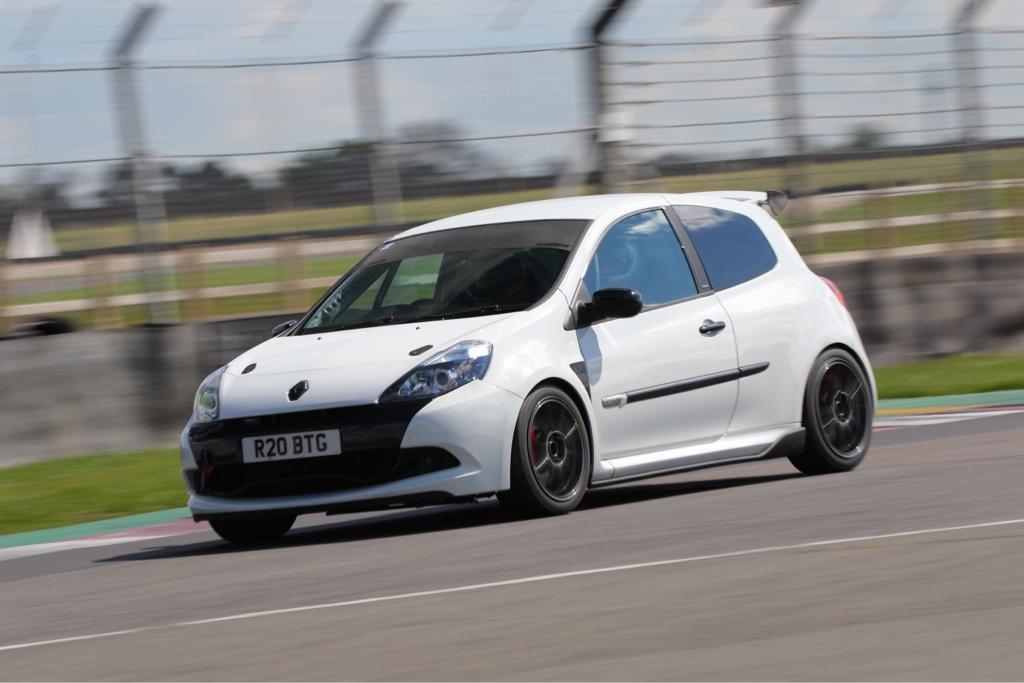

I bought my Wizards from @R20BTG and they're absolutely fine. He had a big off into Donington gravel sideways, I've had 2 big spins onto soft grass as Cadwell and Snetterton, still going strong. No sign of cracks or bending. Plus the fitment is really good, they sit perfectly in the arches in my opinion
To add to that, in my ownership they've done around 12 trackdays, all of which have been spent taking kerbs with way too much reckless abandon. Surprised I haven't broken anything really...
