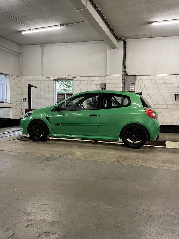

Its been some time since i updated and where do i start, very little work took place over the last 6 months, just been to busy, but managed to get the lads onto it this last few weeks and got her running and back on the ground, we was able to move the charger resivior to level to the charger to reduce load on the seals when stood, as well as moving the oil cooler

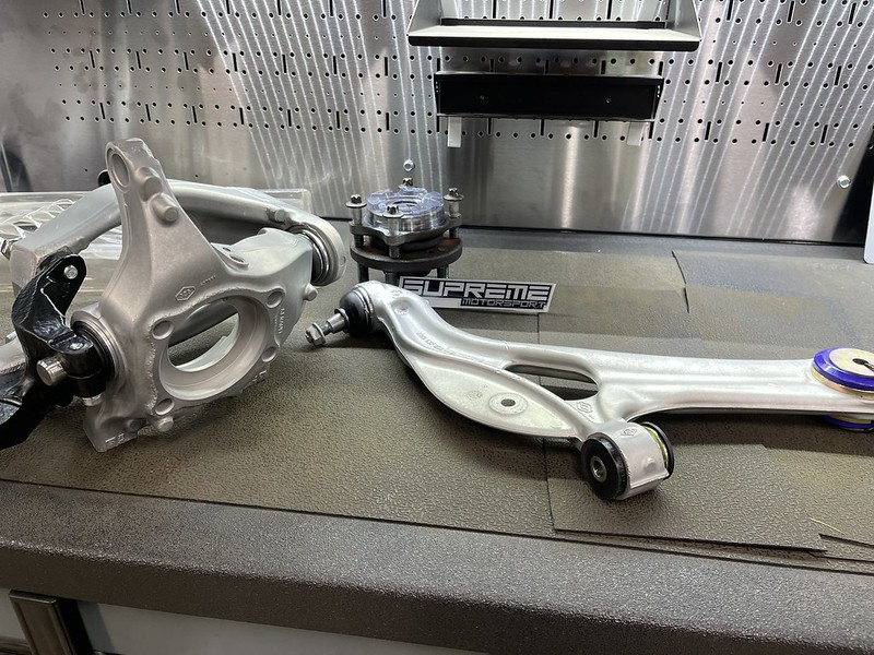

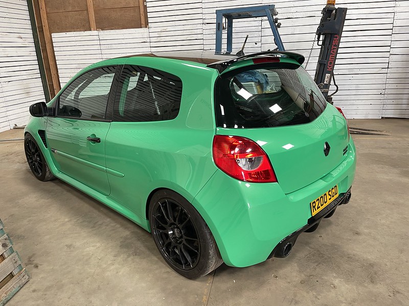

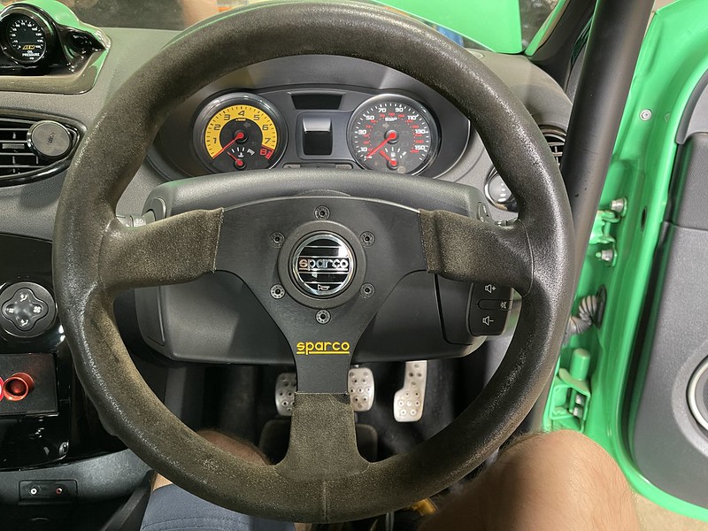

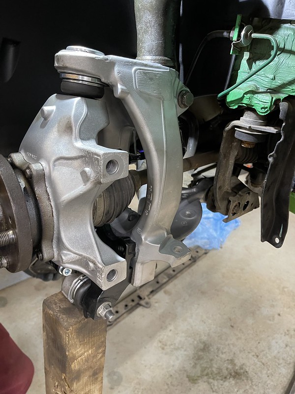

We did things like new gearbox oil, new mud guards, cleaned the steering wheel. Went to it today for a MOT tommorow and the bottom ball joint is knocking. So its currently back on the ramp having it all stripped down to send to Supreme Motorsport for their uprated ball joints on both sides, I will also replace the drop links and rotation links at the same time and probably the front wheel bearings

Frustrating as i had it booked it for a full alightment on the 31st

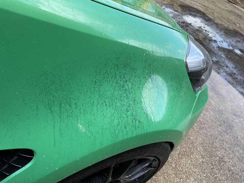

I also managed to give it a wash and a quick machine polish, amazing how much iron contaminants was on the car too

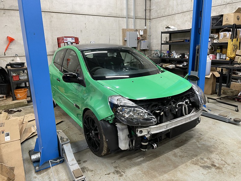

So I booked a MOT for this and noticed a slight knock on the steering.... back into the blooming workshop she went. Another quick message to Supreme and i ordered uprated bushes and arms for the car. My lads were struggling to remove the ball joints so we sent them to supreme who did some amount of decent work, aqua jetting the parts and fitting all the bits. New wheel bearings too

While its been sat on the ramp we have noticed a little coolant leak that just wets the hoses to drips, we couldn't find anything so the lads took the off and put them under a bit of pressure. The KTR coolant hoses have somehow got a few pin pricks in them which is weird, basically they have failed. I had the mot booked in so I didn't want to cancel AGAIN and i couldn't find a hose kit anywhere, i stuck a blob of glue on the pricks and wraped them with some sort of miracle tape from hellfords.

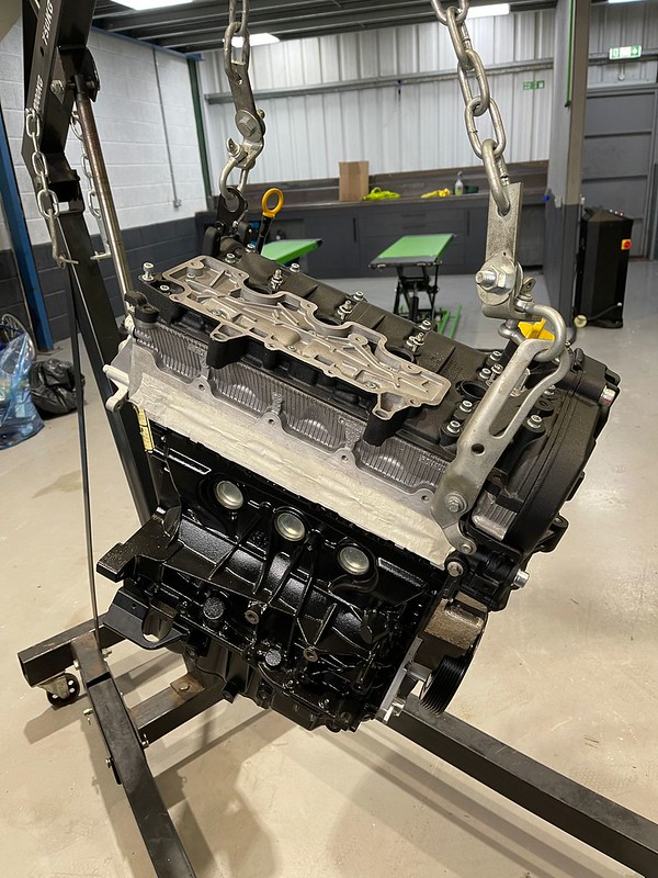

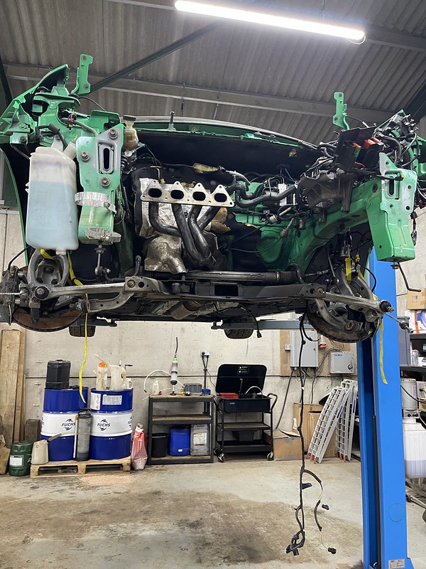

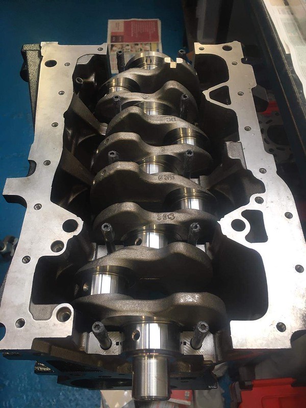

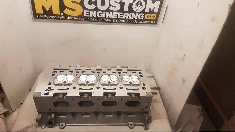

Upon looking at it we couldnt work out what was up so did a compression test. Found two cylinders low. I found a brand new forged engine for sale by Supreme motorsport who had decided to go a different way for his shop car. Its got forged rods / pistons, head work and lots of brand new nice stuff. Bought that up x mas last year. Car sat there all year untill yesterday where we had time in the workshop to strip the engine out and get this show on the road
