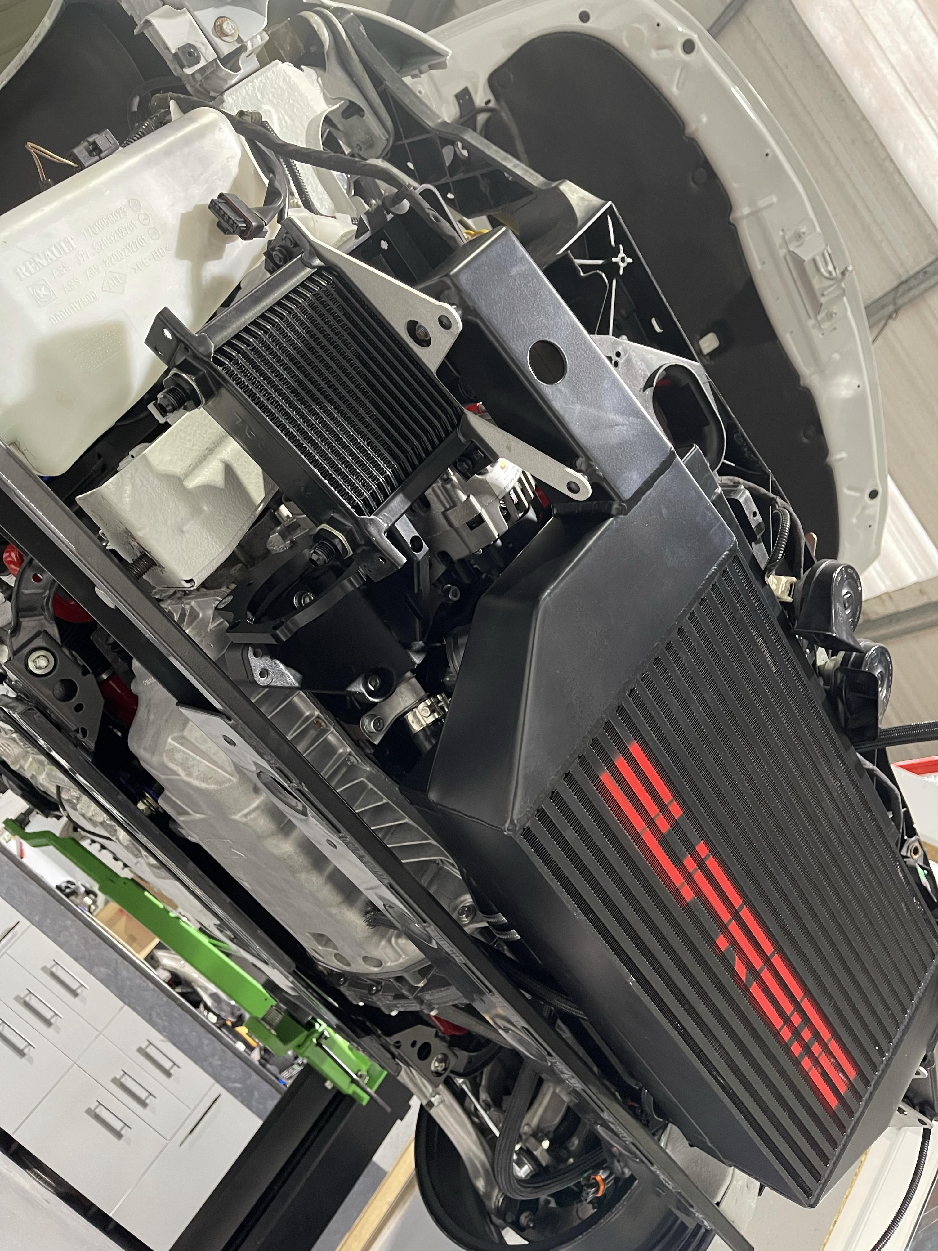

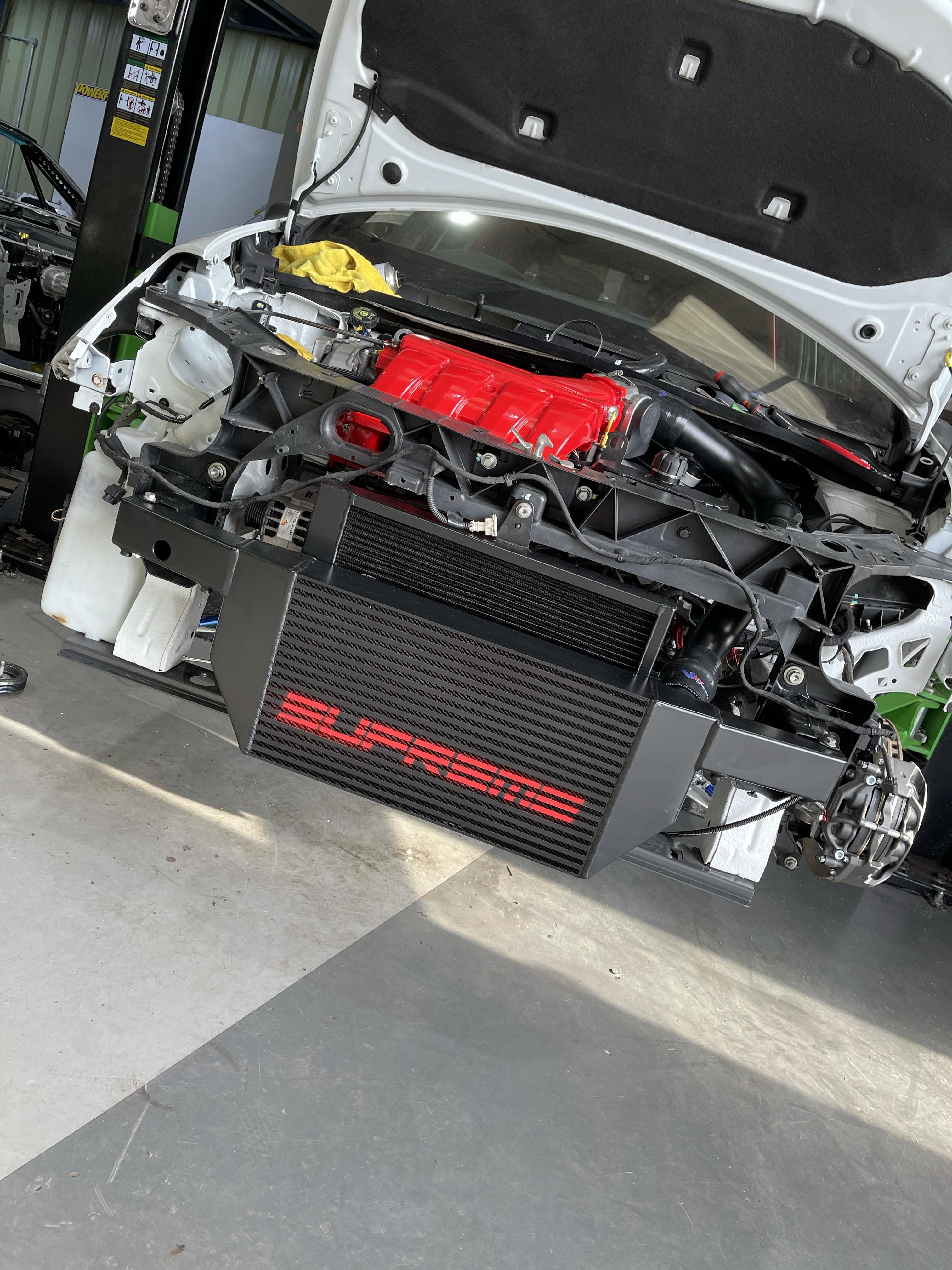

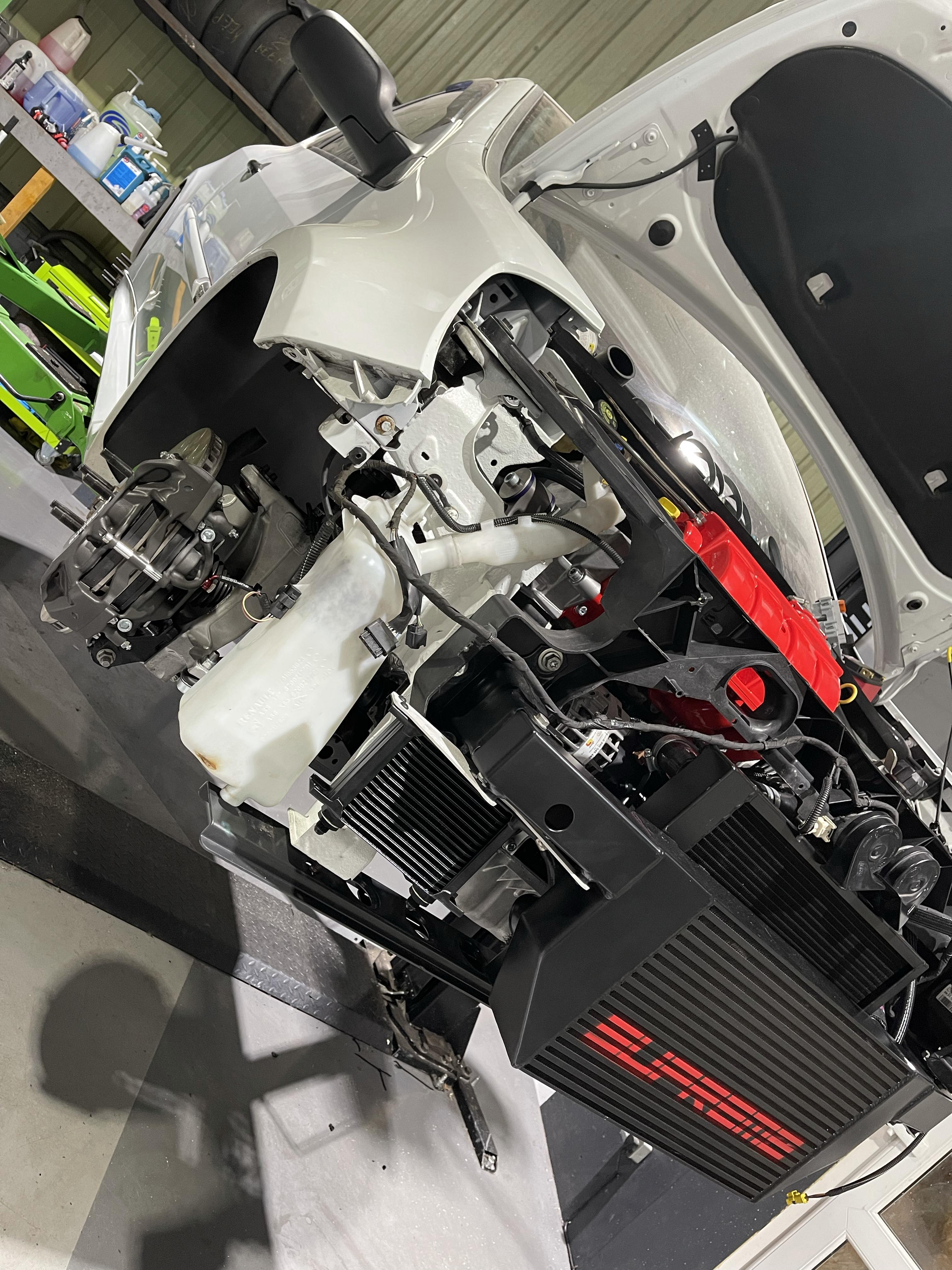

The intercooler etc is now back and powdercoat. I think it looks loads better in black.
I have some more pictures on the work camera il get them uploaded of the next week or so to show a little more in detail of the parts and what we have done.

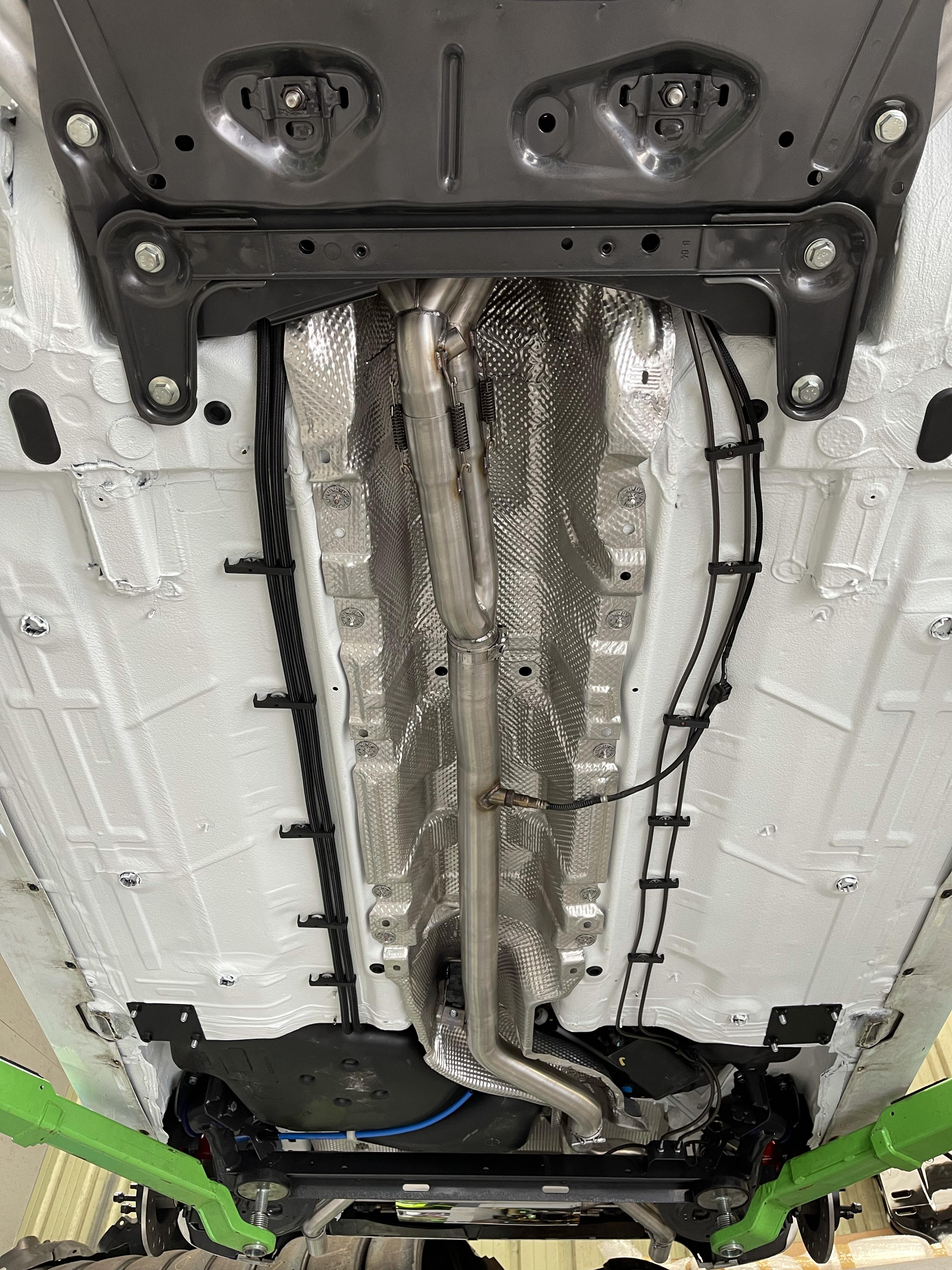

Who doesn’t live a clean underside [emoji23]

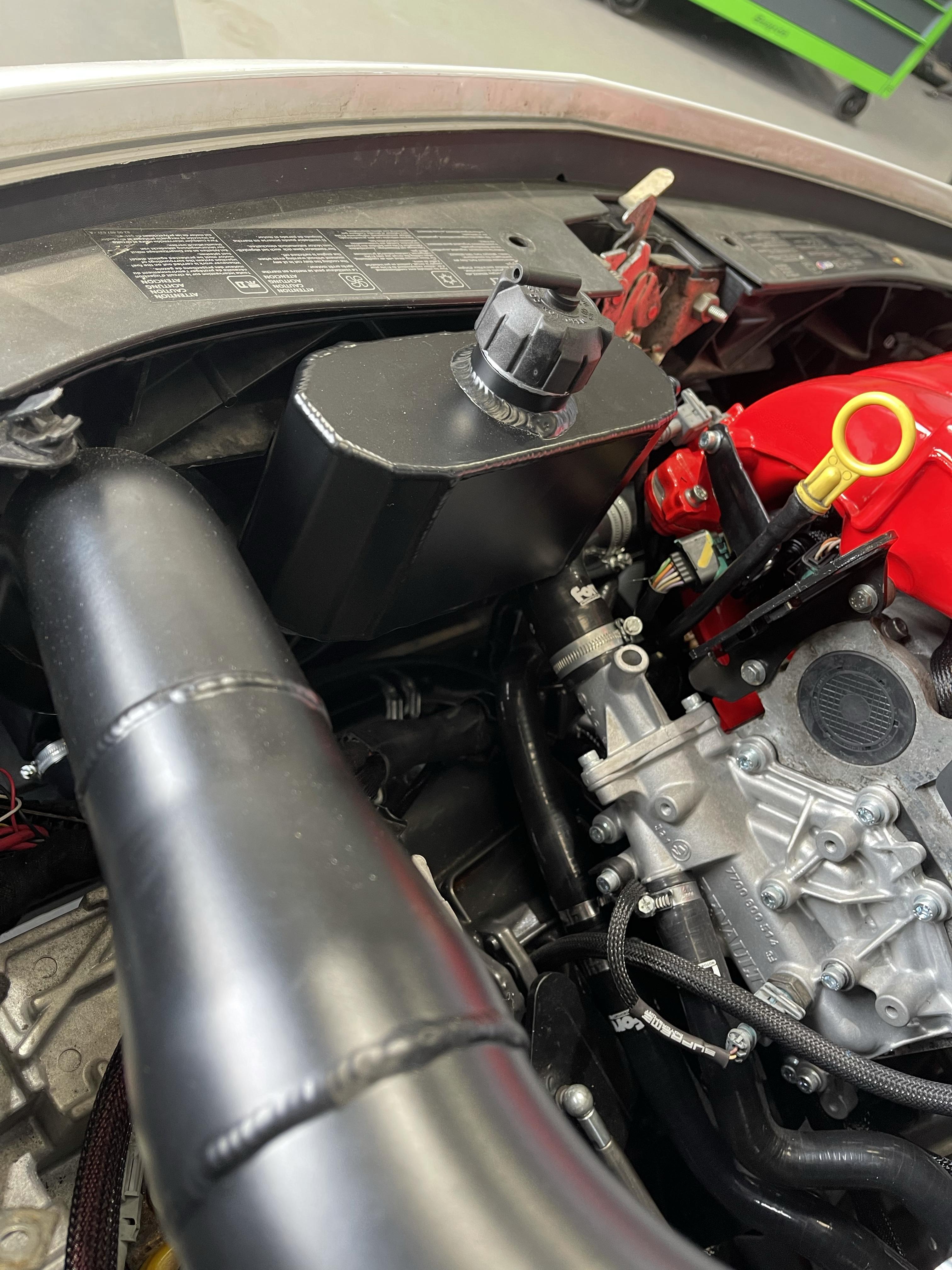

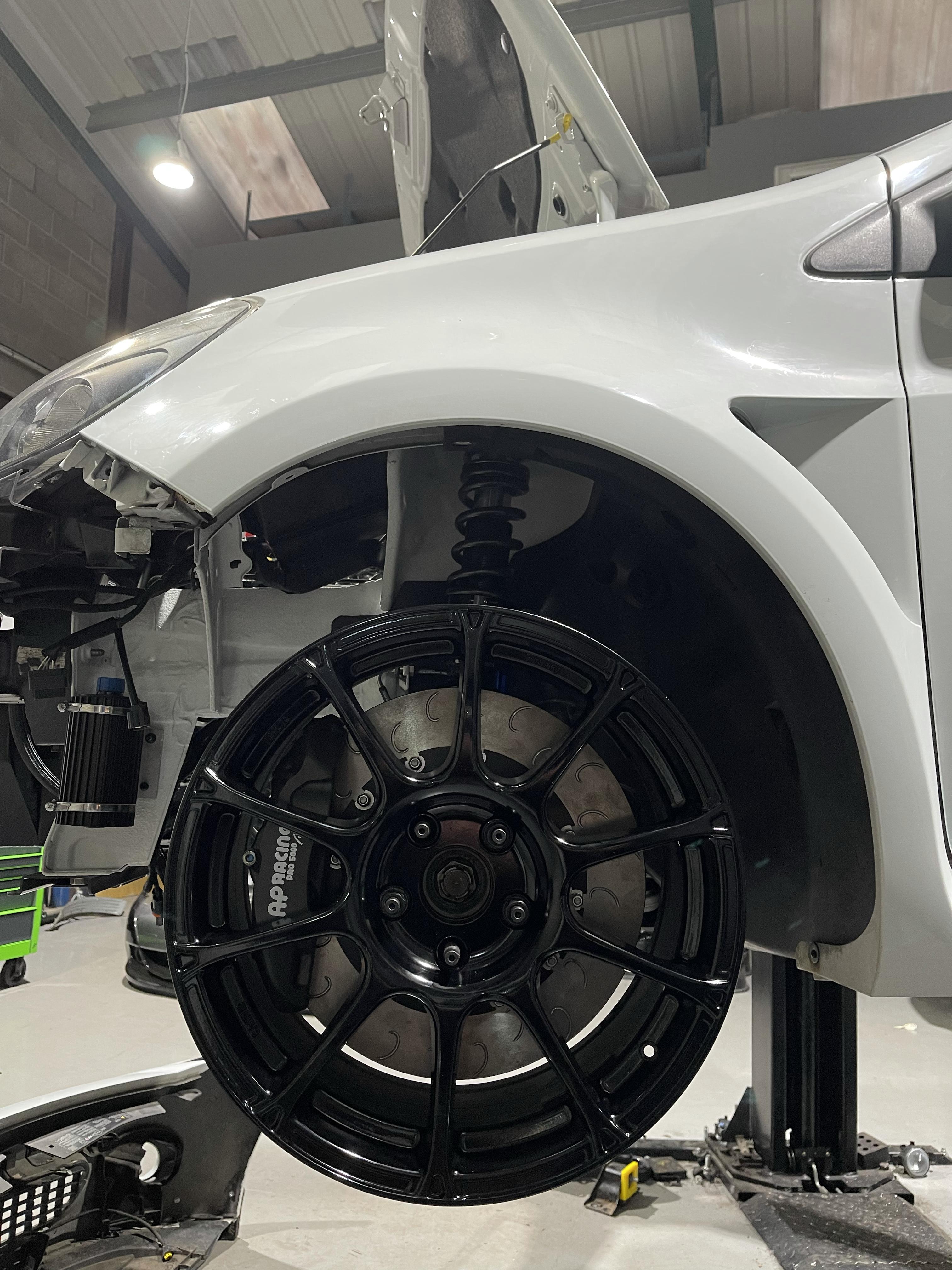

Any way back to the build I managed to get some brackets made to mount the oil reservoir for the charger. Also got the brakes all bled and test fitted the ATS gtr wheels while I was at it
Next up was to make mounts for the 2 oil coolers one for the engine oil and one for the supercharger set up. I ordered 2 mocal ones (these are my go to for oil coolers) only 1 arrived [emoji30] and the other was ok back order from mocal and with time getting close for snett they offered an “identical” Setrab cooler. Well it turns out it’s not so the laser cut mount doesn’t fit, I get another one designed over the weekend and cut next week.

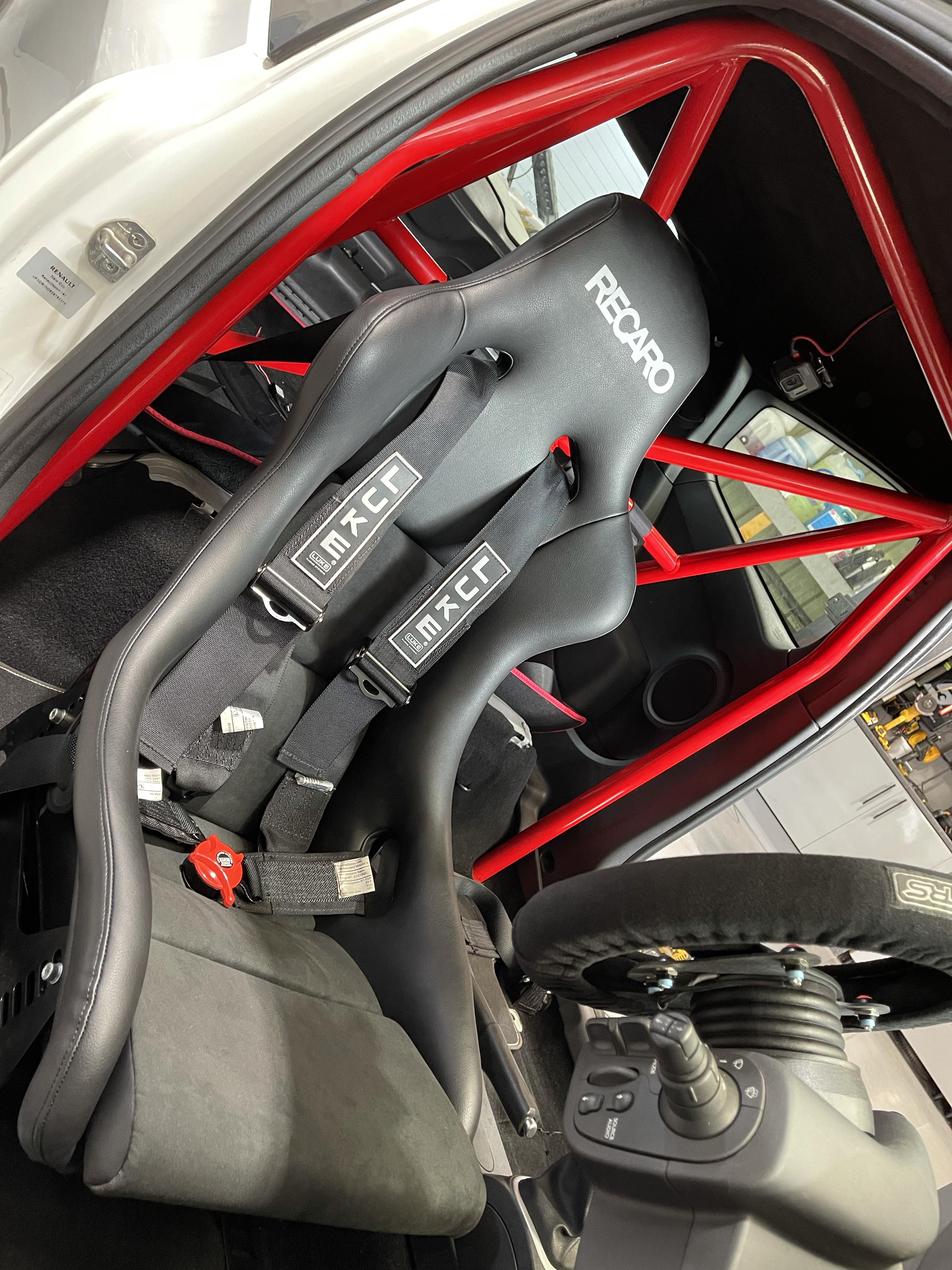

Well after what feels like forever the recaros have finally arrived.
Within 10 mins I had the first one in like a kid at Christmas [emoji23]

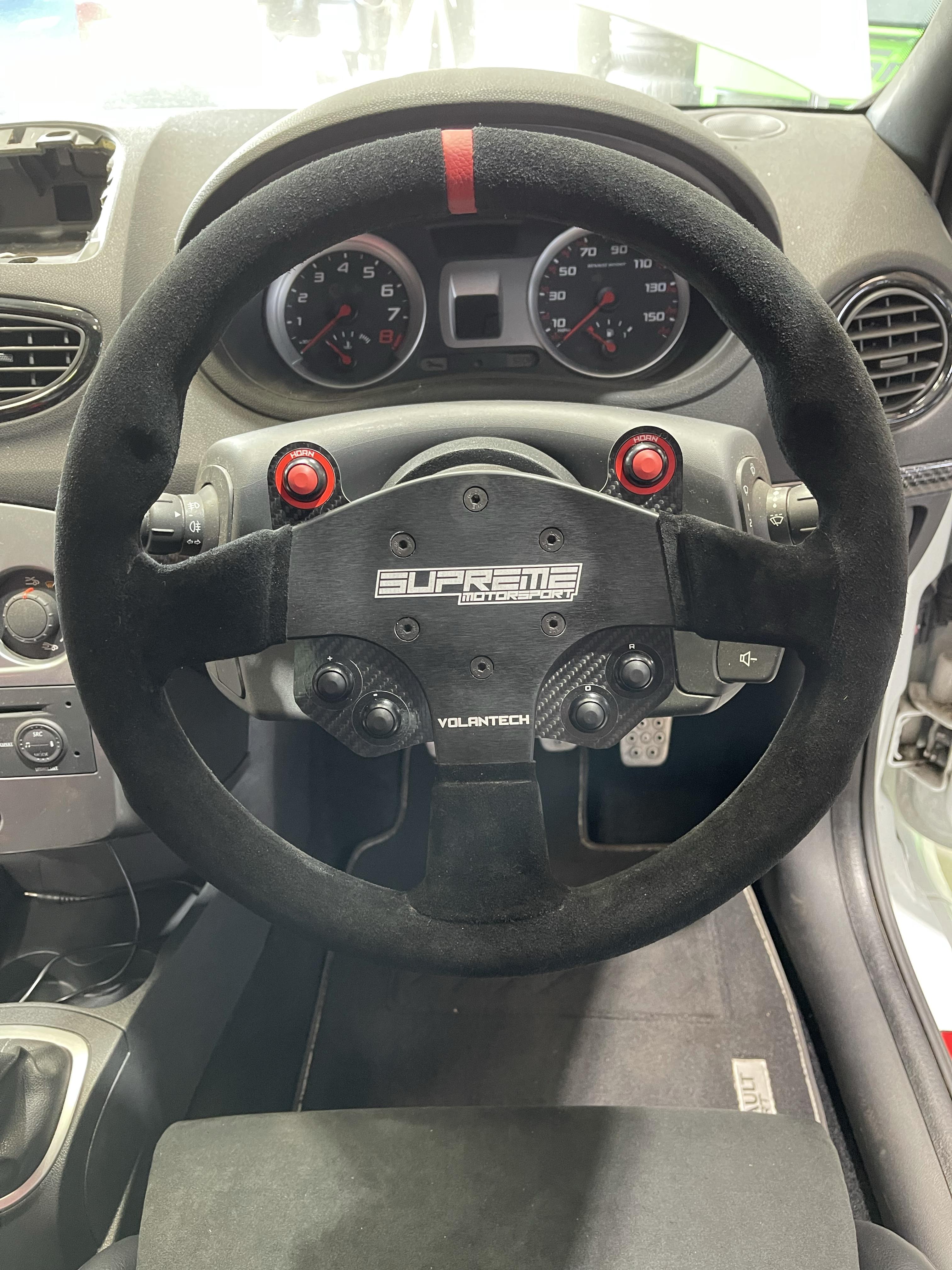

The steering wheel and buttons is also now in ans wired up.
