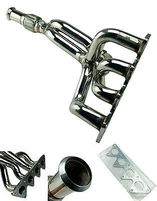

Will this fit?

Have a scorpion cat back, main cat is staying.

I think that's a Toyo manifold. They are fine for the price, but can catch the subframe. It's pretty obvious where it catches if you have a look, a good mechanic can have a chat with the subframe and cure it. This has already been said, but take the gasket that comes with the manifold and put it in the bin. No idea what it's made of or why they bother to supply it.
