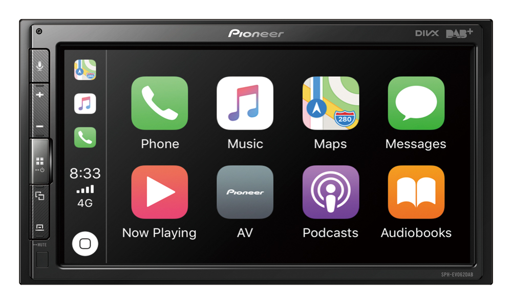

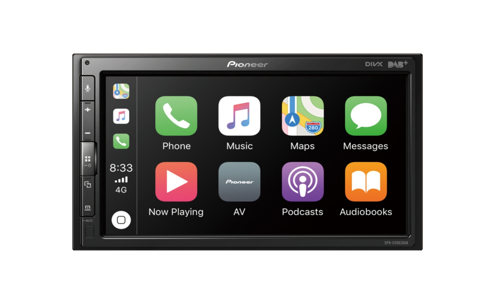

Pionner SPH-EVO62DAB - 82DAB
Anyone thought about getting it installed ? Its one of the Carplay units with a separate screen so could be somehow aesthetically installed I guess... could install the unit inside the 1din and then the screen on the top of the dashboard...
Great idea but it's way to pricey for me... You'd be better off buying a Samsung tablet or something and hooking that up to a single-din head-unit.
I have a Pioneer head-unit with DAB, BT, all the other trimmings etc and it was only £99. Essentially, I reckon I could get a shit tonne more features by connecting a tablet to my headunit via AUX/USB or BT and still spend under £200 in total, including the cost of the head unit.
If you do go for it, please make a review/video as I'd be interested in what £430 gets you. Pioneer is great quality and well known brand, so I am keen on the idea, just not the price!

Good idea, however there are really two options when it comes to double dins in the clio.
1) Modify the centre console to accept a double din unit. This would require moving the start/hazard/lock buttons and/or the climate controls. This has been done and you should be able to find pics of it on the forum/internet. If not I can try to find them.
2) Install the double din in the factory satnav housing. This also requires modification to the front panel. It's best to avoid this as the front panel curves inward slightly so if you cut it for a larger display, it doesn't look that great (unless you're a whiz with 3D printing/ABS plastic). You would also have to account for the length of the unit because if it goes too far back, you will need to extensively modify the rear panel. Getting all that wiring up there won't be easy either and would need the original loom to be extended.
This unit appears to solve the second and third issues but not the first. However there is no way of getting a unit with that screen diameter, let alone overall unit diameter/dimensions without modifying the front panel.

Thought about having it installed, the screen just on top of the middle vents and the unit inside the 1din slot,
thats the only thing the cabin was missing imo, mostly for carplay use and sofar I have not found anything similarly usable other than some cheap chinese android units of unknown quality.
If I decide to get it done, I will surely let all of you know and post pics and a little review.
@DS197 I think the unit he posted (The Pioneer H/U) is actually a single DINN that allows the screen to be mounted pretty much anywhere you want...
The idea is great because this can utilize the single-din space in the centre but then hook up to the monitor/screen where the clock is placed. Of course, some modification for where the screen would sit but this wouldn't require to much effort.
I didn't like the cost of the unit, but in all honesty £430 isn't actually terrible and the reviews on the unit are 4.5/5. Worth a punt if you're not extremely technical or have a lot of time on your hands.
Yeap, double din screen with the brains in the single din which can be mounted anywhere but there's only two ways to mount it so it looks OEM+. I've seen people mount tablets on the dash with magnets which looks totally naff but I realise not everyone is as picky as me!
