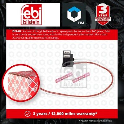

I recently replaced the right dipped beam bulb (H7), but the following day it once again stopped working...after taking a look I found that the plastic connector partially melted. I suppose that I didn't push the connector all the way in (I was really in a rush) and the bad electrical connection produced some heat...now...I've managed to have it working by replacing again the bulb and cleaning the faston terminals from the melted plastic. But, I think it's a really good idea to actually replace the entire connector...the question is: how can I find a replacement? I couldn't find the part number, and generic searches on the web only produce generic results.
I guess my best bet would be a scrapyard, but maybe someone has an idea?
There is clips like that on eBay,did you have a look already? If you mean the little metal clip that swings to secure the connector.
