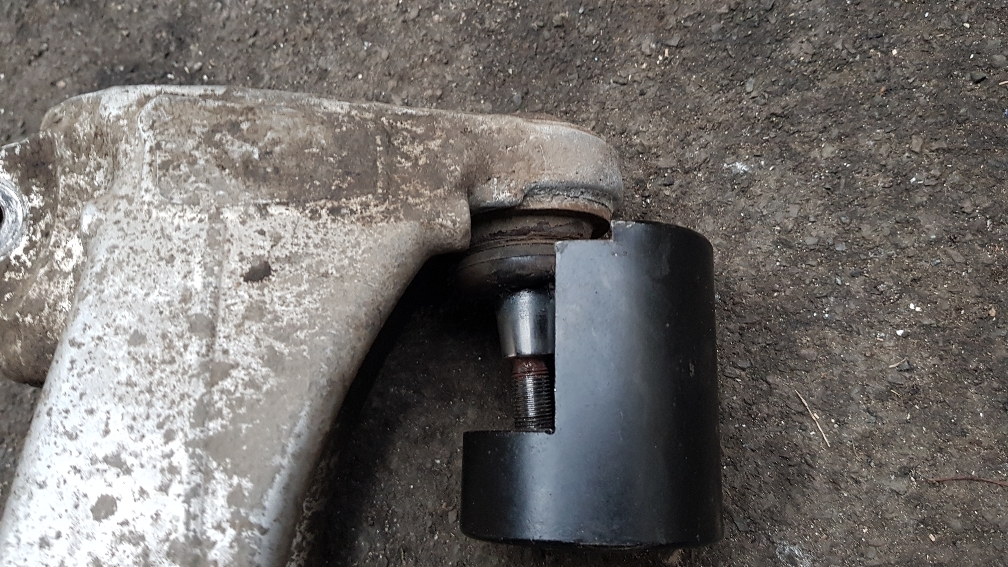

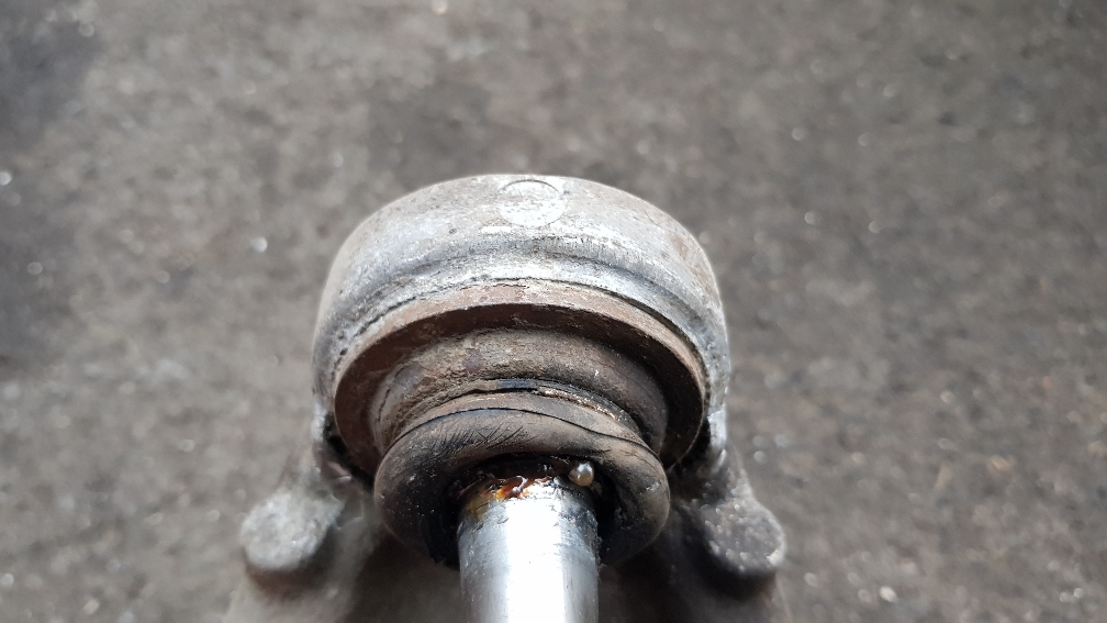

I've been attempting to do my passenger side ball joints on my 197 but I've been struggling to removing the upper ball joint
Has anyone got any advice on pressing the old one out?
The aluminium casting is such an odd shape I can't get any attachments to sit properly on it

I've removed the clip but the press keeps slipping off as theres hardly any room for the attachments of the press to sit on

I've never done an upper one, but I know when I did the lower ones I had to fab up some spacers etc. I'd imagine for the top ones you'd want a piece of tube with a half moon cut out at the top, something like this...
p.s. Have you thought about spinning it upside down, put a spacer underneath the ball joint and drive the hub down? Just be careful where you press...

I have this attachment that I've cut a couple grooves out of but the lip around the edge is so small and sloped it just slips off
Didn't really think about pressing the hub instead of the ball joint so I might give it a go. But as you said just need to be careful where I press it

You need heat to help I used a piece of Miltek mid-section pipe cut at a small angle to compensate and get the top of the hub level in the press and the pipe was what the assembly stood on so you pressing the ball joint against the tube. The exhaust pipe is 2.5 inch but I think its external dia and the wall is so thin it is just big enough for the collar of the ball joint to pass through so can’t slip
Thank you all for your help
I managed to get one of the pipe attachments and use a lathe to make it thinner and modify it a little bit (and also smack it out a bit with a hammer)
