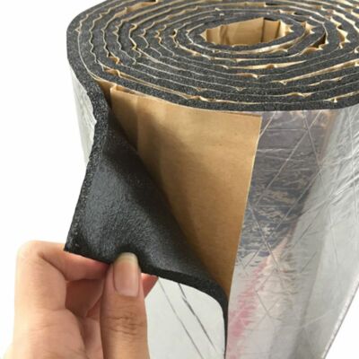

YMMV But I also bought some of this...
Now it’s not the prettiest but it should at least help with stopping the washer fluid just pouring straight out if it ever splits again.
Again this is just my cheap ass self not looking for proper insulation but it seems to be doing a good job of holding so far.
