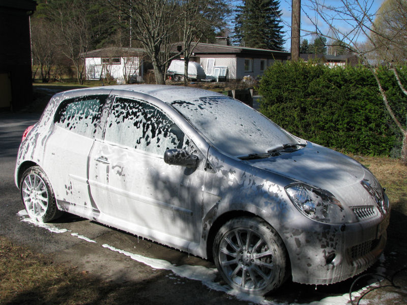

Bilt-Hamber autofoam:
http://www.youtube.com/watch?v=-UKKRGSFa9U&feature=youtu.be
full
full
full

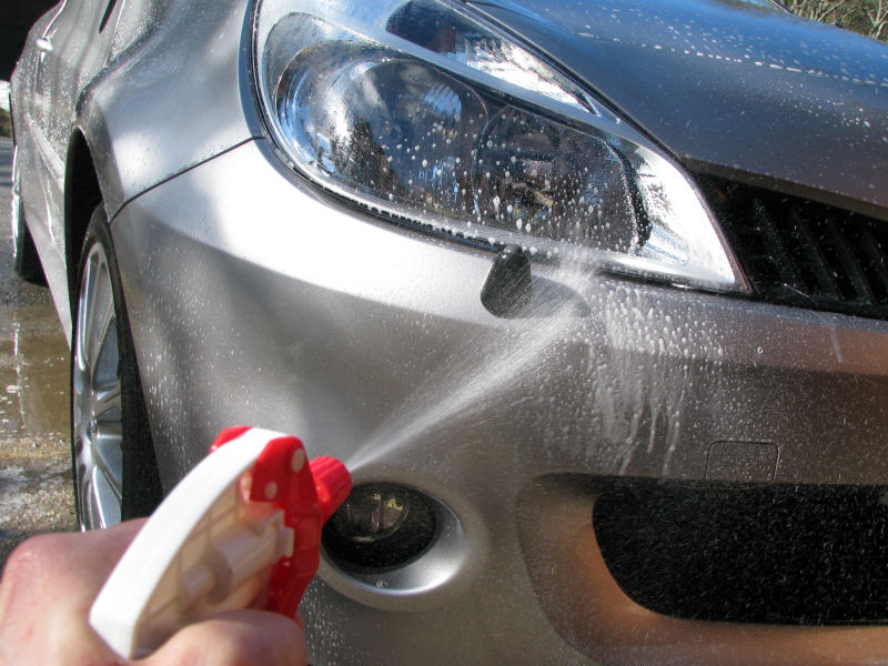

Pineline 2% wash
full

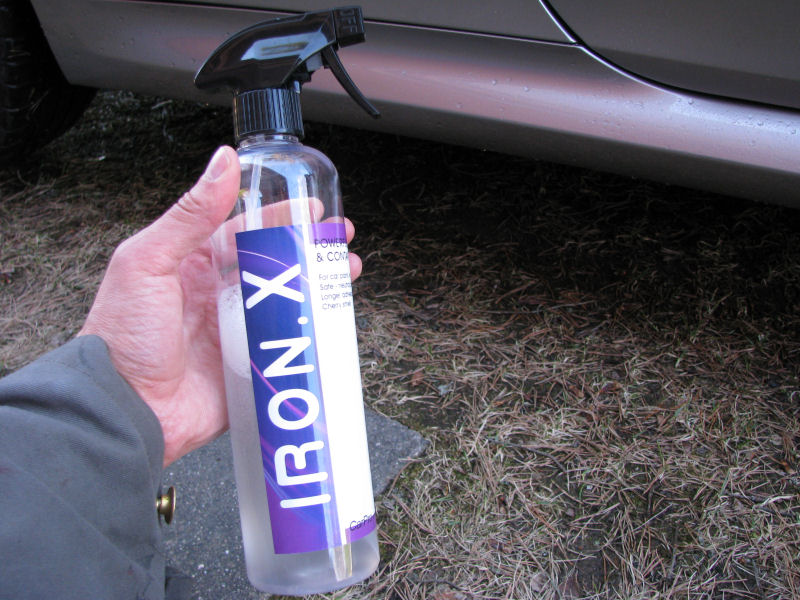

De-Iron Car Pro Iron-X
full
full
full

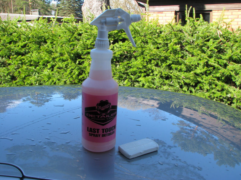

Claybar and meguairs QD
full

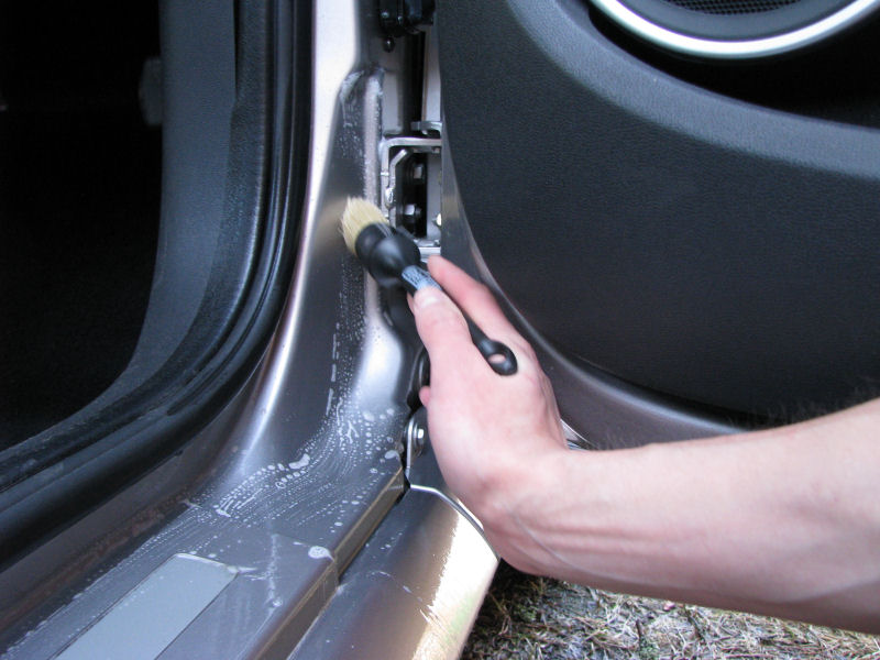

Brushing with pineline 2%
full
full

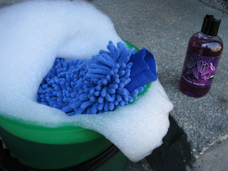

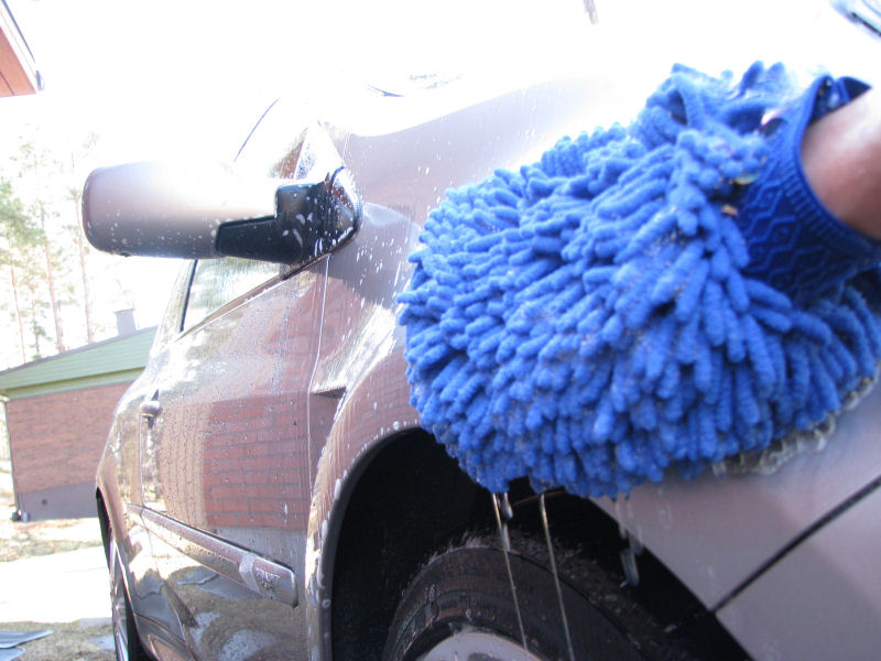

Wash with dodo btbm & wash mitt
full
full

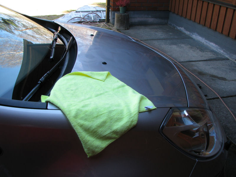

Drying and alcohol wipe
full

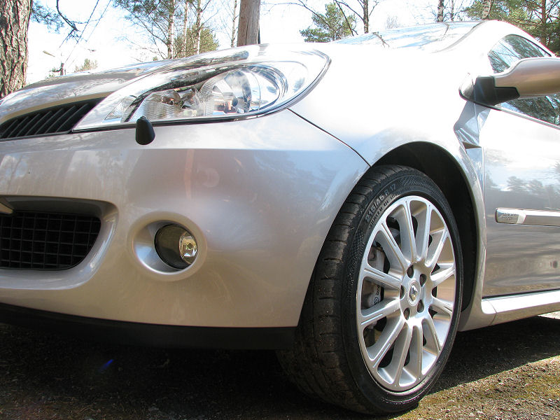

Hand wax Collinite 915
full
full

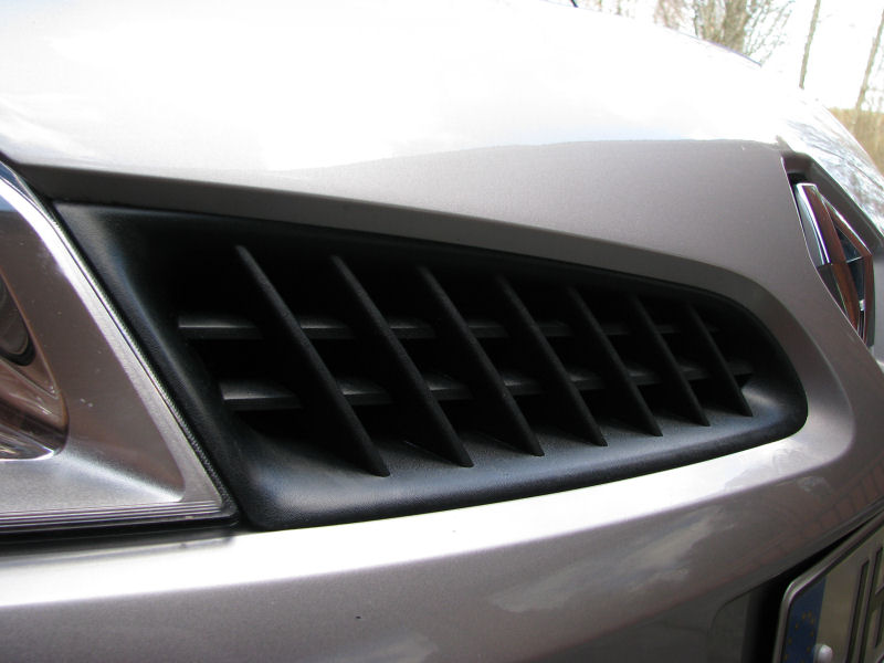

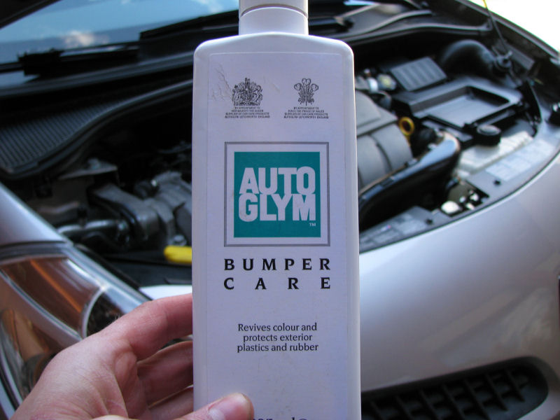

Autoglym bumper care
full
full
full
full
full
This car has been polished 2011 professionally so there was so few scratches that machine polishing was not necessary in my opinion but i am not _so_ perfectionist.
Thanks!
I try to take some showroom pictures when sun is out.. next week raining.
, that metallic paint is nice but camera is not ; )

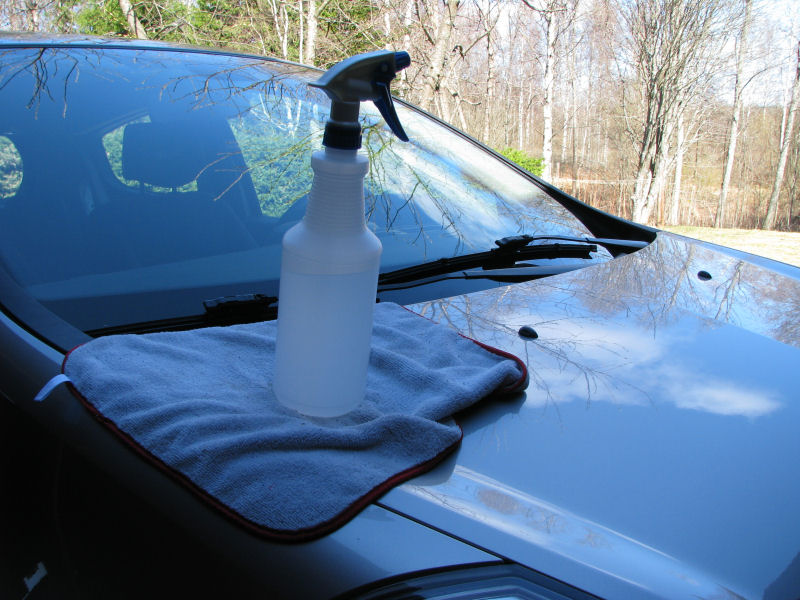

What do you use Alcohol wipes for on the outside?
First many thanks for comments, i know you UK car owners love to clean and detail cars. Unfortunately we cant say same about Finnish people here :worried:
I use isopropanol alcohol (car de-ice fluid) which is 98% isopropanol alcohol.
I use mixture of 40% isopropanol and 60% is distilled water (battery water).
Then i spray it to panel and wipe it off with microfiber towel. It degreases all unecessary greases before applying wax.
