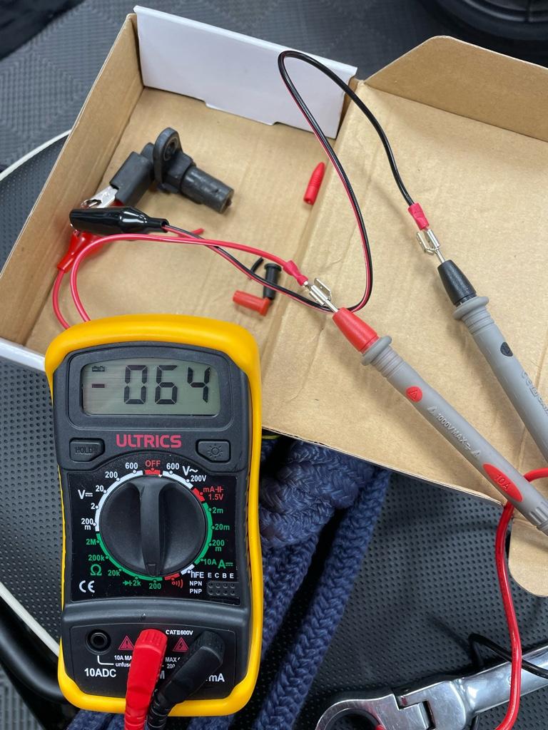

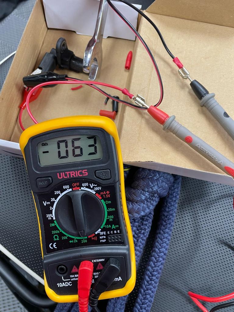

Next step is to investigate the TDC crank sensor. I believe there are two part numbers so I’m going to remove the one that’s there and make sure I order the right one from RPD. Is there any way of me somehow checking the performance of the sensor that I take out other than a visual inspection?
Check the loom connector at the other side its the loom for the injectors and coils you might have fuel but the injectors my not be firing or coils not doing there job. I have a cam and the gearbox sensor I would check the gearbox one for contamination or damage I'll look and see about testing but the gearbox one is magnetic so resistance test while moving the a spanner near the end should so a response. A faulty gearbox sensor can stall at idle
Thank you, first up was to test the resistance across the sensor once removed from the car. It was a bit fiddly to get alligator clips on the small terminals but I just about managed it.
First pic, without spanner near the end, second pic with a spanner magnetically attached to the end of the sensor.
No change, which I’m hoping is a good sign (duff sensor)?
Thanks, reading that suggests just to test the sensor in isolation? If so then I think it’s pointing to a dead sensor? Going to order one tomorrow with a few other bits.
