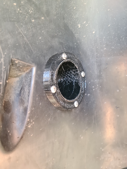

Washer bottle will be in the way regardless.
Cleanest way will be to use the 3D printed ducts in place of the fog lights themselves.
Ah the washer bottle is just one of those things you need to work around.
I’m not the only person who sells them. But I have sold some to a lad with a 200 cup with no fogs. I think he bought the none cup 200 trim pieces in order to fit them
I do sell through eBay, but can do free postage outside of their fees.

I did look at doing a version of the trim for the cup boys, but it is too large for me to fit on my machine.
I wasn’t prepared to do it out of multiple pieces either, cus they look shite.

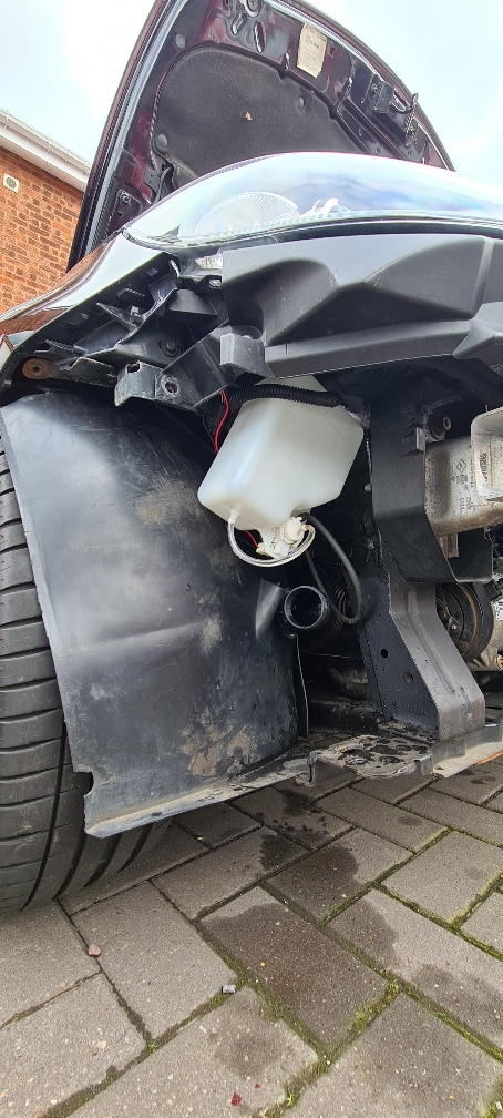

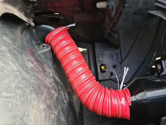

@RSRowe I assume you can still run ducting around it?
So as you can see I bodged a universal washer bottle from ebay in there and ran my duct under it

I modified the washer bottle to give make enough room to get the flexible brake ducting through. I don't have any pictures but I took the washer bottle off the car and then heated the side of it with a heat gun so I could mould a sort of dent. Worked ok and doesn't leak.
