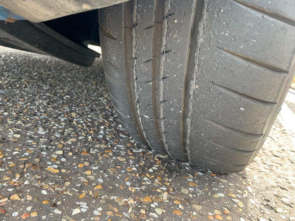

Michelin cup 2's fitted
Raised the front suspension
Fitted Front brake ducts
Seat and moubts in
Harness still to fit...but its nearly ready for its first outing now!
The cups 2s are good tyres but wear quick on track and are pricey!!
