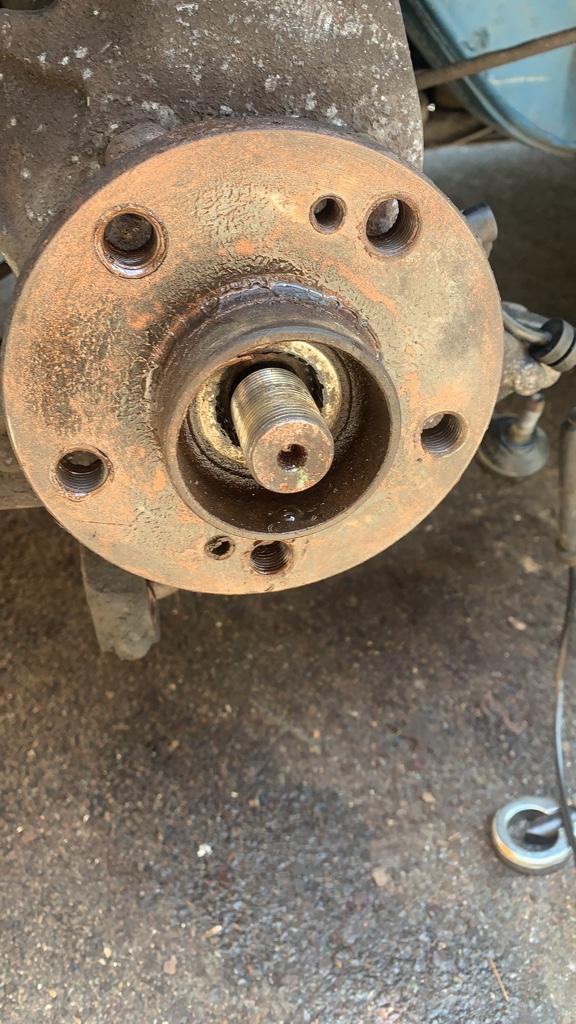

Any trick to getting these out the hub, so far every nut ive come across has been seized and a nightmare to remove. Ive hammered it and put a hub puller on it which broke within 5mins? Loosing hope on it, do they teally get this seized
Ah Clio ownership, that sounds about right... :laughing:
Yes they can be really siezed if they've never had any copper slip on the splines, what you really want is a hefty three arm bearing puller or... If all else fails a massive hammer, but you want to wind the nut on first as it'll make a right mess of the threads!

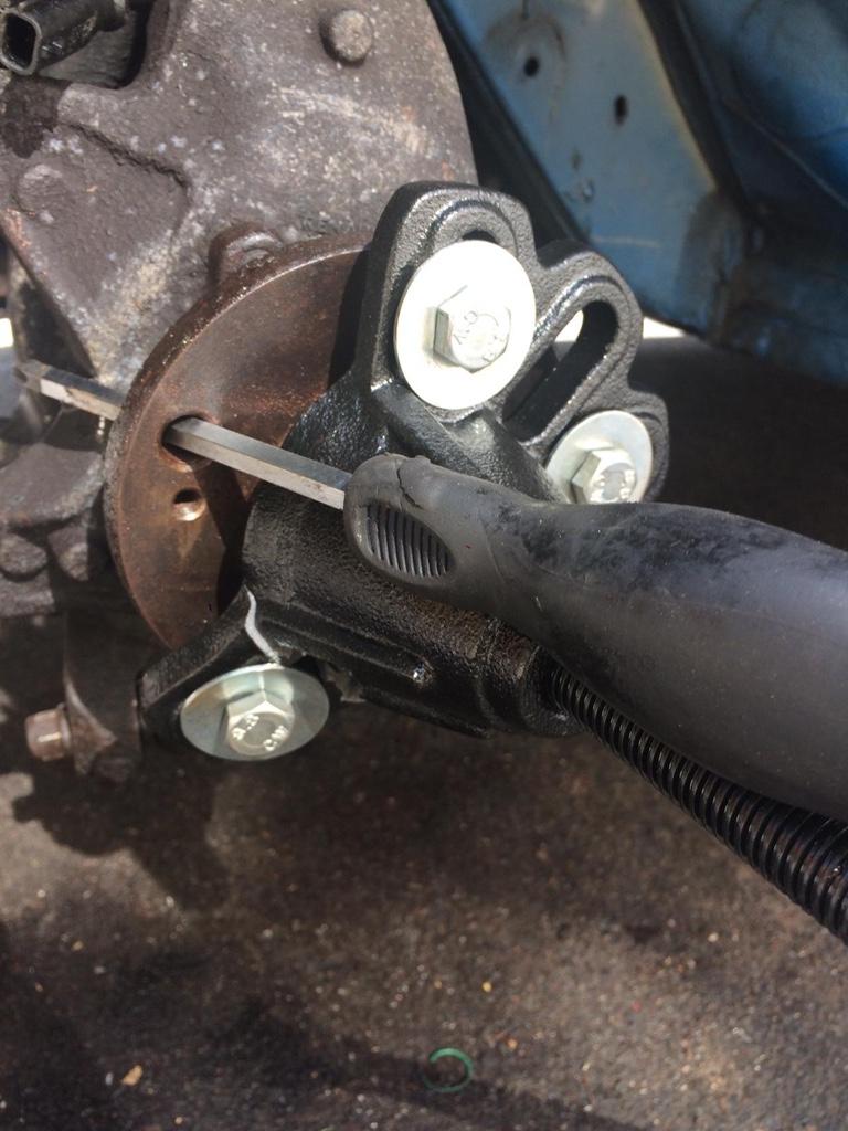

I was going to replace the shocks, but due to the driveshaft seized into the hub I had to put everything back (one entire afternoon gone for this :imp:)
So, I bought this universal puller:
Now, my fear is: is it possible to get into more trouble and end up with the hub itself removed from the bearing?? It would pull right from there...

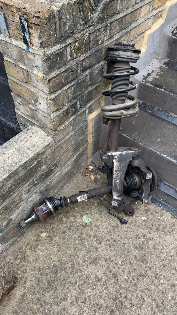

The front suspension on my car has been changed both ways. The first by leaving the driveshaft in place and taking the front damper out of the hub. The second by taking the driveshaft out of the hub and taking the front damper and the hub off of the car at the same time.
It was easier to take the hub off to change the suspension but it was possible to change it by leaving the driveshaft and hub on the car.
I have tried, but found that the driveshaft is limiting the amount of travel of the hub, and the dampers won't come out for just a couple of centimeters or so...
I suppose you had to compress the springs in place, right? Unfortunately my spring compressors don't find under there...
Yes, the springs were compressed with a set of spring compressors that we cut down to fit up closer to the top mount.
A large pry bar also helped.
Reactions: Albert540
I'm a little confused at what you're trying to do, but you don't need compressors.
Just undo the whole lot and pull it out in one big lump (top mount included)
Without compressing the spring at least a little bit, the damper bottom won't slide out of the inner hub, there's not enough movement due to the driveshaft limiting how far down you can move the hub assembly. At least this is what I've found (without forcing too much, didn't want to break anything! :chris2:)
Yep. You need to undo everything.
Balljoint, stabiliser link, drop link, track rod, abs cable, brake line, top mounts. Then pop the shaft out of the gearbox.
It will 100% come out in one big assembly.
I did the same on my Clio last time round. I split the shocker from the rest of the hub once it was out the car.
There’s also my preferred method of separating too ^
Ah well sure, removing the driveshaft from the gearbox side is the other obvious way!
