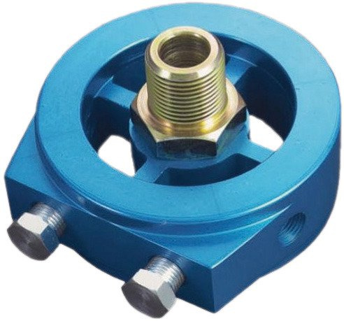

If so, for installation of an oil pressure gauge, I would need an oil filter adapter like this:
http://rspec.co.uk/gauge-sensor-ada...ealth-black-sandwich-plate-adator-m20-x-1.5mm
Can these two 'extensions' be used together or do I need to go another route? Any help would be greatly appreciated.

Mines connected to the Mocal sandwich plate for the oil cooler, it has two take offs for pressure and temp. Its quite straight forward.

Its not the OEM sandwich plate. One supplied with the oil cooler kit, has two large channels for delivery and return to the cooler and two small take offs for the sensors.
You can however use a T-piece on the pressure switch so both the original switch and the sensor can be used. You could also use a sump plug with a threaded hole in the middle for a temp sensor but will have to cut the belly pan out to accomodate it.

I have my gauges ( defi) oil pressure and oil temp connected into this:
this thing is of course connected into oil filter and is working very good

@Zadir: did you get rid of the standard OEM water cooled sandwich adapter on which the oil filter is screwed? Or do you have the oil filter sandwich adapter you show in the pic on top of the standard OEM water cooled adapter? Is this possible?
you can just use a "t" piece connector - remove the oil pressure switch - fit the t-piece and screw the switch back in and then screw in the pressure sensor or oil line

Found this on another board, it's from a Clio 172:
So it seems dual plates is possible. However I clearly like Fox'es idea much more. Plain and simple T-piece. The oil pressure sender can simply be screwed unto it.

it is a bit strange that - but the 4-way is one way of doing what you need - as a double sandwich plate will be very restrictive to fit the oil filter i would think!
