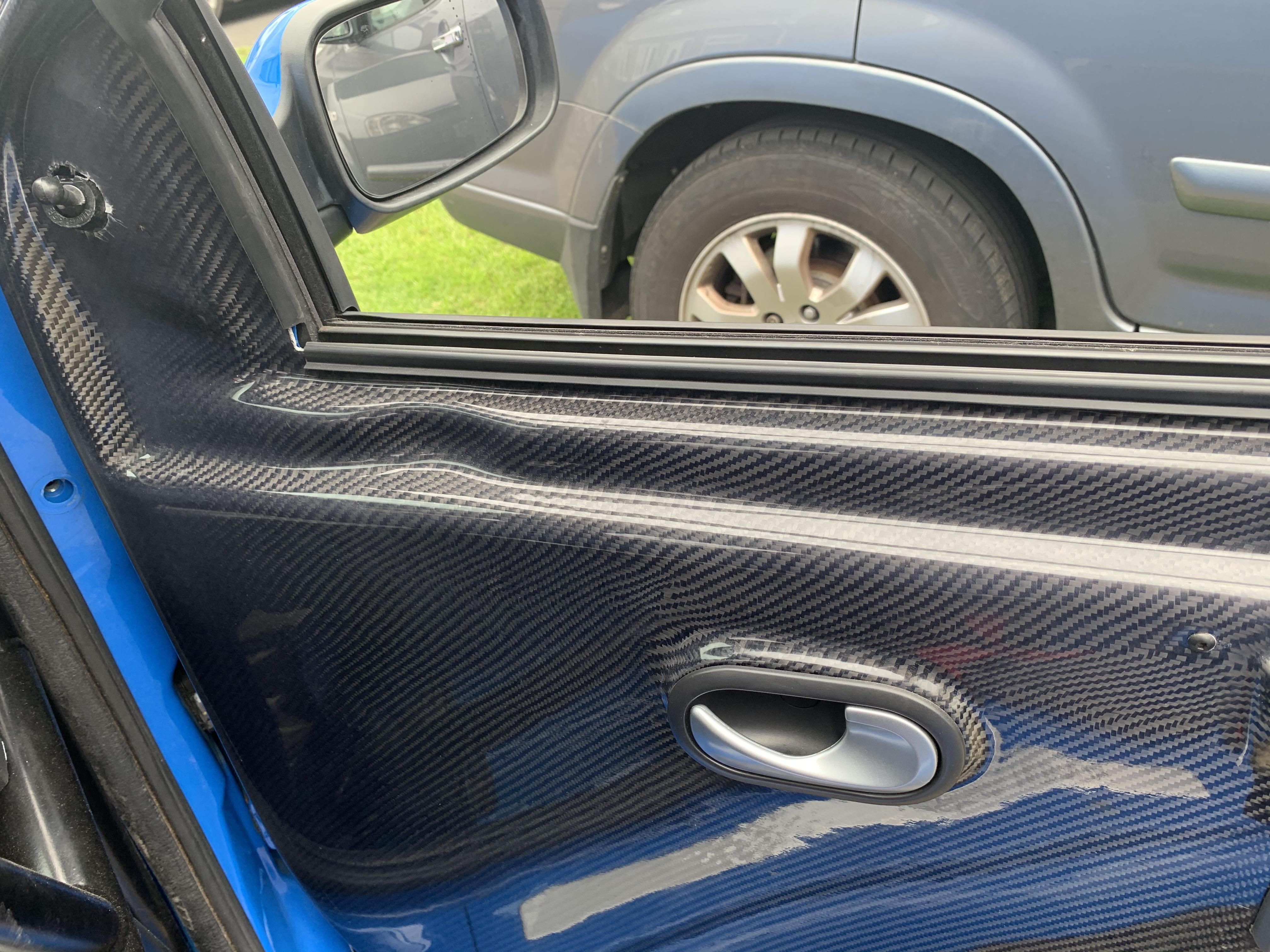

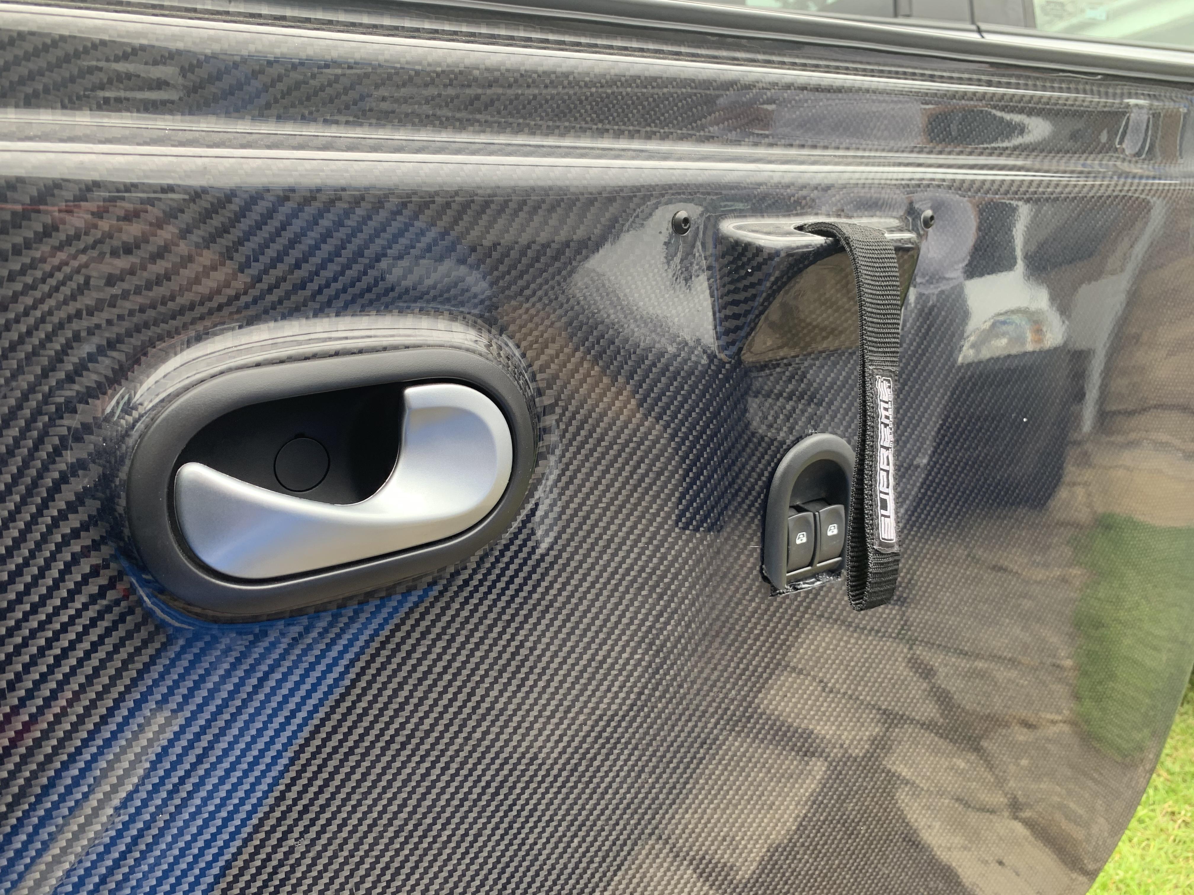

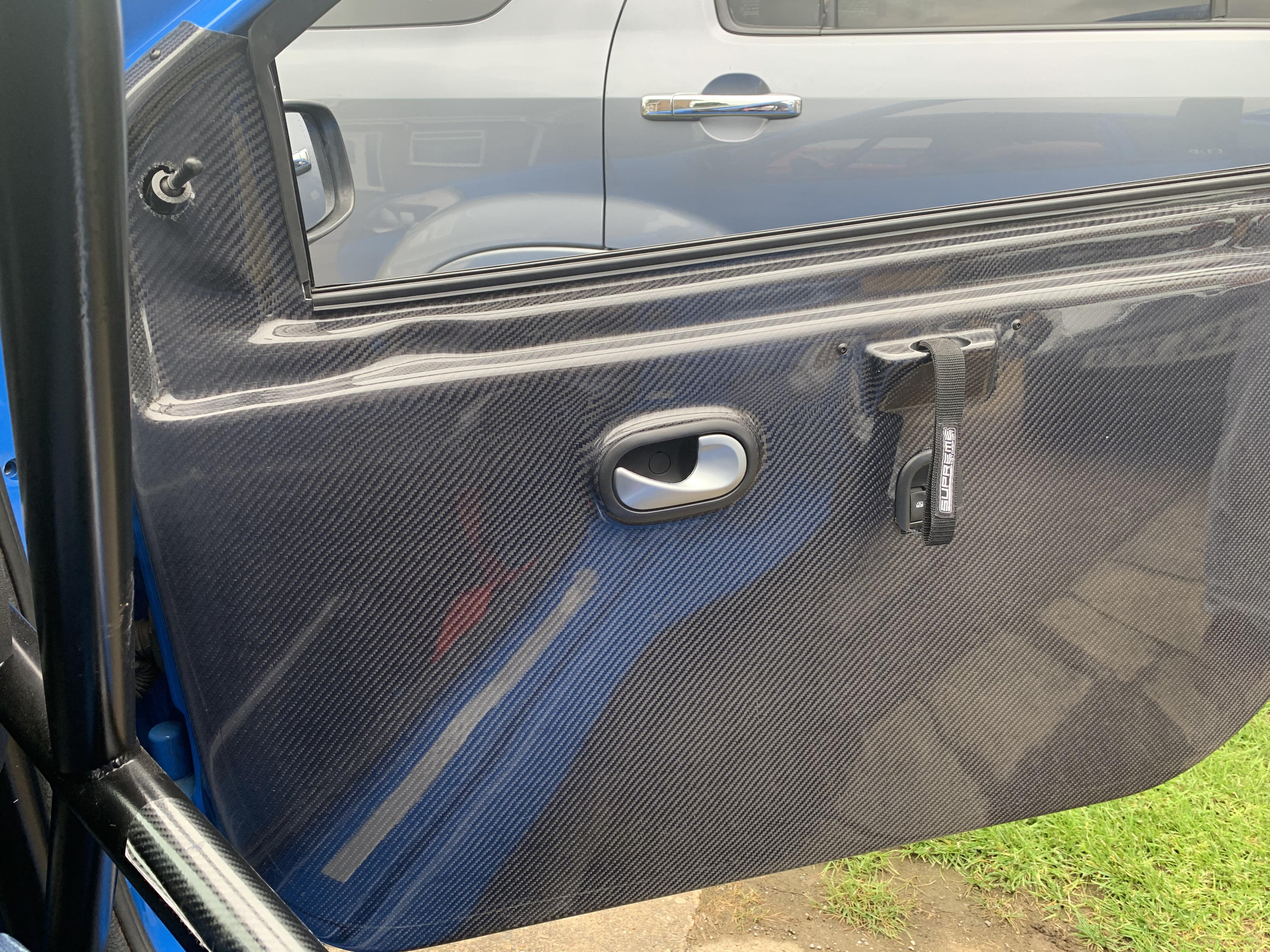

Hi was wondering how everyone else has used for the door pulls and where they have located the window switches on the maxi motor sport carbon door cards any photos would be good .

Some more pics of [mention]Beany [/mention]’s car when I went and had a poke around

excellent thanks mines also a pure cup I'm in the middle of fitting my safety devices cage ,once thats in i will be installing the door cards .
did you bolt the door pull to the inner door skin if that makes sense .
Yes, otherwise it’ll just pull the carbon cover off
