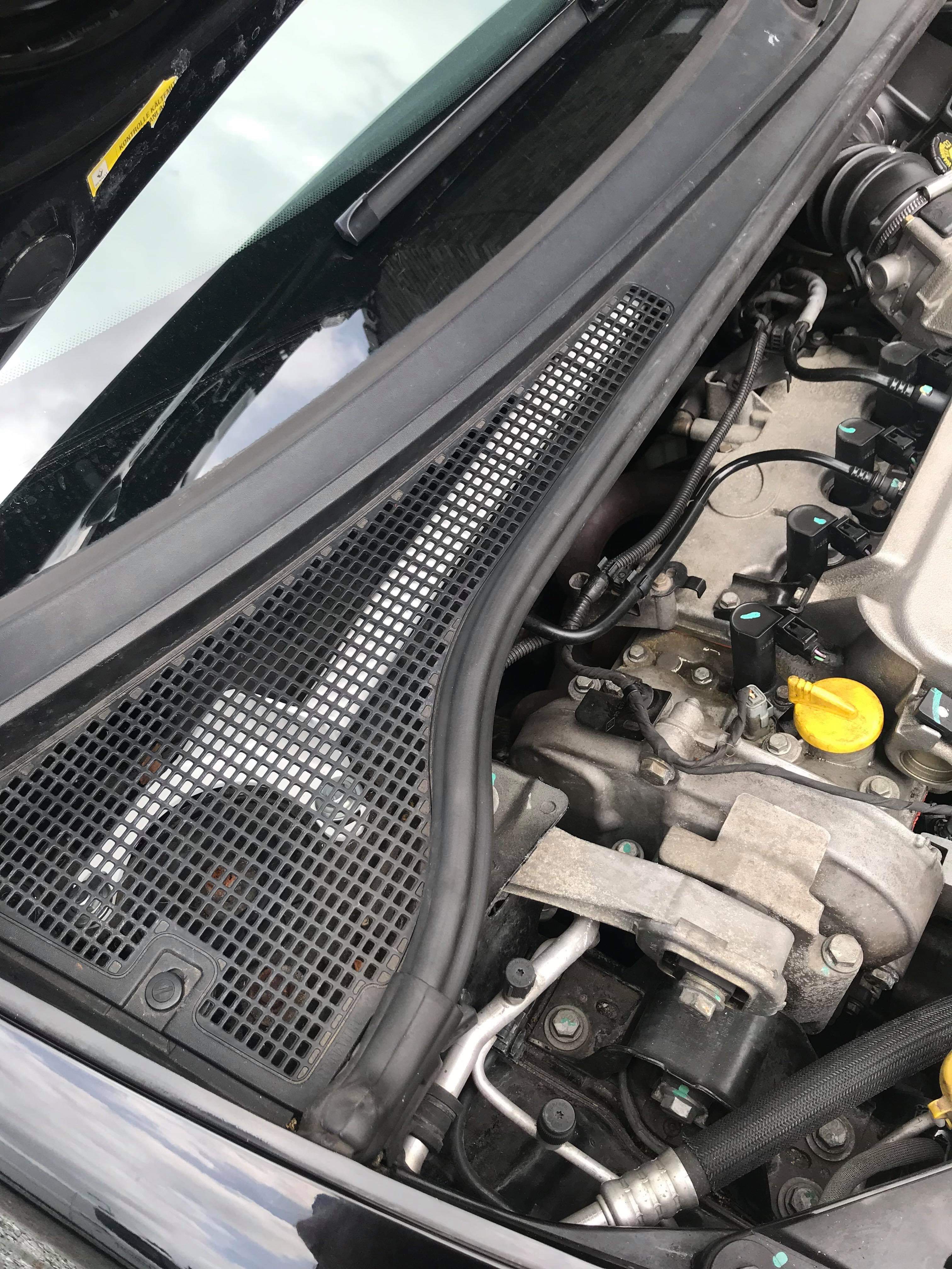

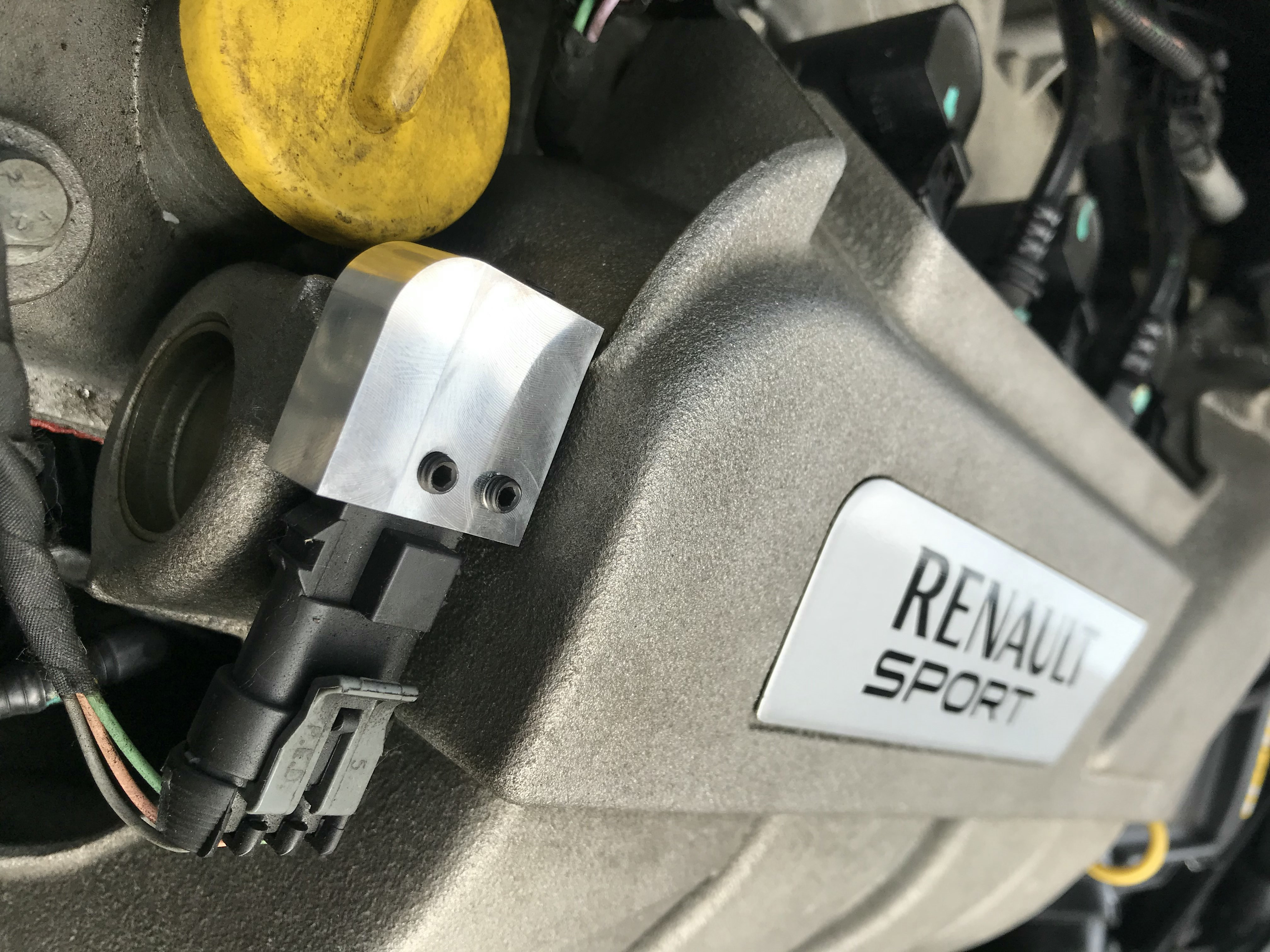

Map sensor bracket

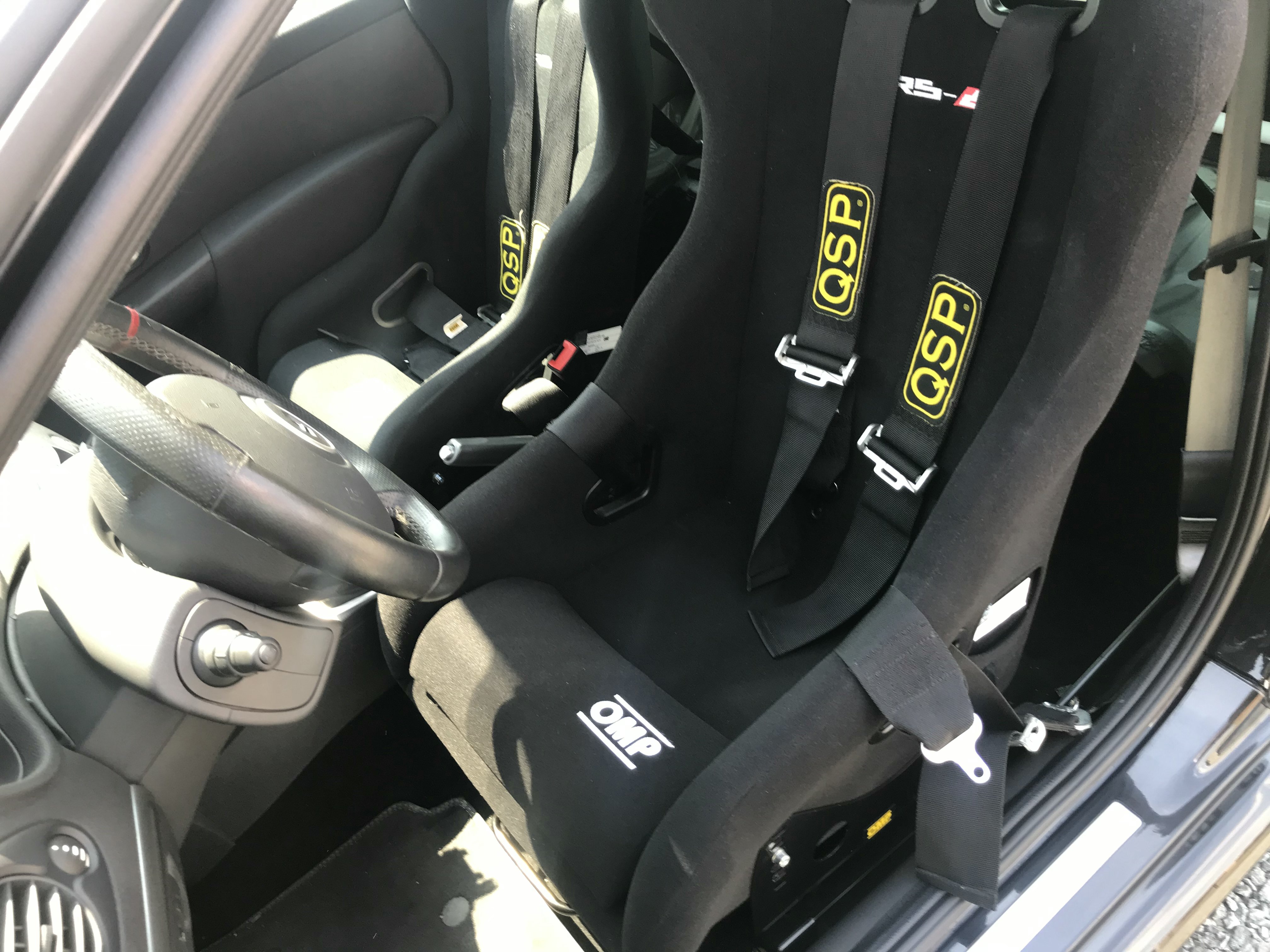

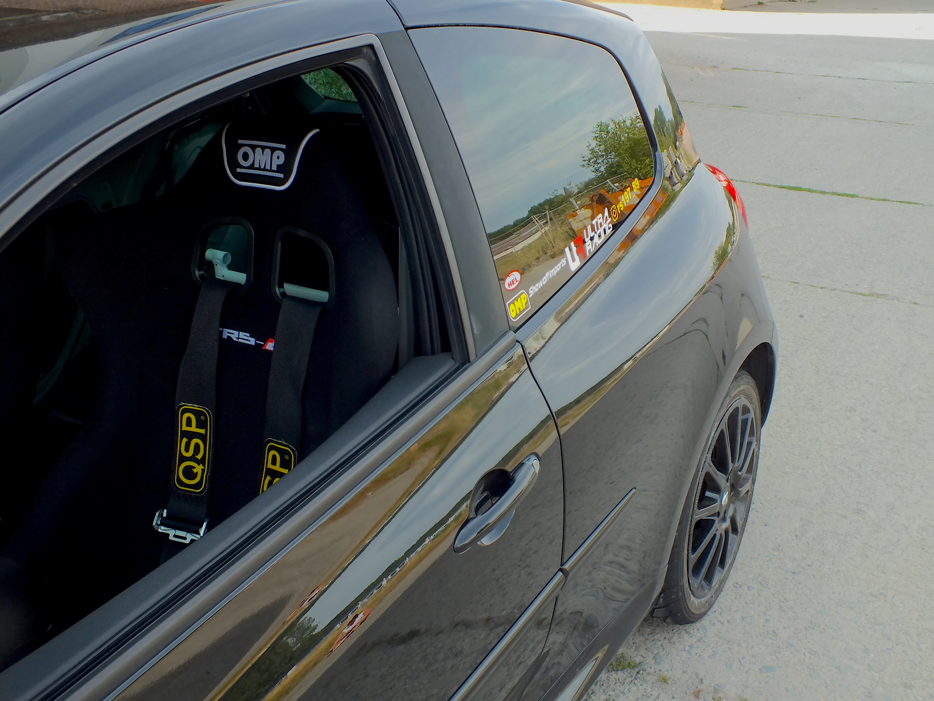

KTR seat subframes
OMP TR-S seats
QSP seatbelts

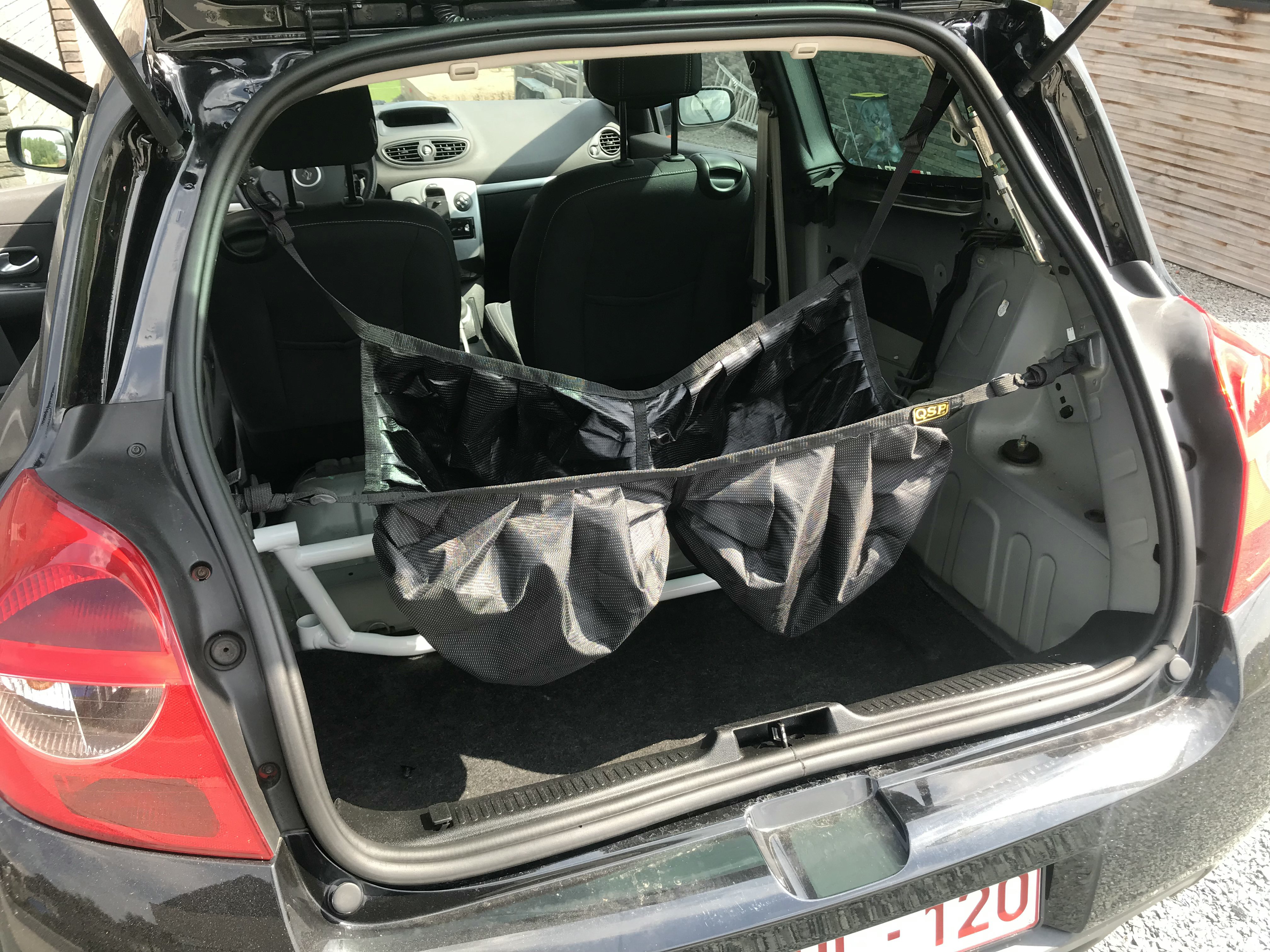

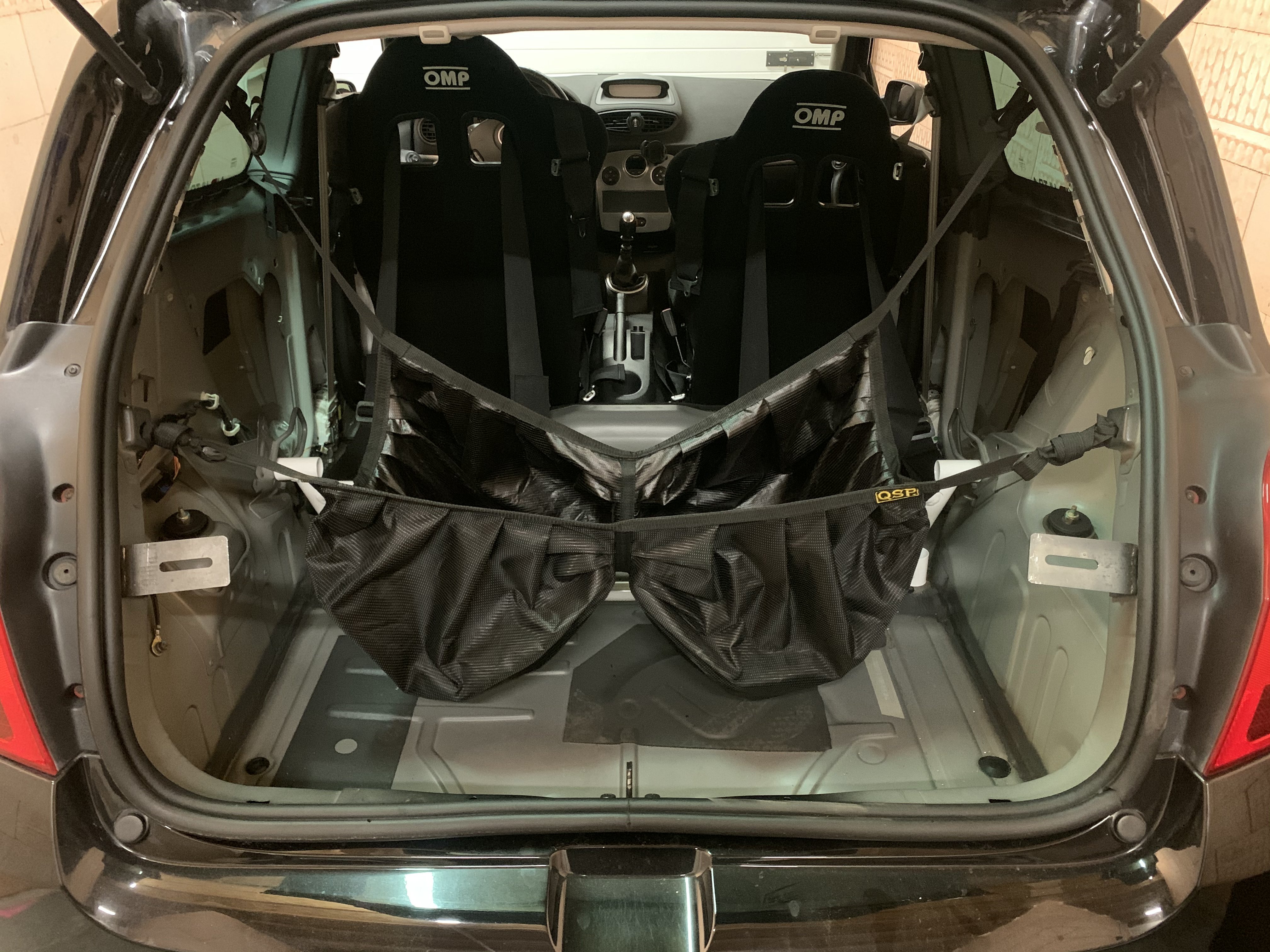

Stripped rear interior
QSP helmet net

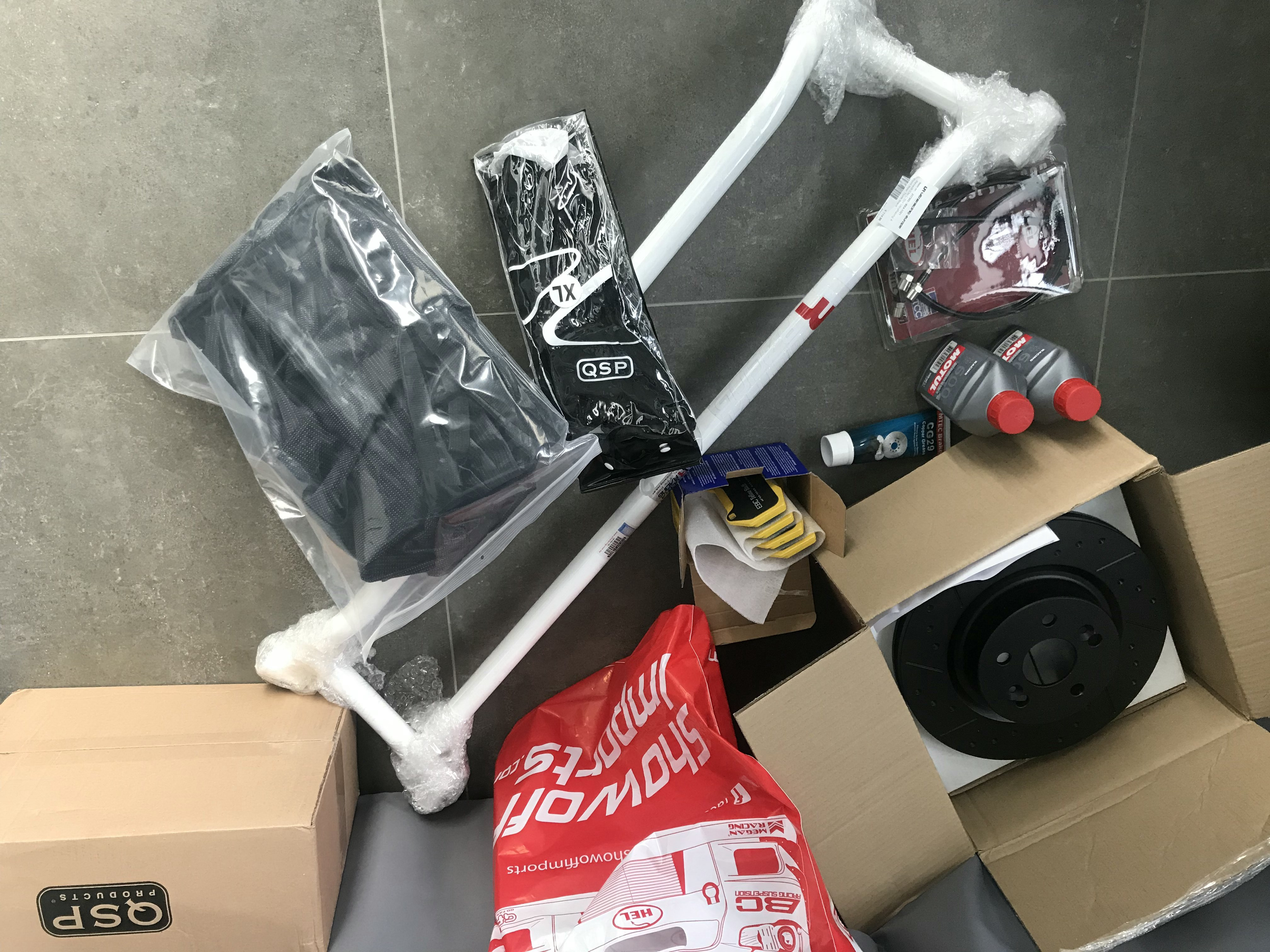

UltraRacing 2-Point Front Upper Strutbar
UltraRacing 4-Point Rear Trunk Brace
Mtec dotted & grooved front discs
EBC yellowstuff brake pads F & R
HEL braided brake lines
Motul RBF600 brake fluid

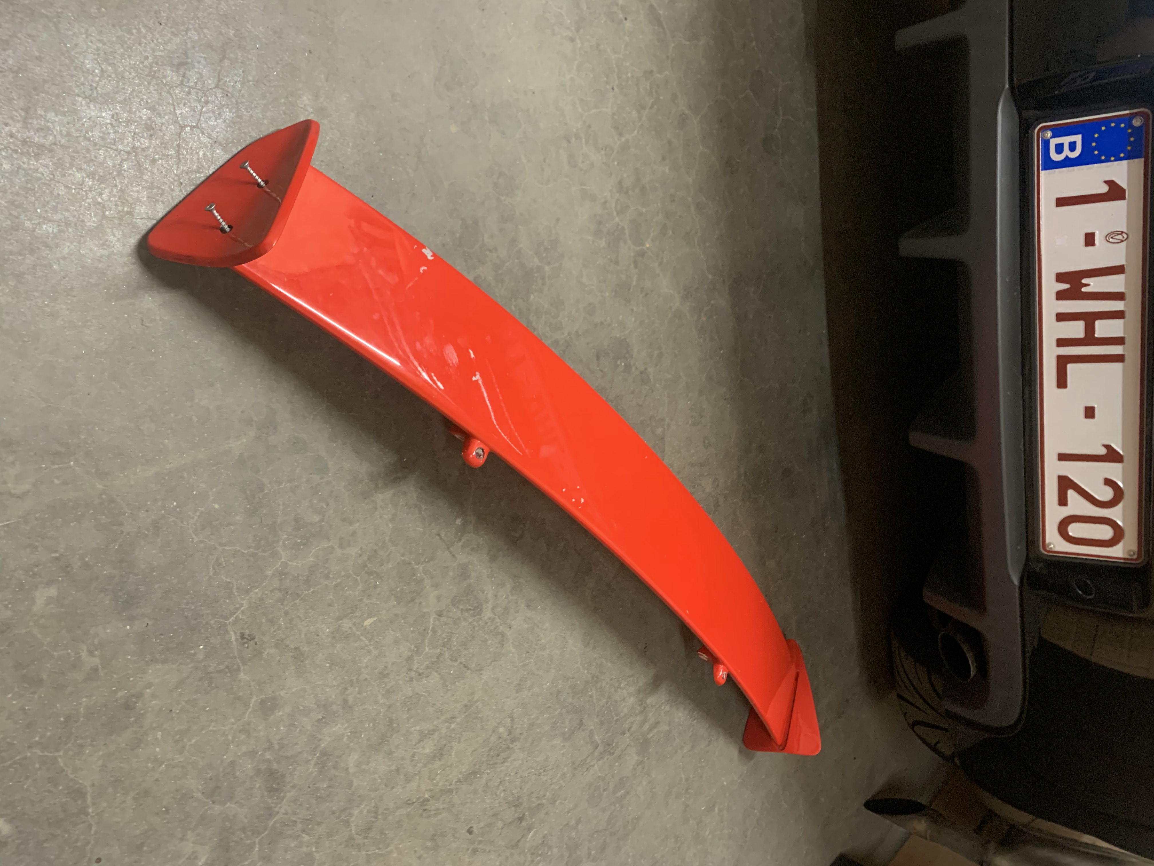

I just plastidipped the spoiler black because we probably gonna do the whole car in matte gray

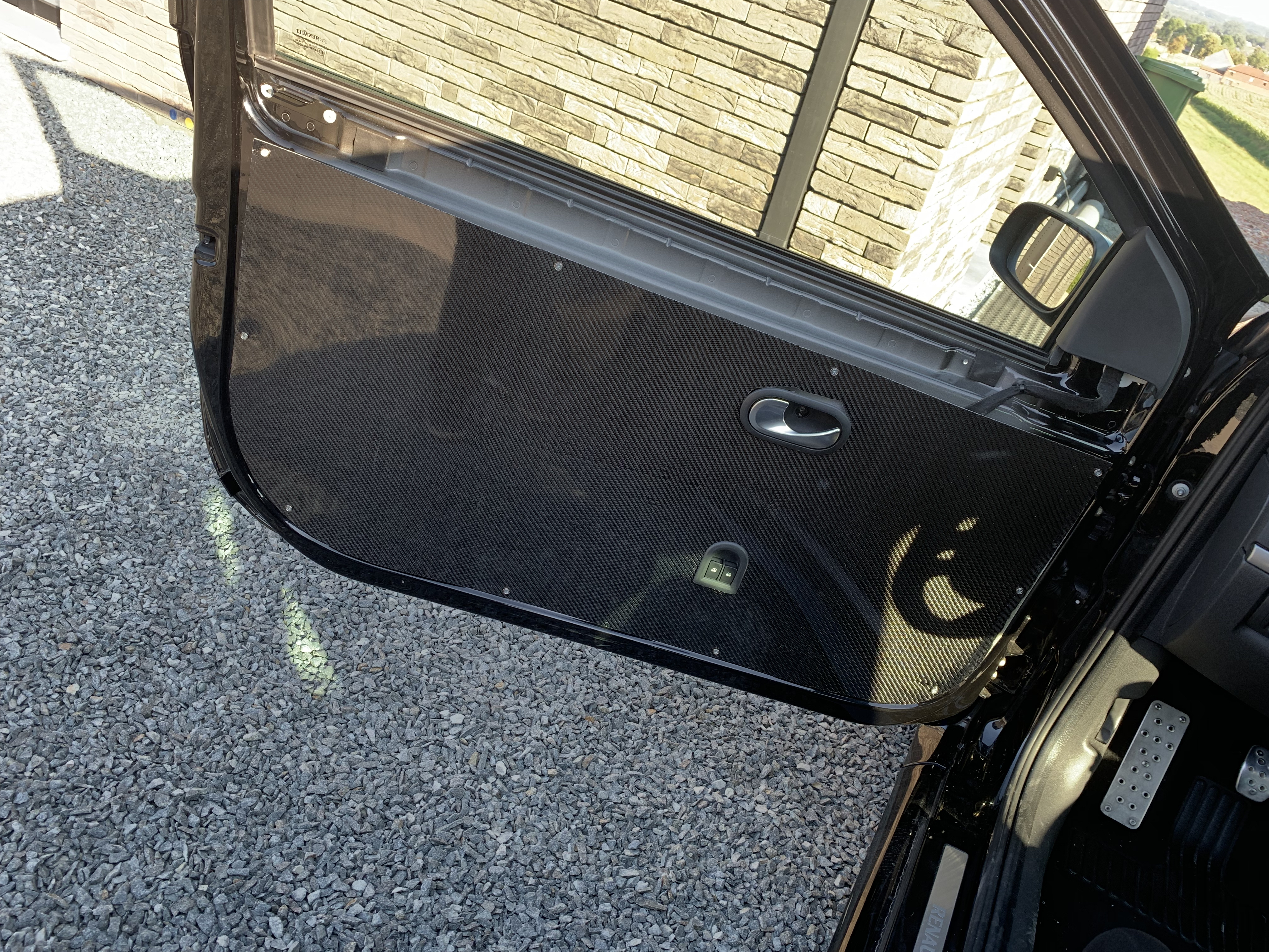

Carbon doorpanels

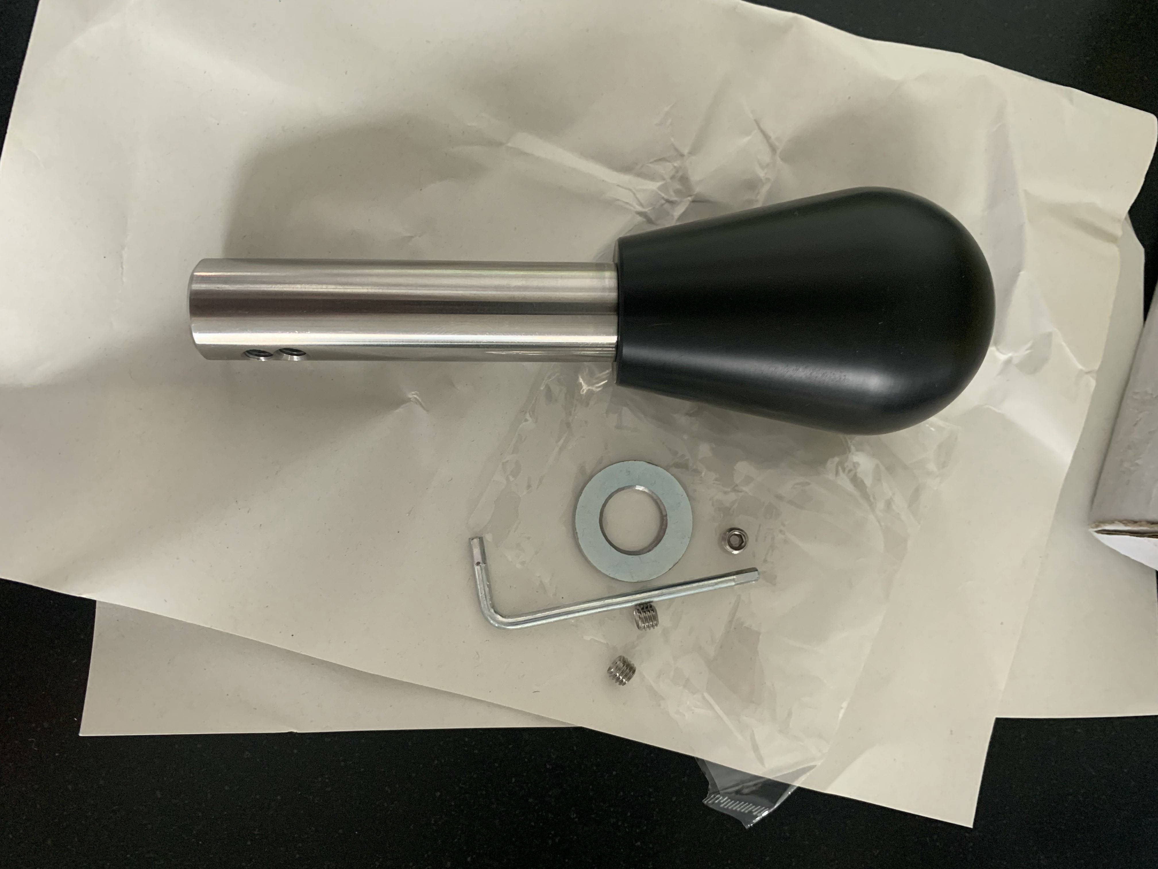

Shifter extender

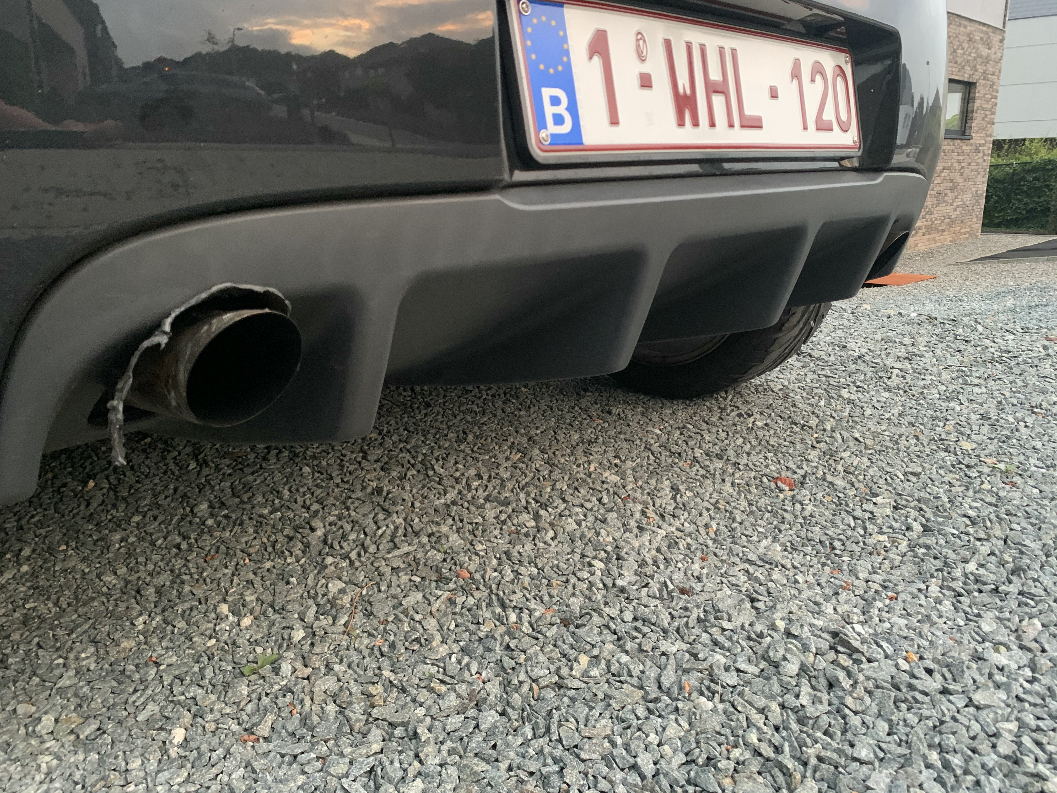

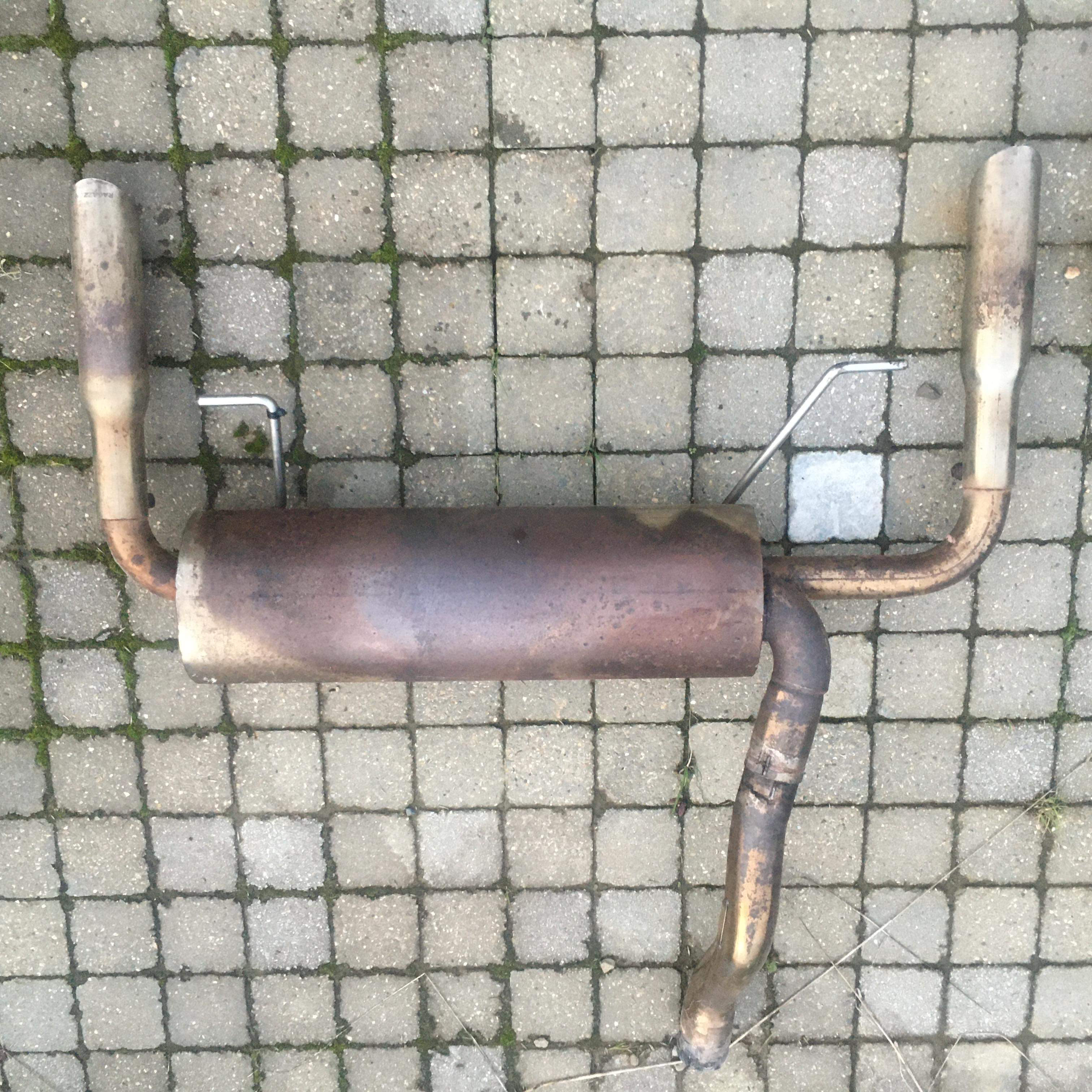

Exhaust before fitting it, it’s not too loud but gives a nice sound.

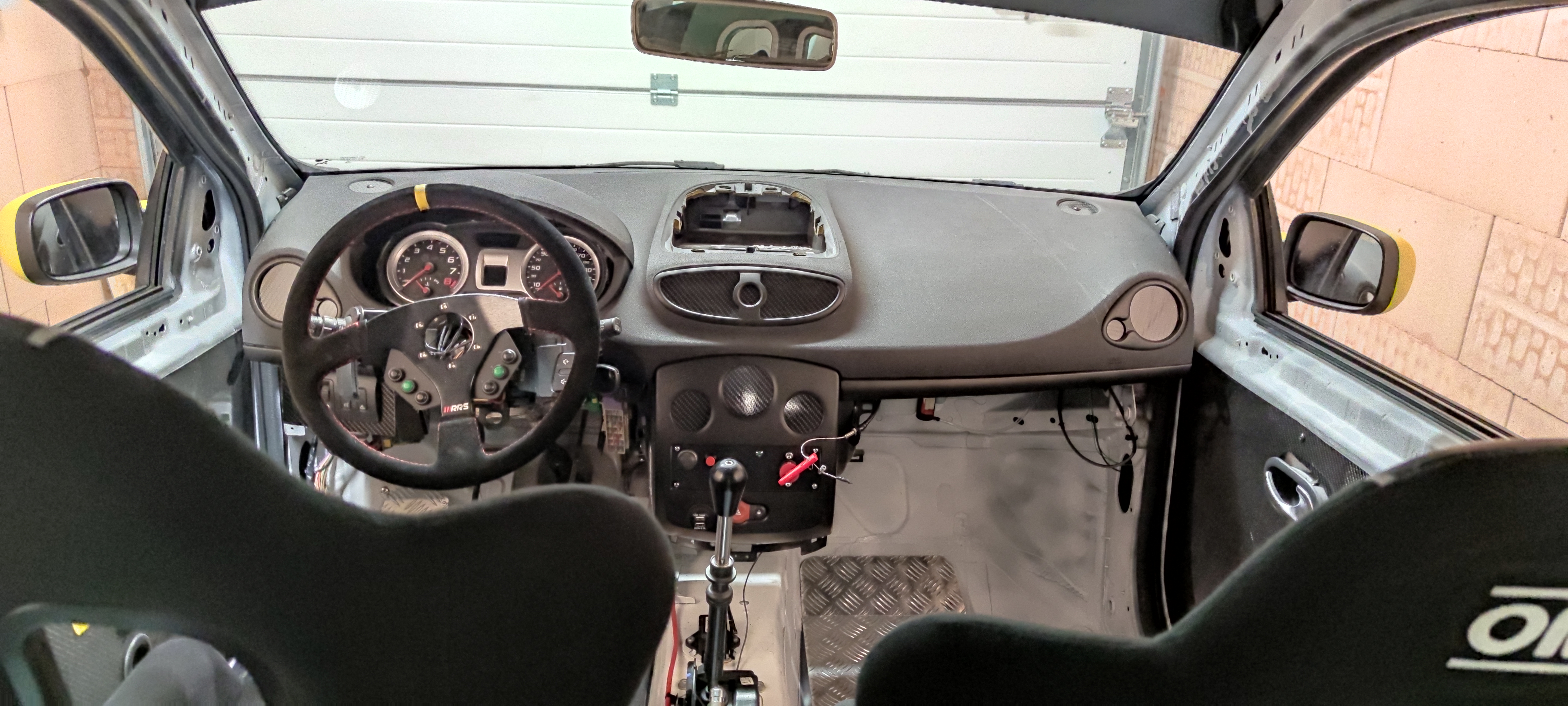

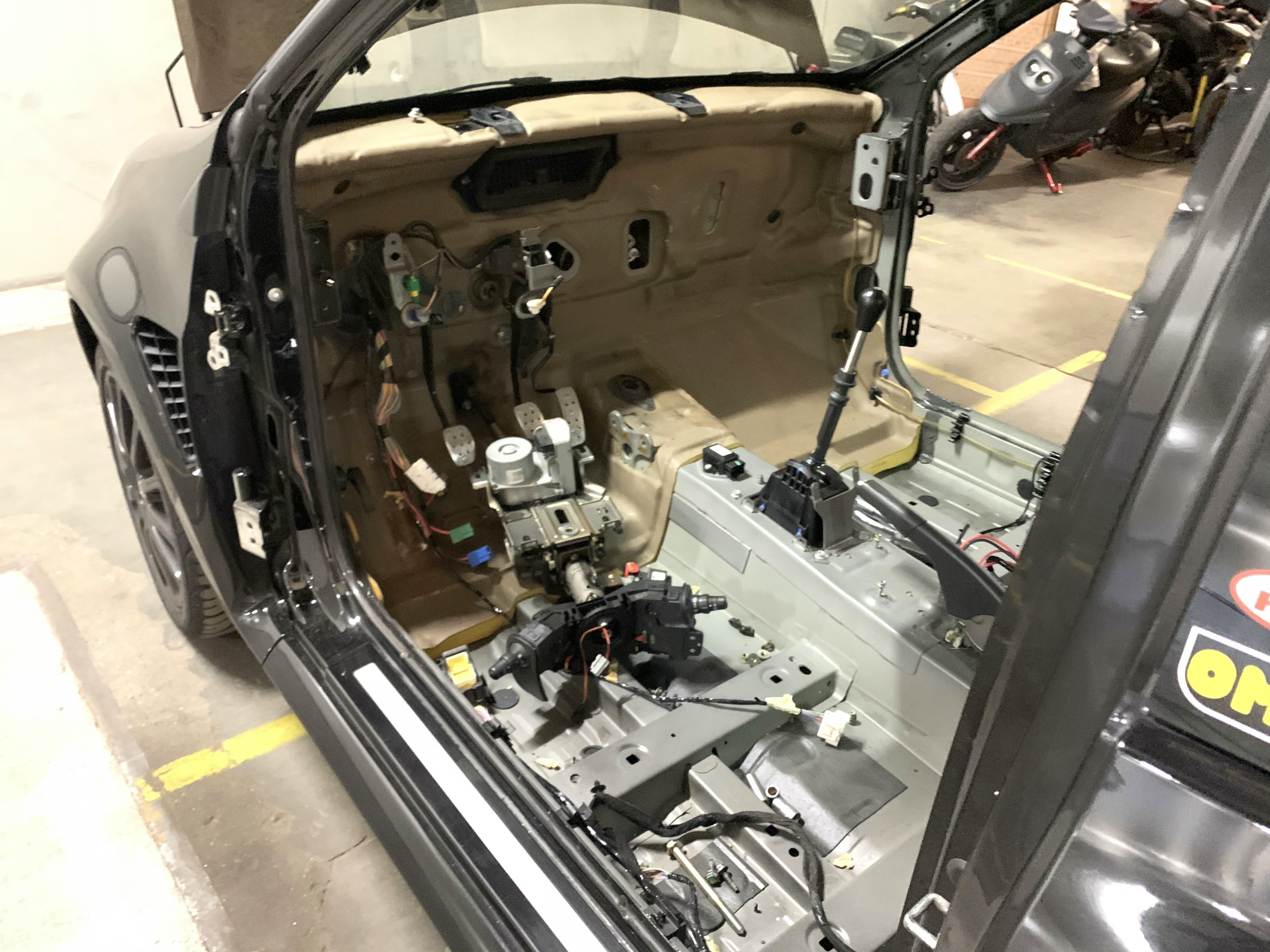

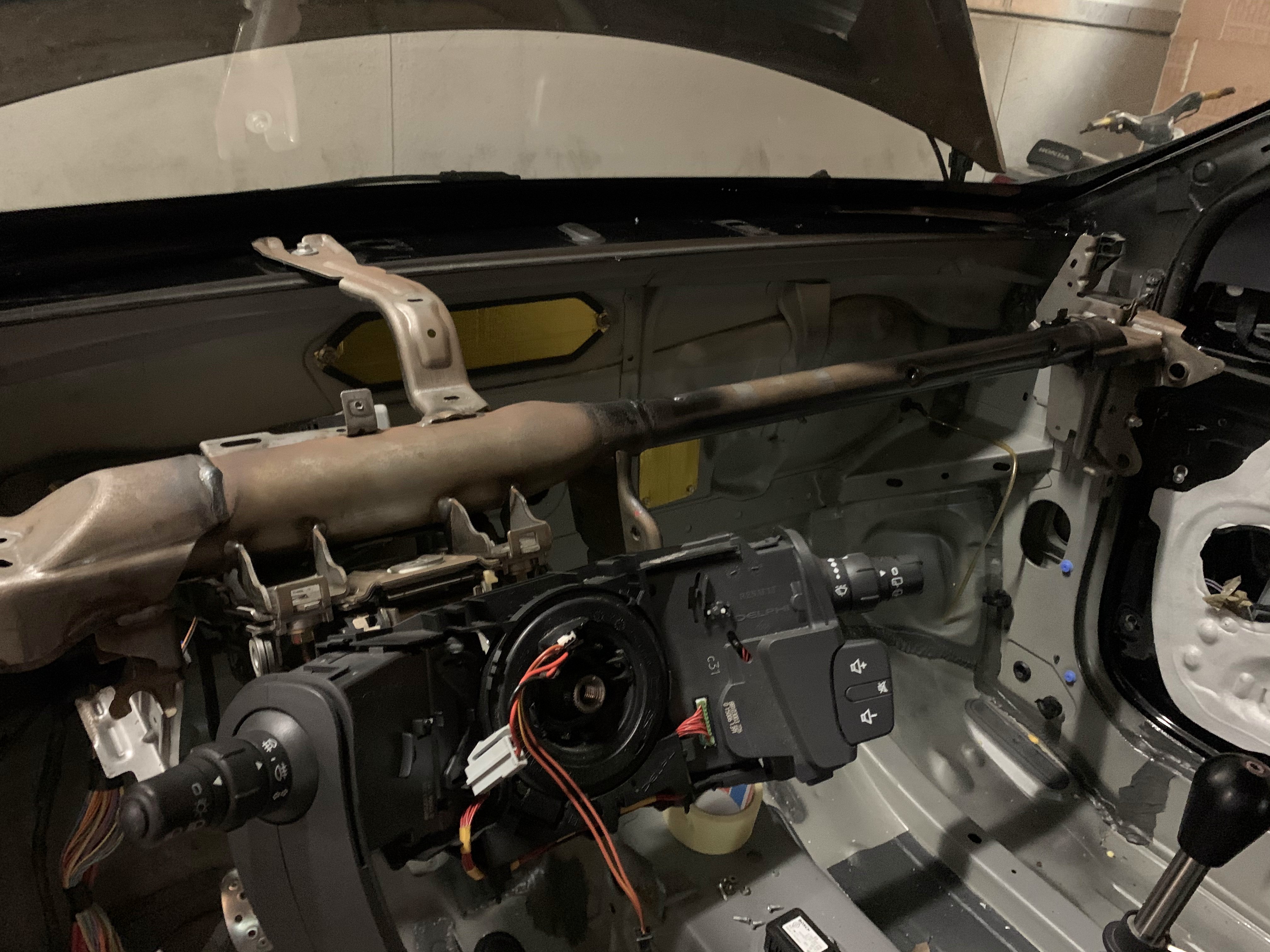

At the moment I’m stripping the whole interior, heater box, wire loom,….
Reactions: wootwoot and ttrw2

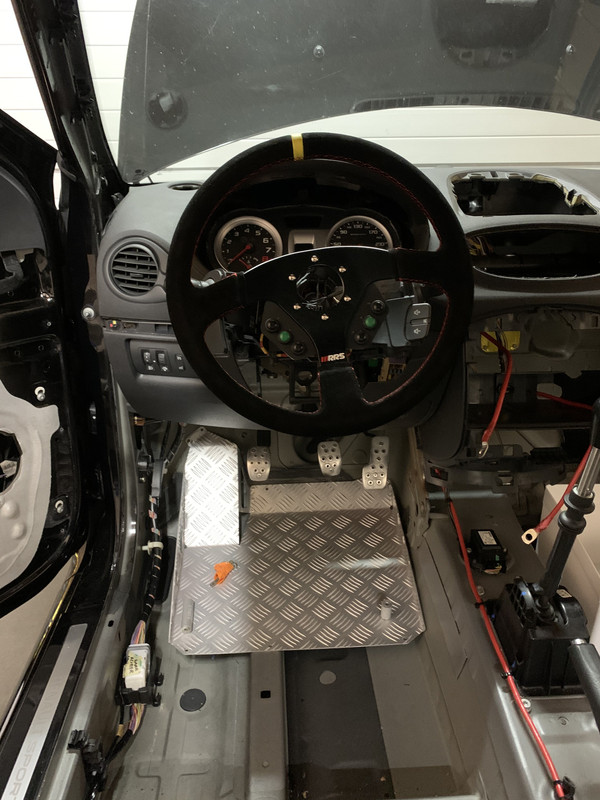

Yesterday I finally had some time to work on the car. Removed the heater box, a few brackets from the crossmember and made some plates to cover the holes.

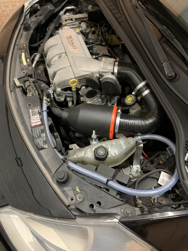

Next up, fix the wiring for the battery relocation, make a bracket so I can fit the airfilter and try to move the expansion tank.
An update after a bit of time… Finished stripping the front wire loom, I also Installed a Clio cup footplate, Momo steering hub, RRS steering wheel and Volantech button plate that I bought second hand.
Finished the battery relocation, installed the other air filter and the plates on the diffuser.

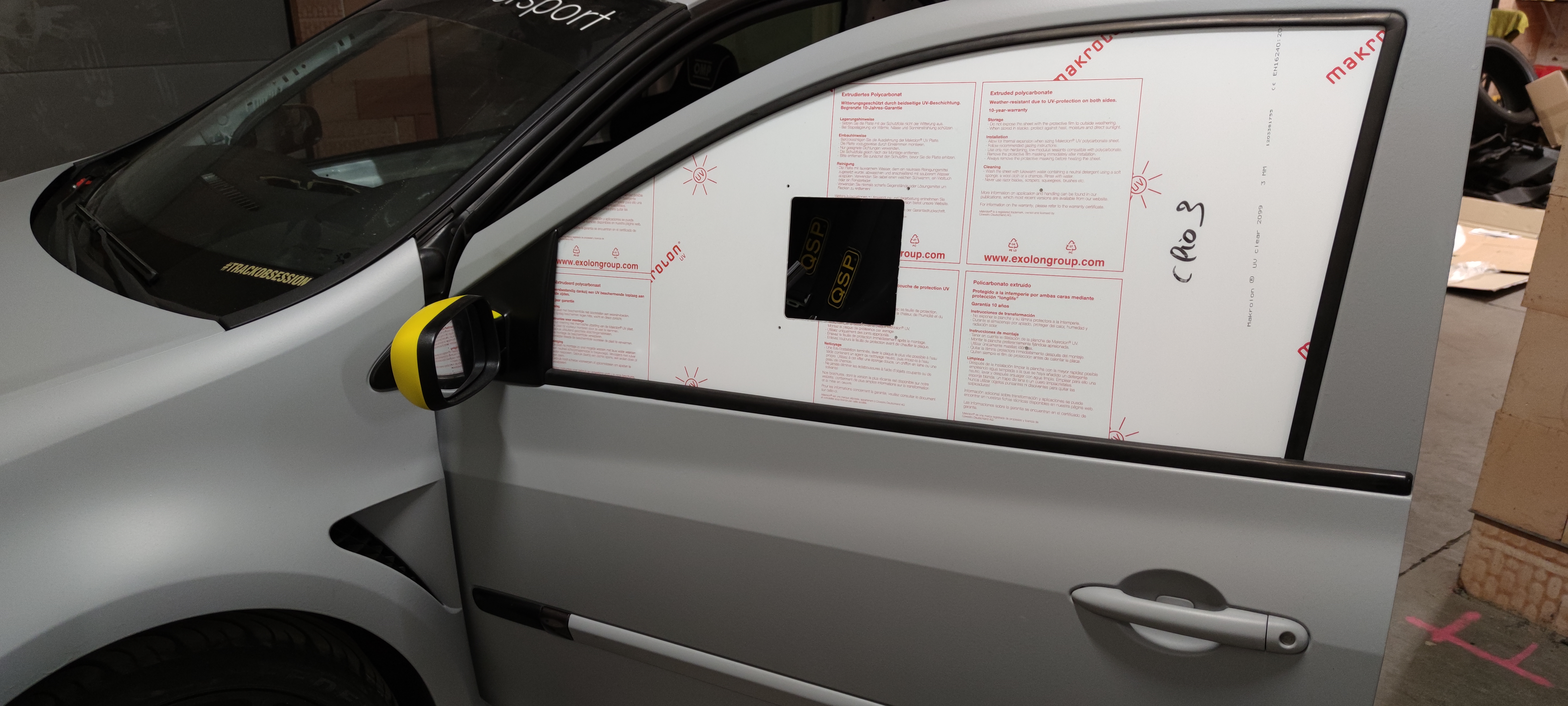

Fitted lexan window in the front doors.

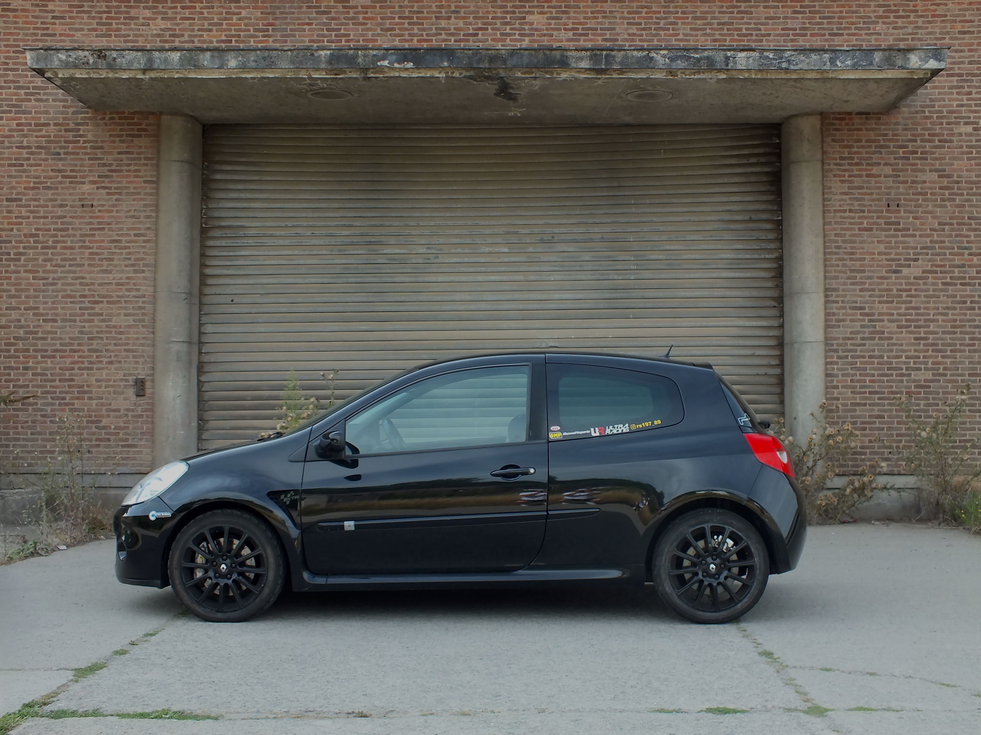

Looks nice though why does it sit so high? 10th pic down makes it look like a little SUV.
Because it's still on stock suspension. Next update will be some coilovers, just looking for the right set. I was looking at yellowspeed or gaz but might change if something good comes up second hand.

- Removed the aircon compressor, the easy way.

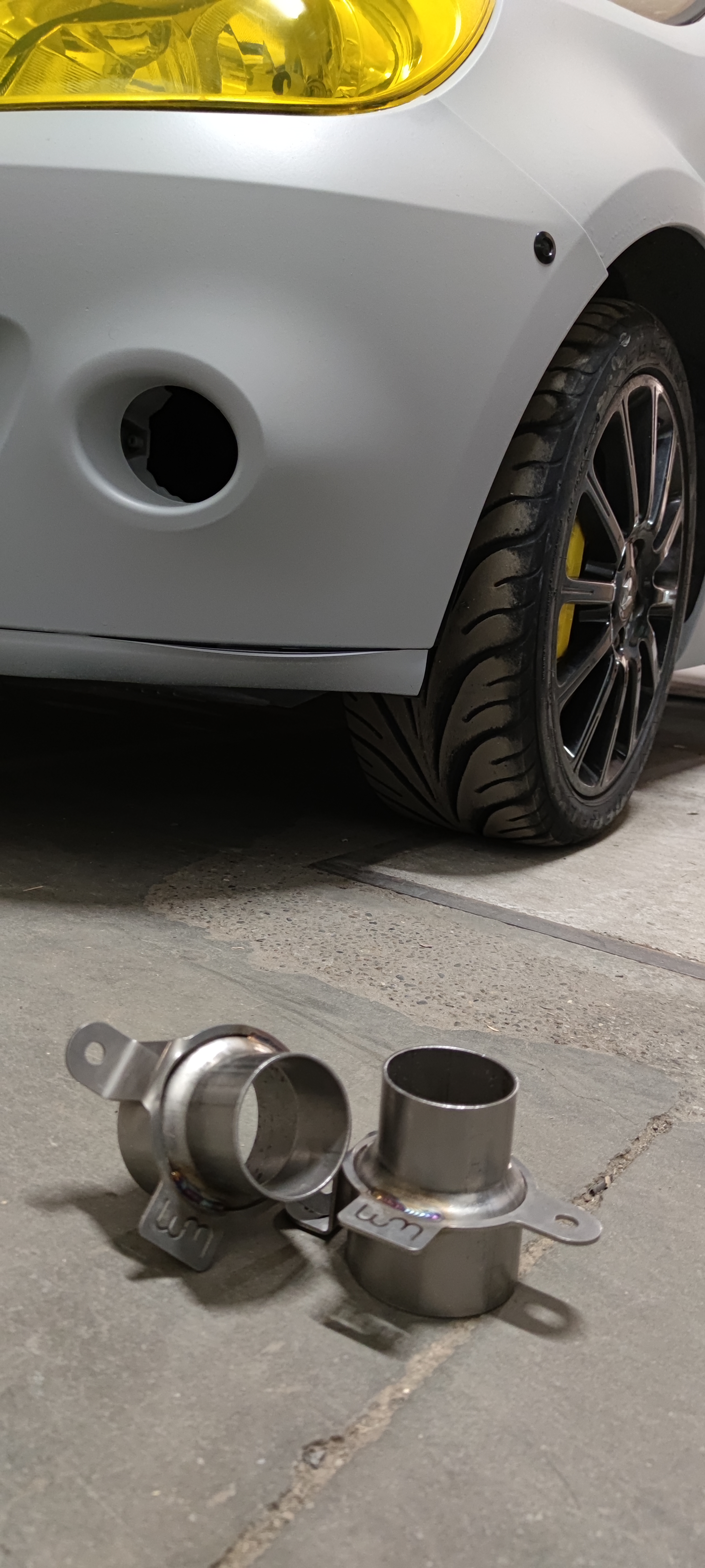

Heatwrapped the exhaust and put v-band clamps on instead of the simple slide in fitting. So no more blowing exhaust sounds :sunglasses:

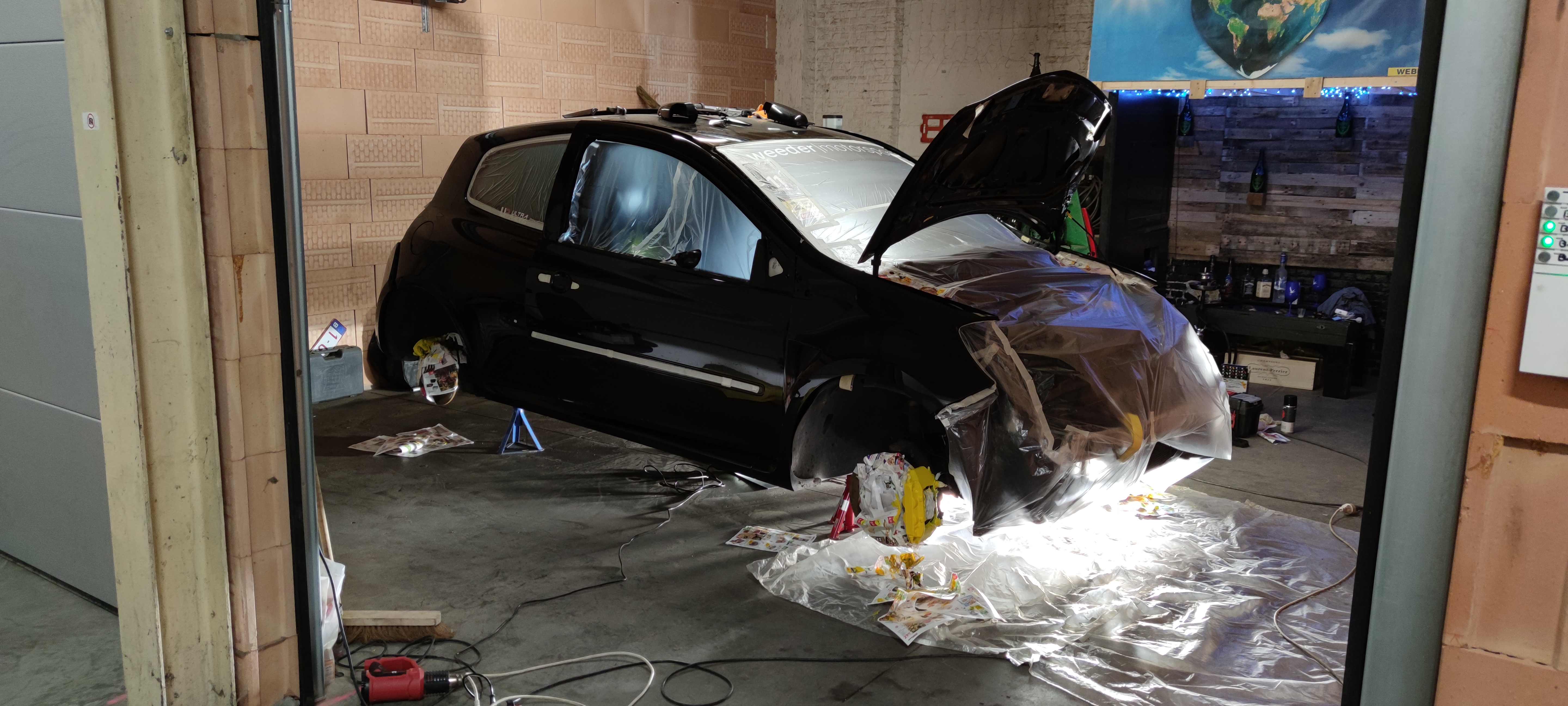

Started with the wrap. Just needs some more stickers and mount a black towstrap on the back.
