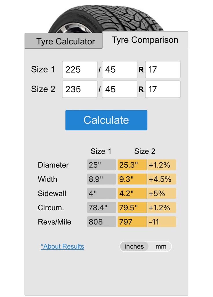

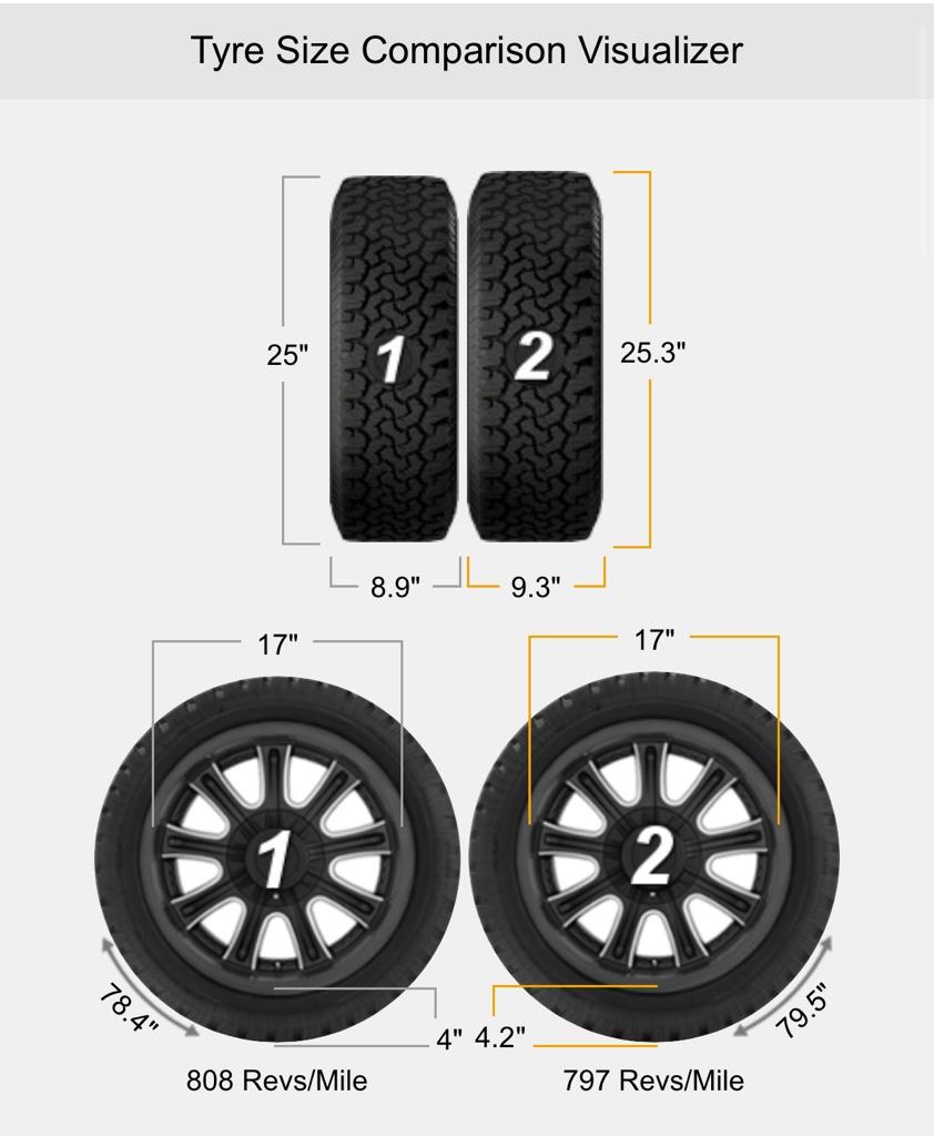

225/45/17 vs 235/45/17
Reactions: NISMO1968
If you’re measuring height, yeah. My point being that 235 width isn’t necessarily a restriction.
