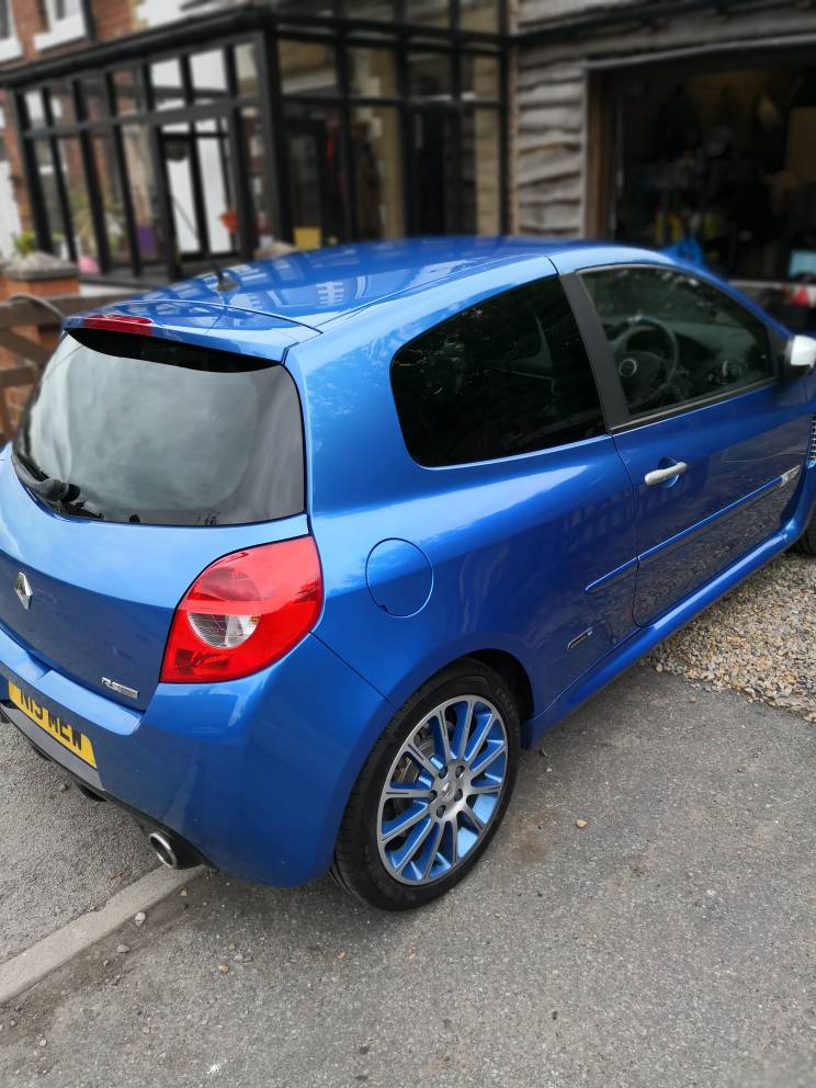

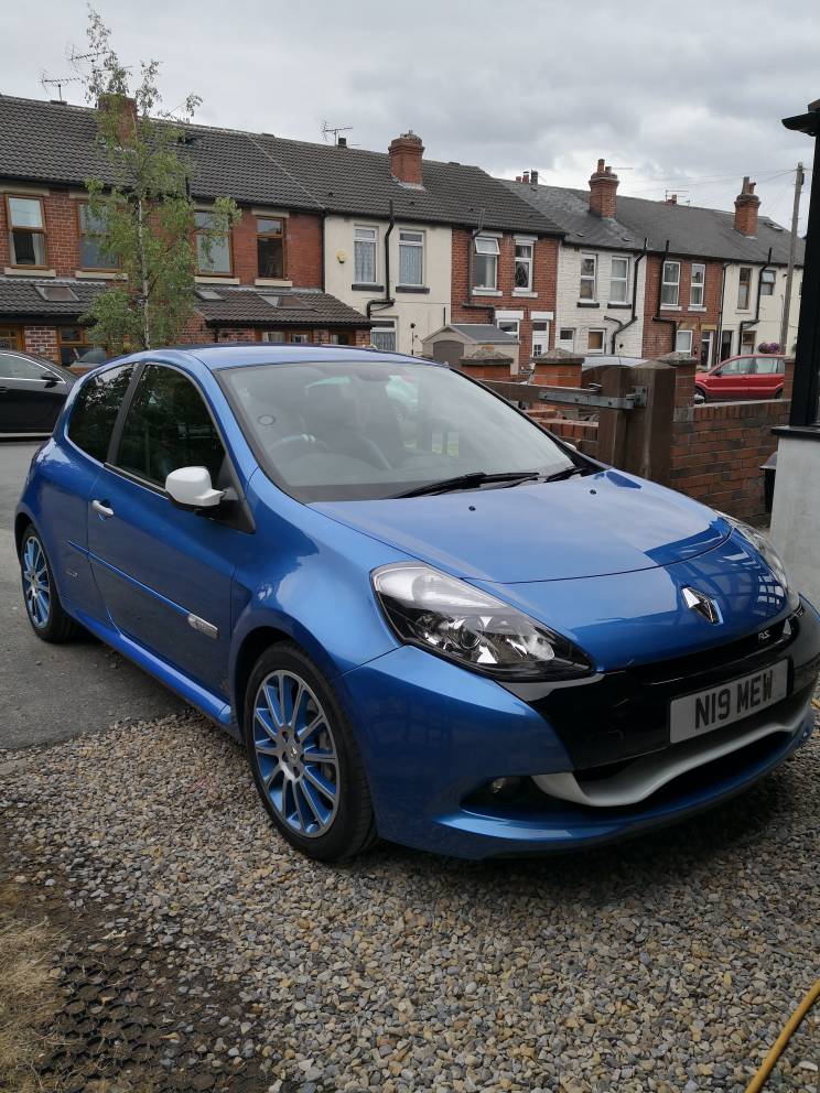

The car was completely standard when I picked it up. A 2010 model with 42k miles.. and crappy tyres!! [emoji85] I never understand why people put rubbish tyres on performance cars.. just been ribbing a mate of mine for putting Landsails on the front of his new S5!

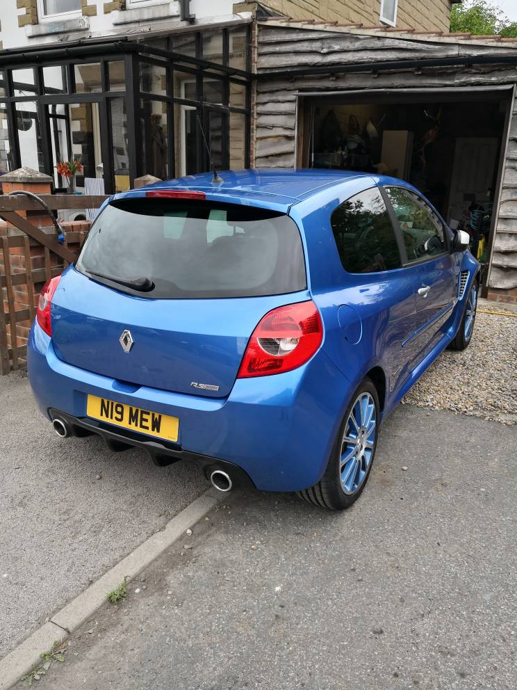

First thing I did was take off the Clio badge to make the rear look much tidier.
And a pic with said S5 outside Five Guys at Kirkstall Road.1cdfcb3edc64d4574b22f0bab4cc7630.jpg0aa71557ea4f0fb1d39370c3f2ebae4f.jpgc5d96c1456bd3595c30f9a847bfb7932.jpg

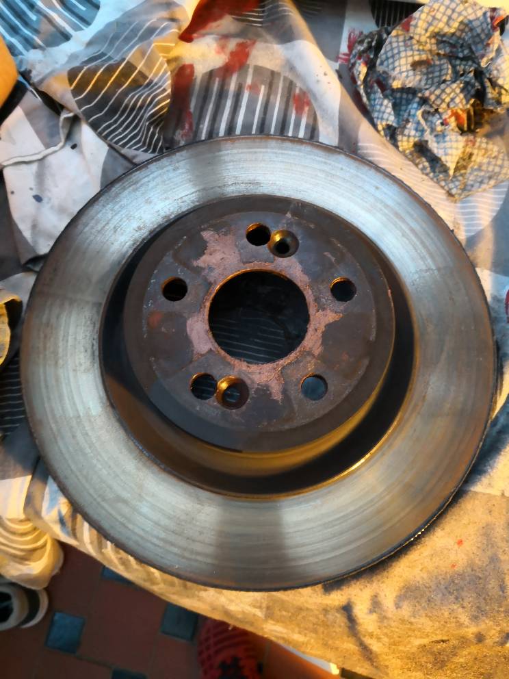

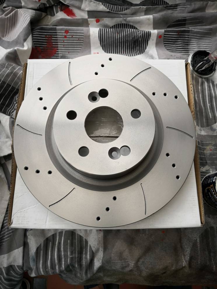

So last month I wasn't happy with the state of the rear discs, really corroded so I replaced these myself with some Mtec drilled and grooved and EBC Yellowstuff pads. I did this myself having never really worked on cars before and found it fairly straightforward following the guide on here.. apart from everything being seized and the calipers being a pig to wind back!
I also put Yellowstuff pads up front and on checking the discs they looked good, slightly lipped but still decent.. well on the face of it but I'll come to that later!! da56e262302068c5a9577e4283d89c3c.jpg712bdd7b6474afec7a2fac37d8f7cbdf.jpg0c204b9beab905127bf684798eb4f645.jpgf5955174730b2031f213fba900537973.jpg

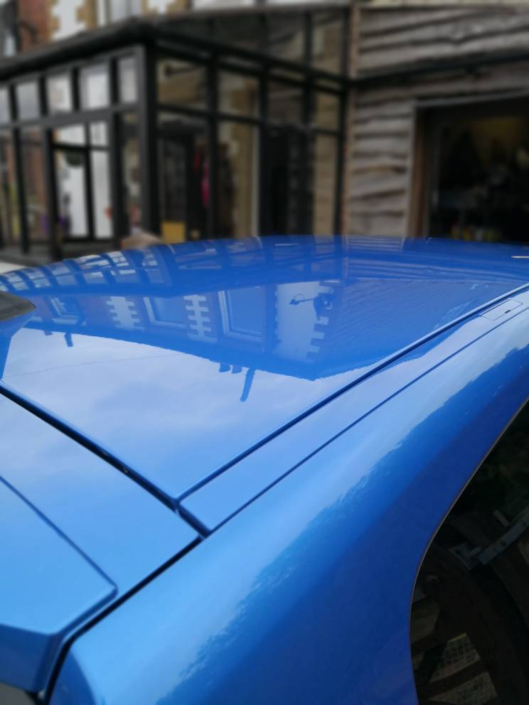

Next up a good polish after having it washed as my pressure washer packed up. I've never been in to detailing.. don't get me wrong though I like a nice clean car but I get annoyed finding marks and scratches etc! Might change with this one though.
I don't know what it is but I've become addicted to it, I really love this car.. maybe it's because I've just come from a boring brand new Passat?? But it's only a year since I had an Accord Type R.. and I never really got into the last Clio I had which was a 182 Trophy 11 years ago when it was a couple of years old. I didn't keep it long but now I wish I still had it.

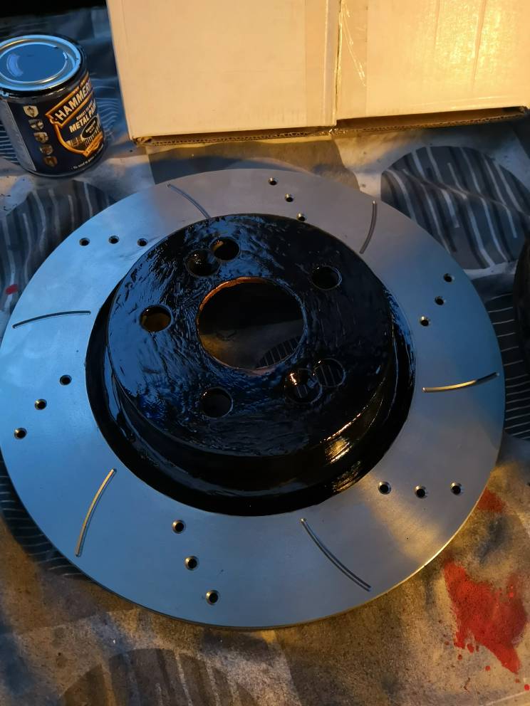

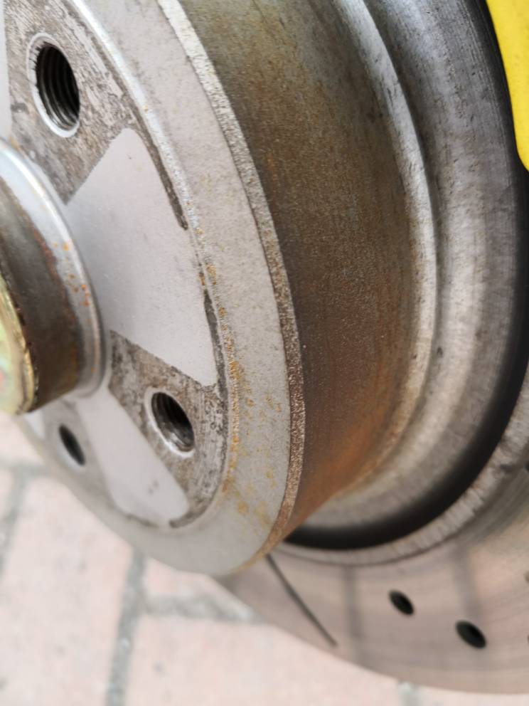

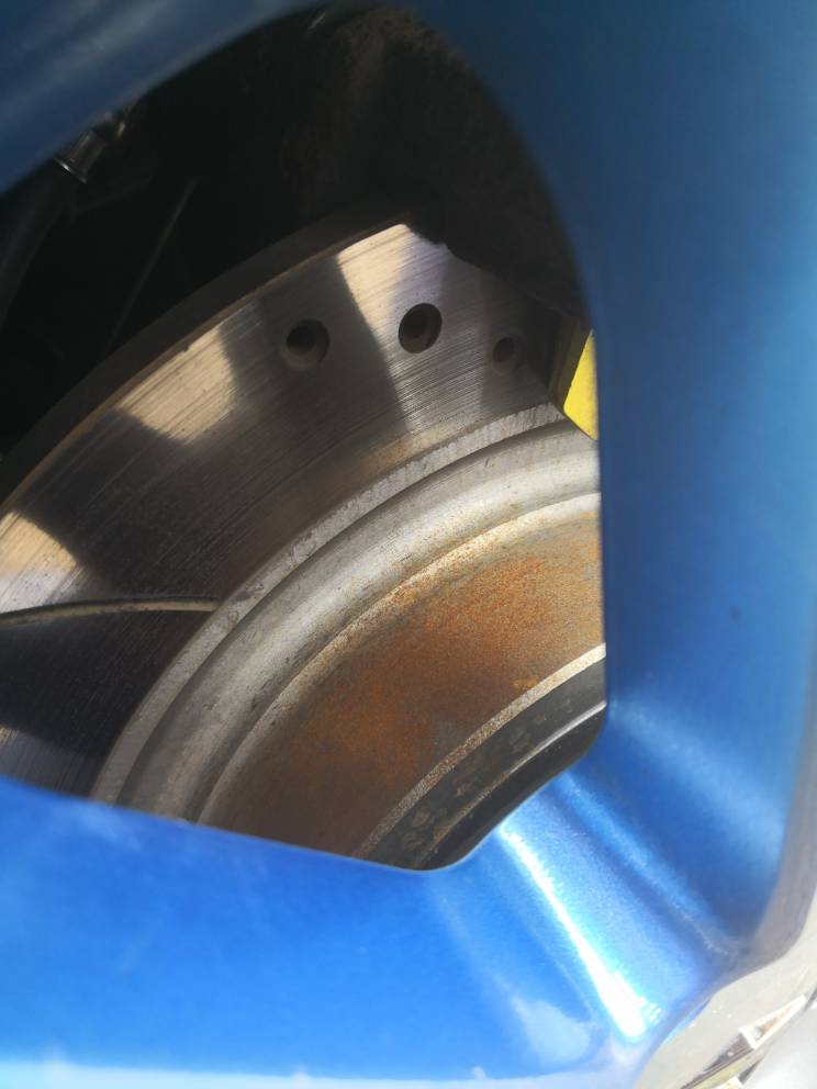

I opted for the silver coating on the Mtec rear discs and I wish I'd have seen the posts about it before I did because after only a few weeks they were already showing corrosion! Not just surface rust either as I tried cleaning it off...
So I complained and was refunded fully for the coating so the week before last I spent some time painting the hubs in hammerite smooth black instead. Whilst there I got some E-tech high temp paint and painted the rear calipers in red. The finish isn't amazing as I did it whilst on the car but it's a million times better than the rusty looking things they were before.

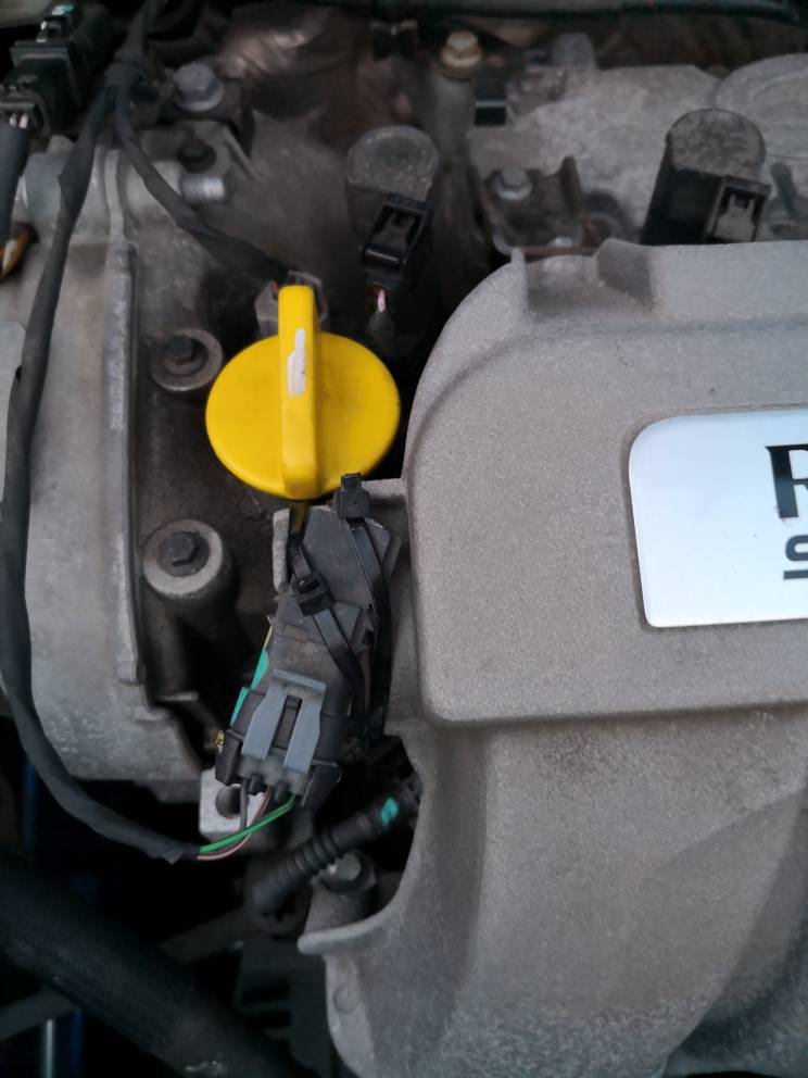

I also did this little fix for the MAP sensor at the same time and the car has behaved much better from cold since I did this.

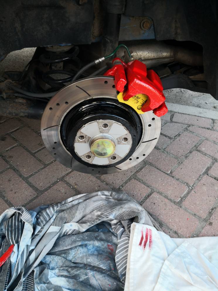

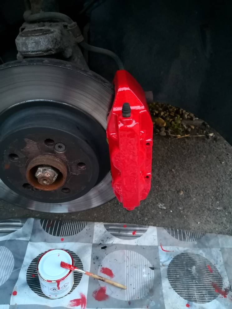

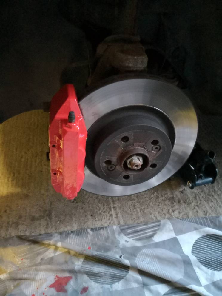

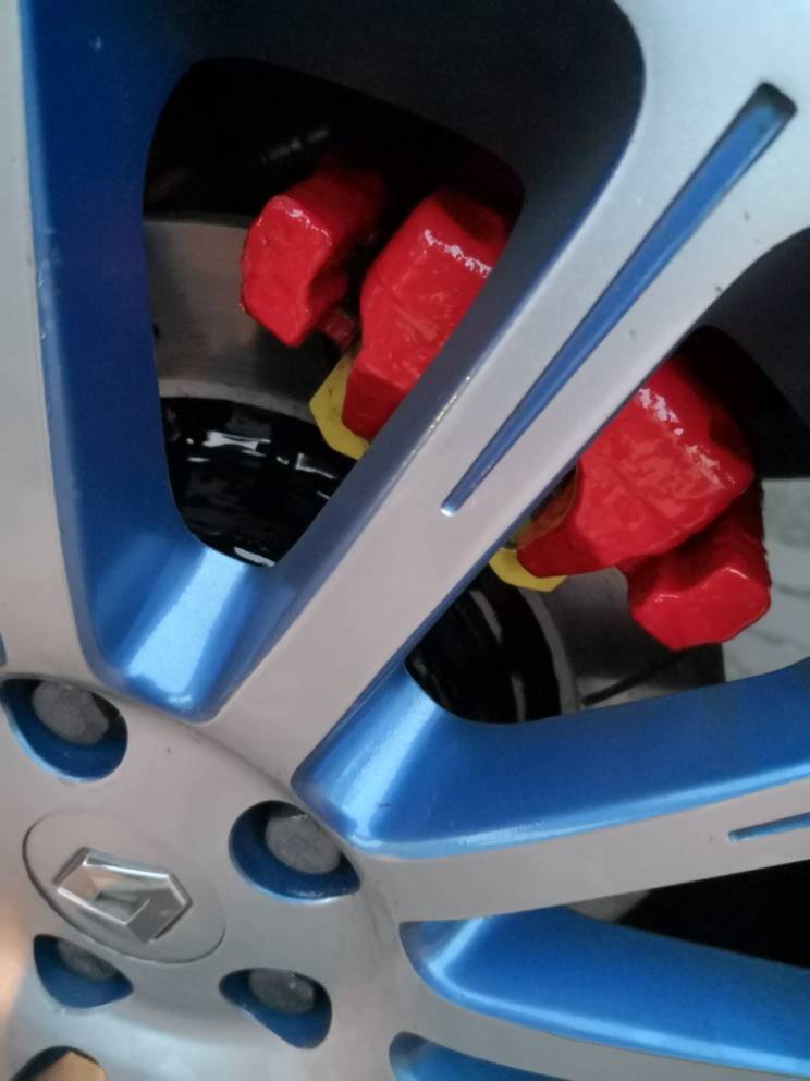

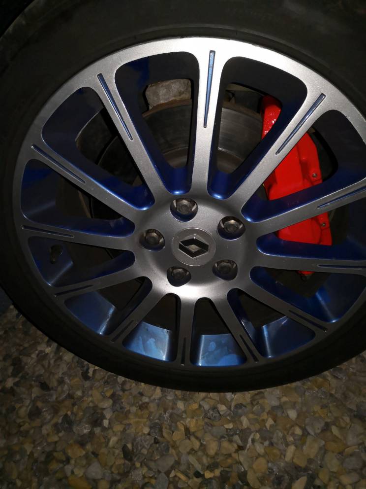

So a couple of days later onto the front calipers.. now it's not got the Cup pack so they were silver as standard. They looked ok, if not a little tired so painted them red as well. Not a great finish but unless right up close they look great and will do until I get some new or refurbished ones which is on the 'to do list'. I've got some new brembo decals to go on these but I'm away at the minute and didn't get chance to do these last week when they arrived.
I've also got some new Bremtech pins to go in the fronts from Brake Parts on eBay, £12.99 for the full set.

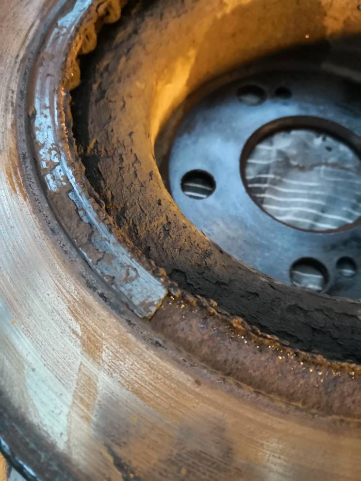

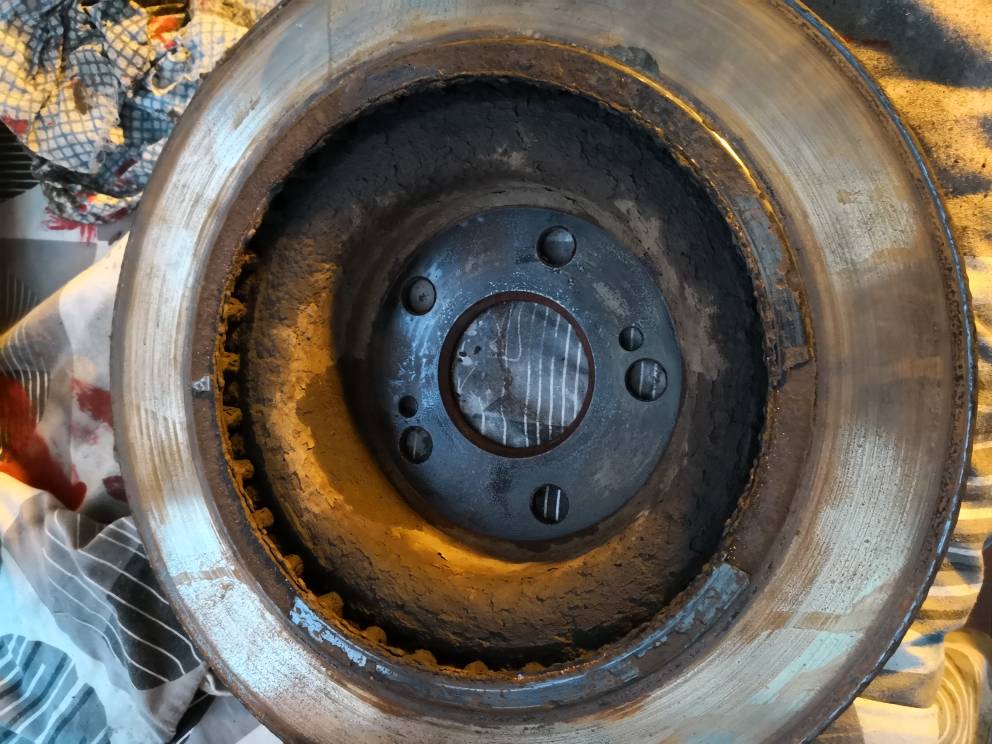

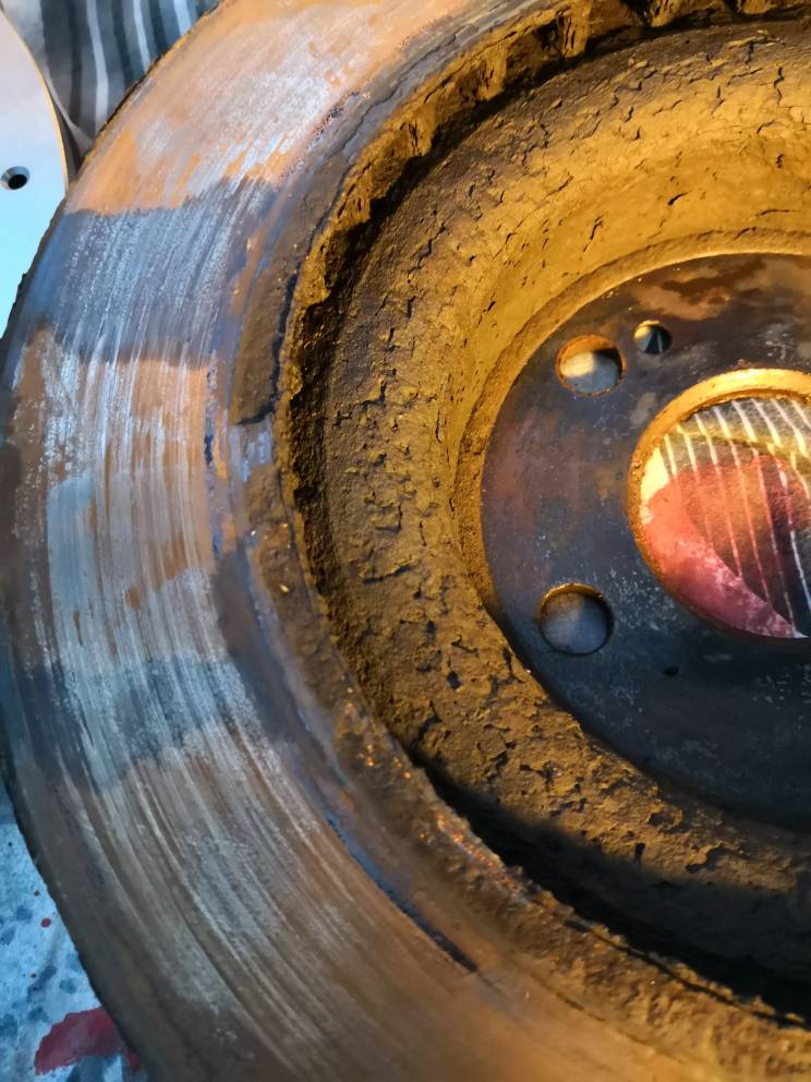

Whilst painting the front calipers I found a couple of problems unfortunately which needing sorting asap..
The inside of the discs on the inside edge were badly corroded, and this had spread up on to the bottom of the contact area and if left potentially ruining my new pads! This was obviously the source of a bit of a grinding type noise from the brakes.. I obviously didn't check them properly when I replaced the pads!!

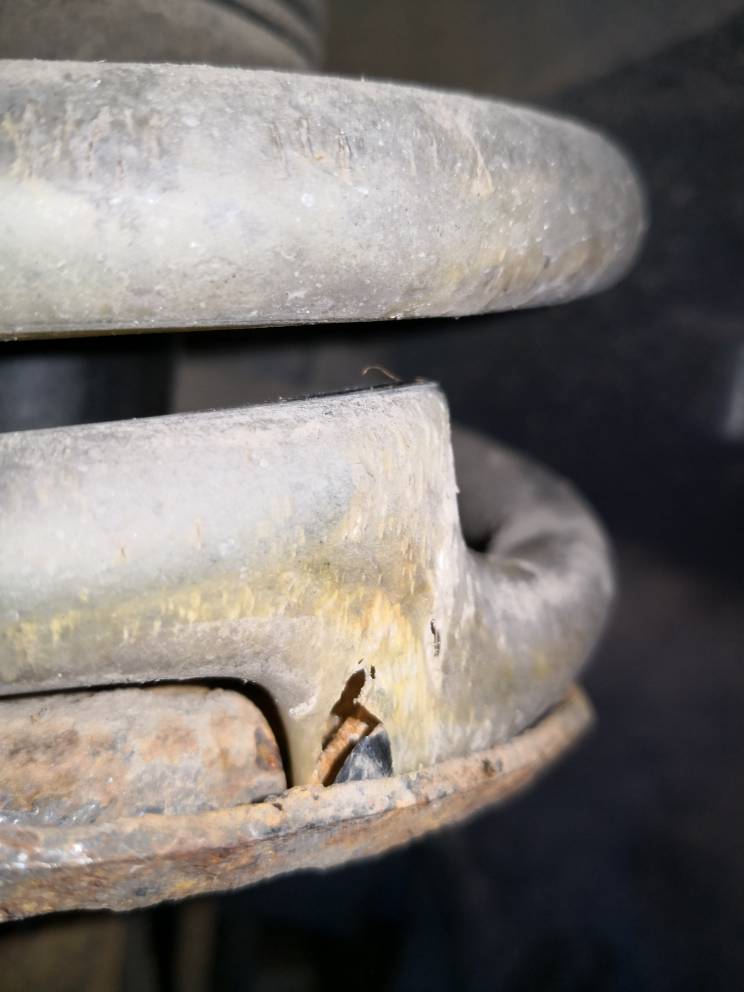

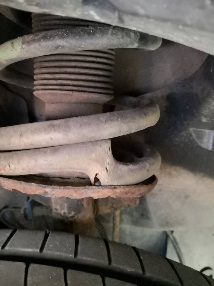

As well as this I discovered the front n/s spring was cracked [emoji85]. Good news or bad? Update on that one to follow...
So I again ordered the new discs from Mtec this time with no coating! They came the next day, a week last Monday, and I fitted them straight away as I was off, after again painting the centres in hammerite smooth black to match the rear. Much better, and as the pads had been on less than 1k they should hopefully bed to these new discs without issue.

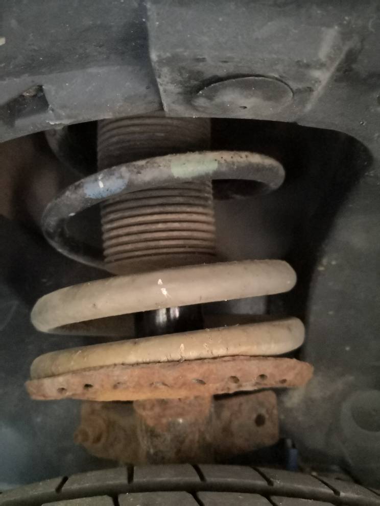

Cracked front spring and the dampers looking tired in general at 8 years old although they've only covered 45k miles now.. so a decision to make on where to go having been considering refreshing this already [emoji848]

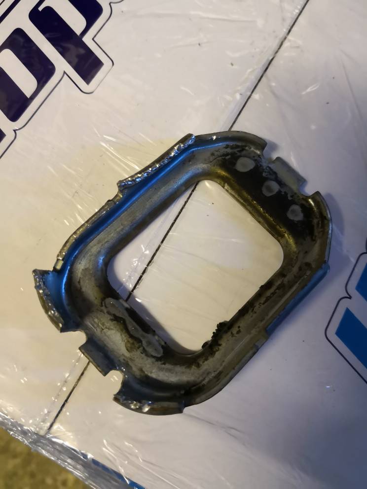

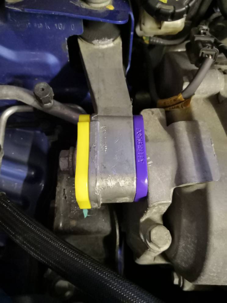

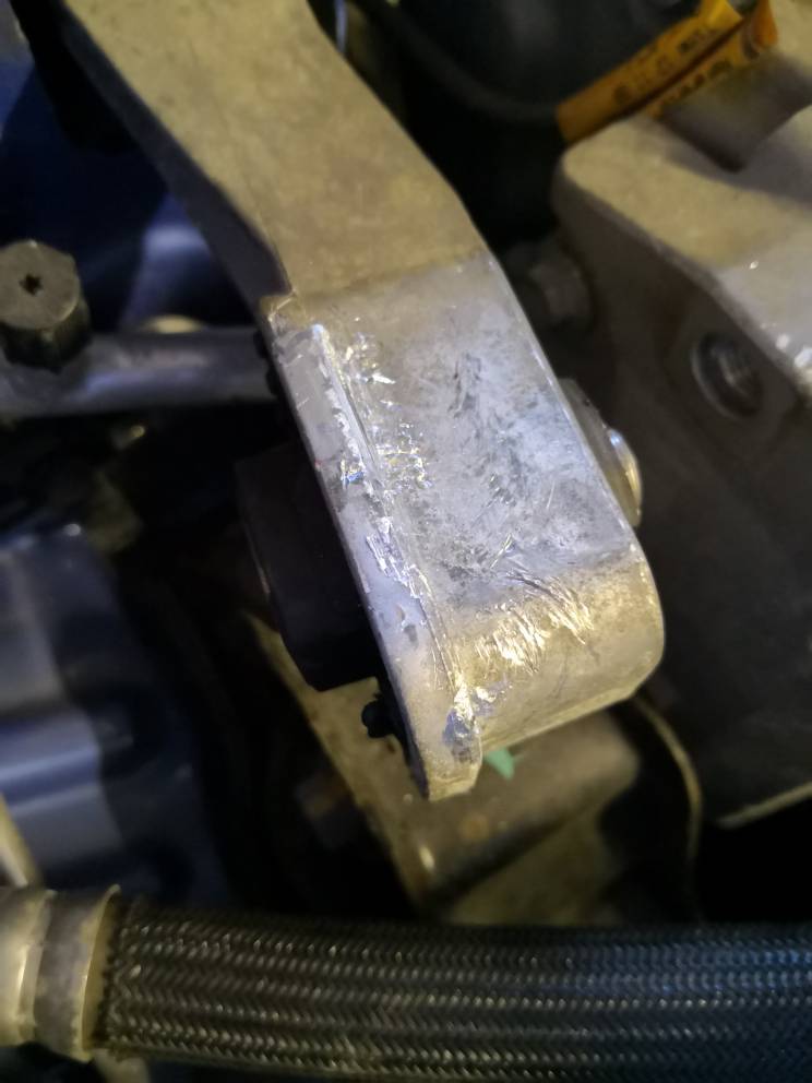

So at the same time as the painting I decided to tighten the car up and hopefully some preventative maintenance to preserve my standard manifold/flexis with the upgrade of the engine mounts.
I ordered the Powerflex upper torque mount and lower engine mount inserts from Eurocarparts and collected them the next day on the way home from work and went straight to fitting them between coats of the last caliper.
Anyone who says this is an easy quick job I'm sure is lying!! They took me ages! [emoji85] Firstly I could not get the metal bracket thing off the upper torque mount.. and then relocating the lower mount after fitting the insert was an absolute nightmare and took me a stupidly long amount of time and effort to get it back in, but it finally went and I ended up lowering the car off the jack/stands after midnight!
The difference these have made though is night and day and I'd recommend them to anyone. The car feels much tighter and more responsive, not that it was a problem that it wasn't.. but it is such a good cheap upgrade. I actually like the vibrations and feel when you fire it up now, feels like a race car. My Mrs not so much . It's settling down a bit now though after 2 weeks.

Now onto sorting the suspension.. I'd been considering this since I started on this forum actually.. bad influence?!
The spring can't have been cracked for long as I definitely noticed the car becoming more crashy.. the standard suspension is fairly stiff compared to my Mrs new Mini Cooper and the Passat I just had. I find it quite bouncy and my Mrs commented on it when she first came out in it.
