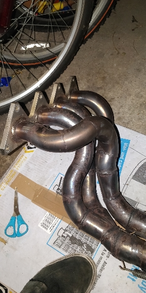

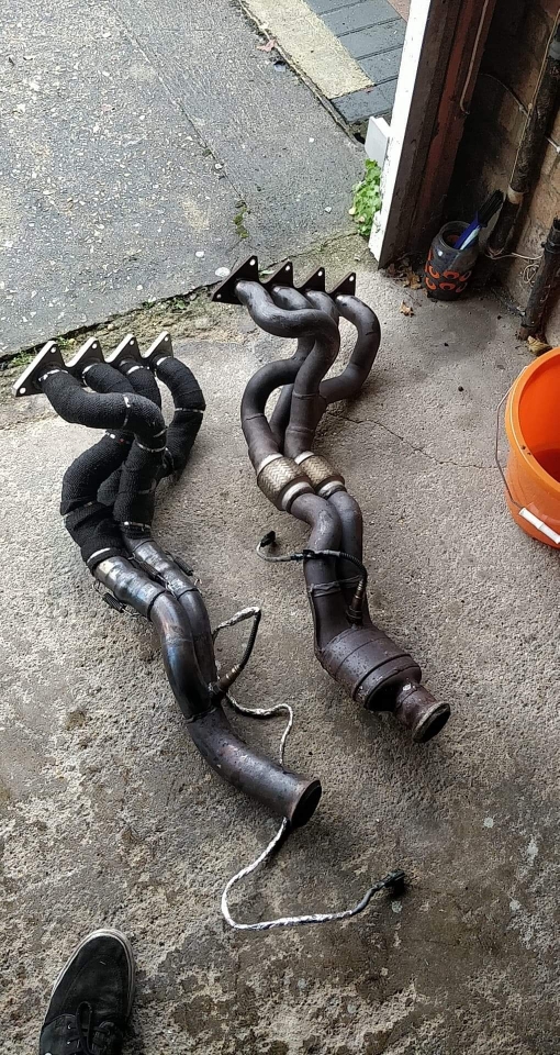

Onrus
I bought the Ktec manifold and it is not the best quality, it looks nice from the outside but internally it is ugly. I’m getting the manifold reworked to smooth the internals as much as possible.
