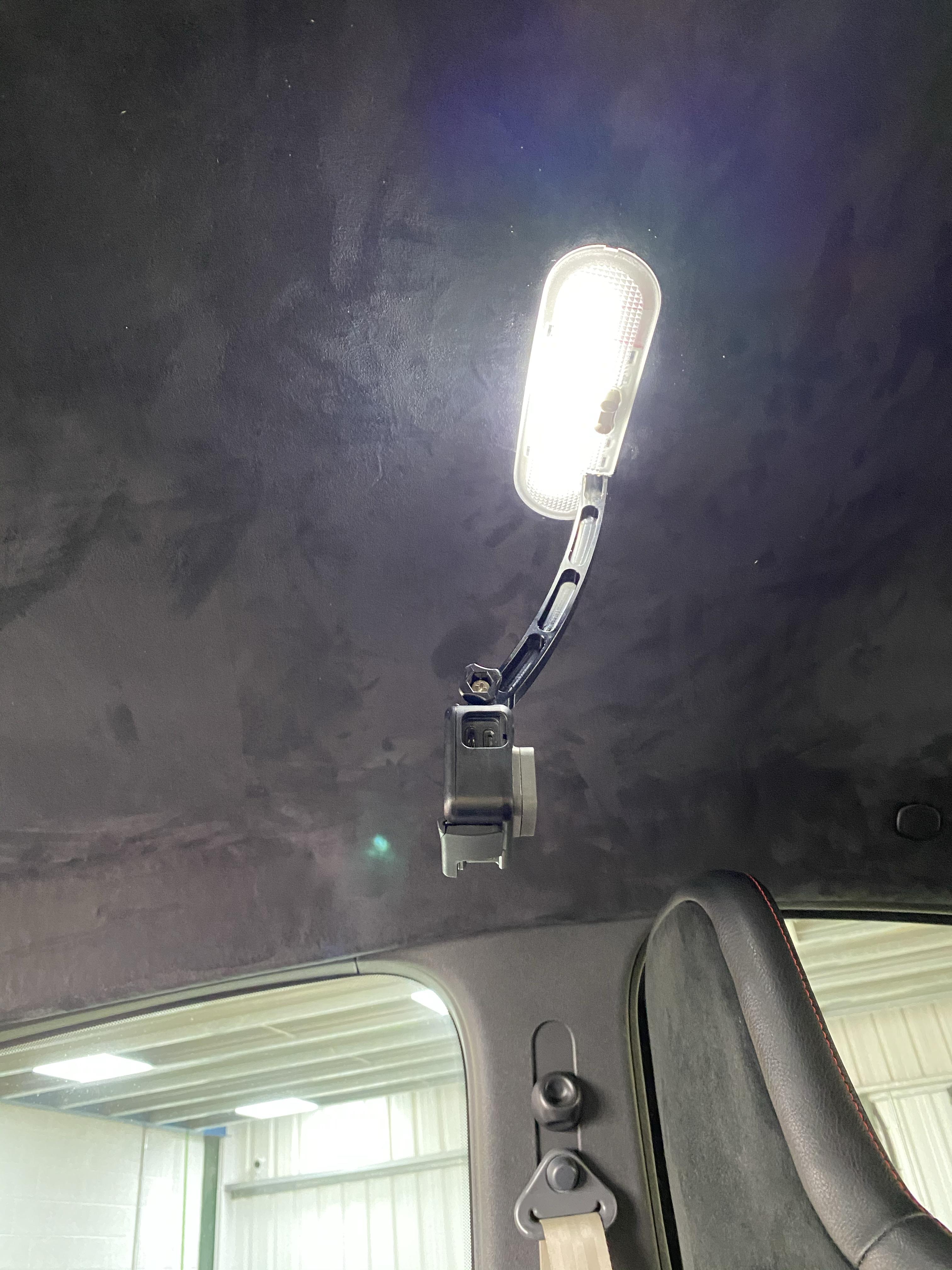

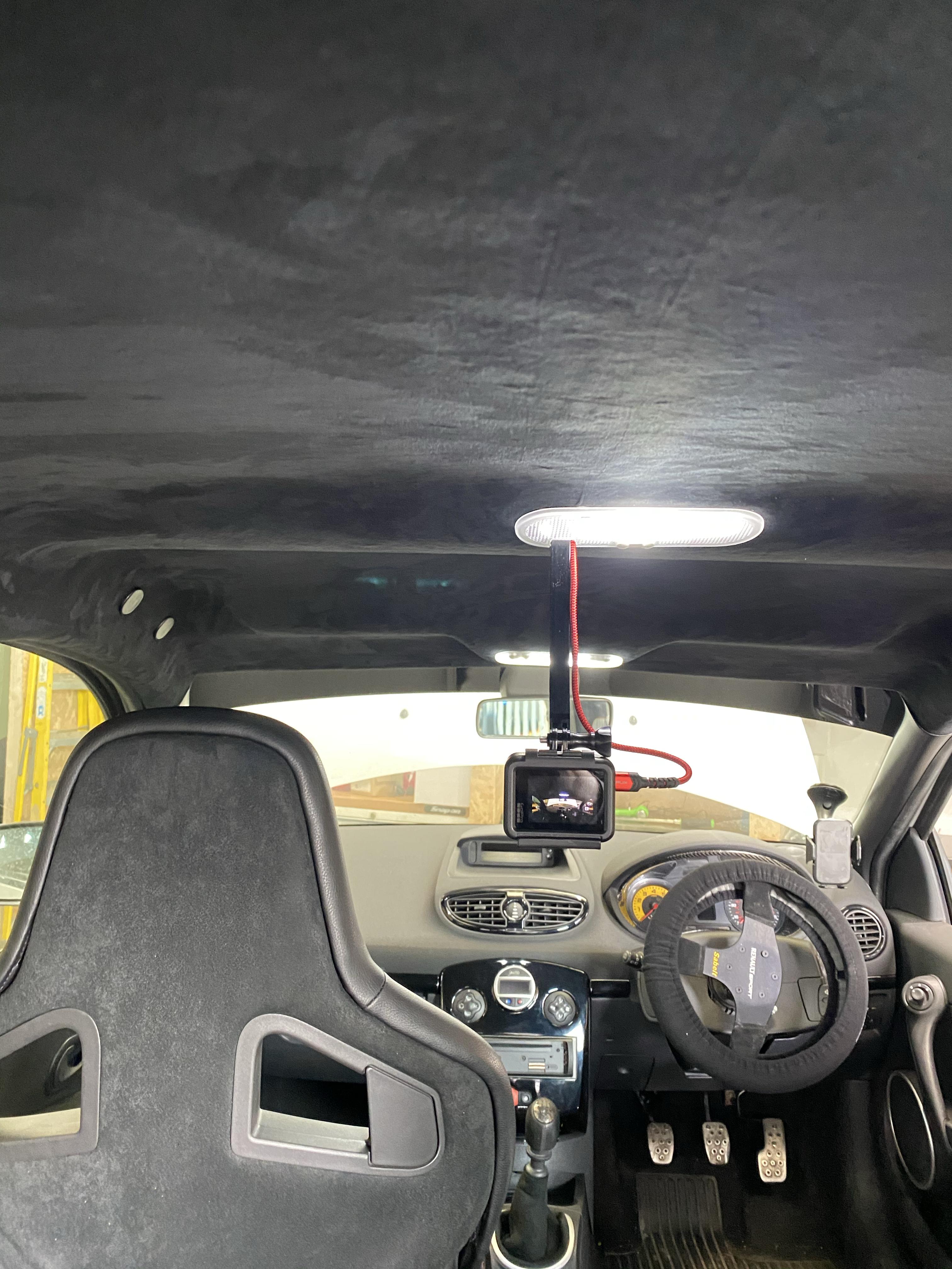

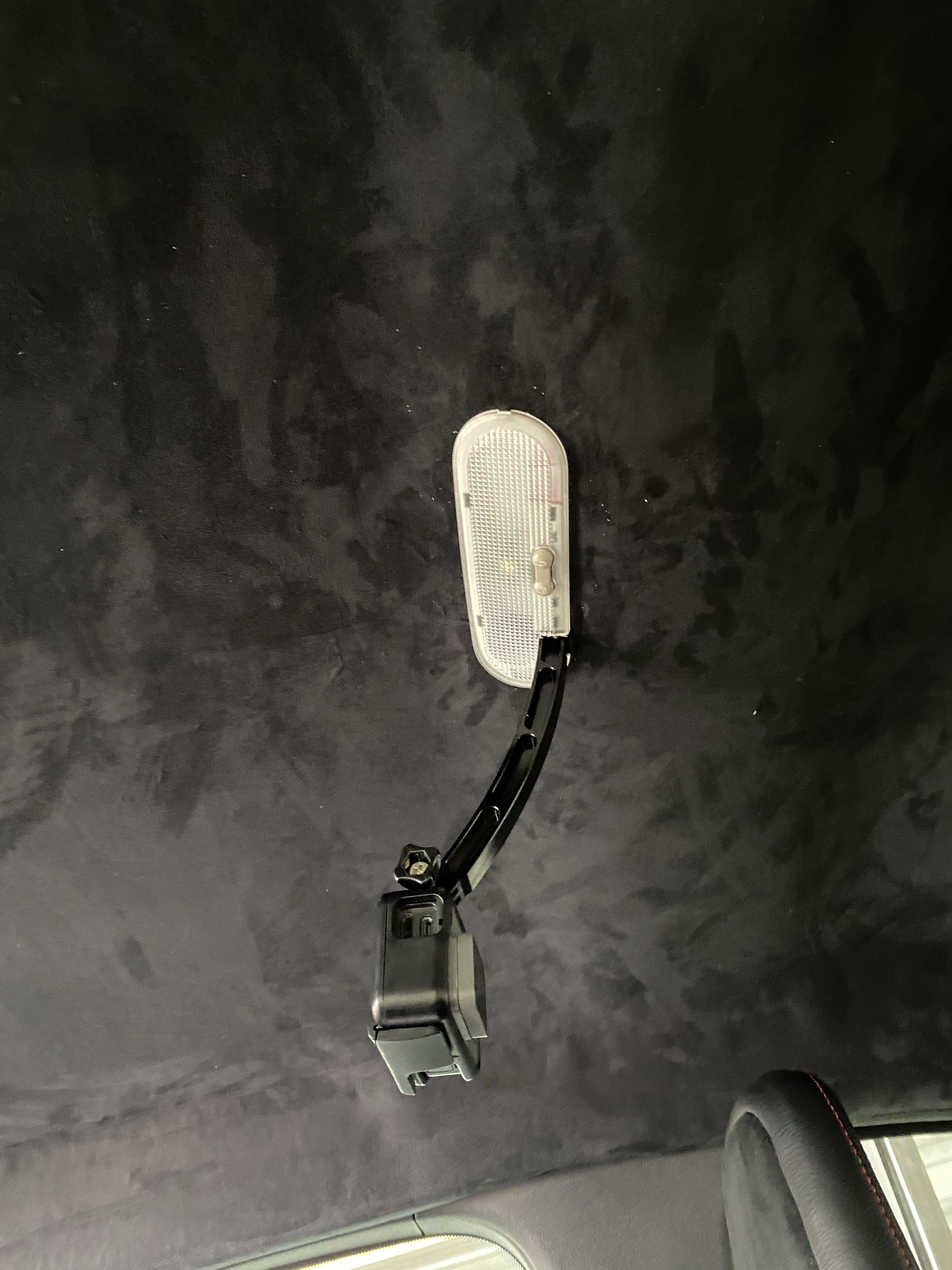

Mounted my go pro to the roof support bar and fitted though the light hole and managed to keep the light working.

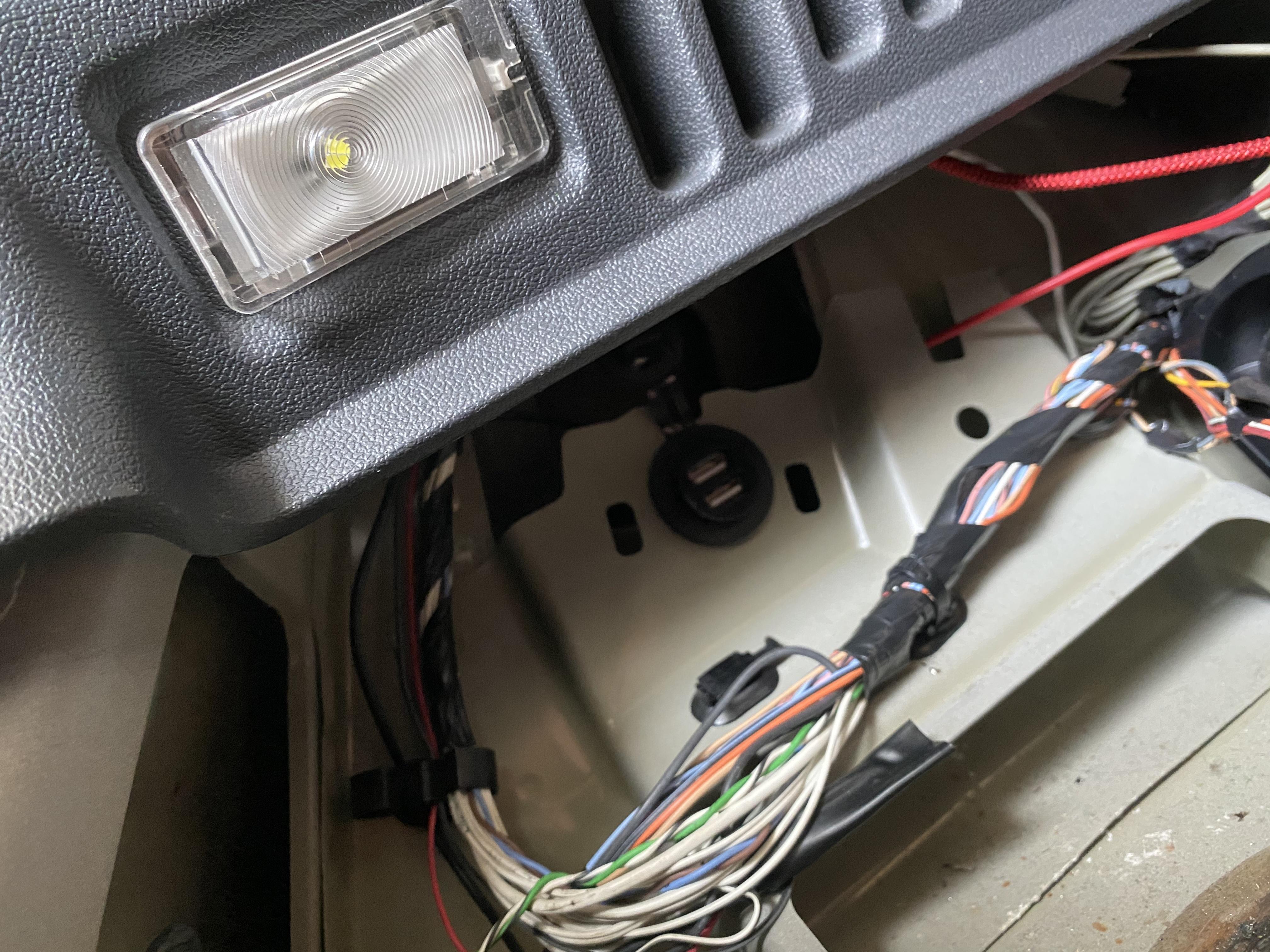

Next up was to get power to it as I find the go pro batteries don’t last that long so I mounted a USB port in the passenger side rear

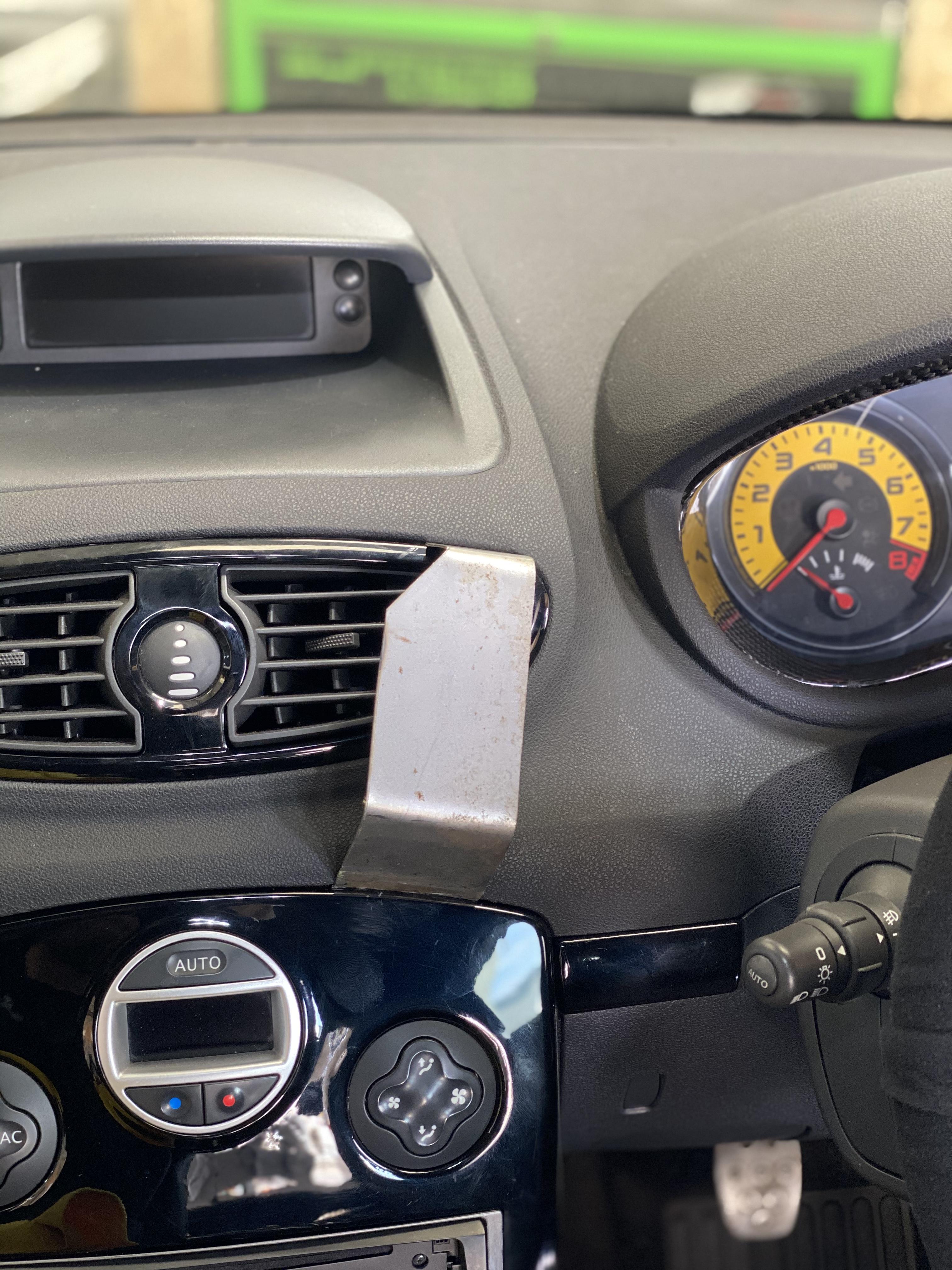

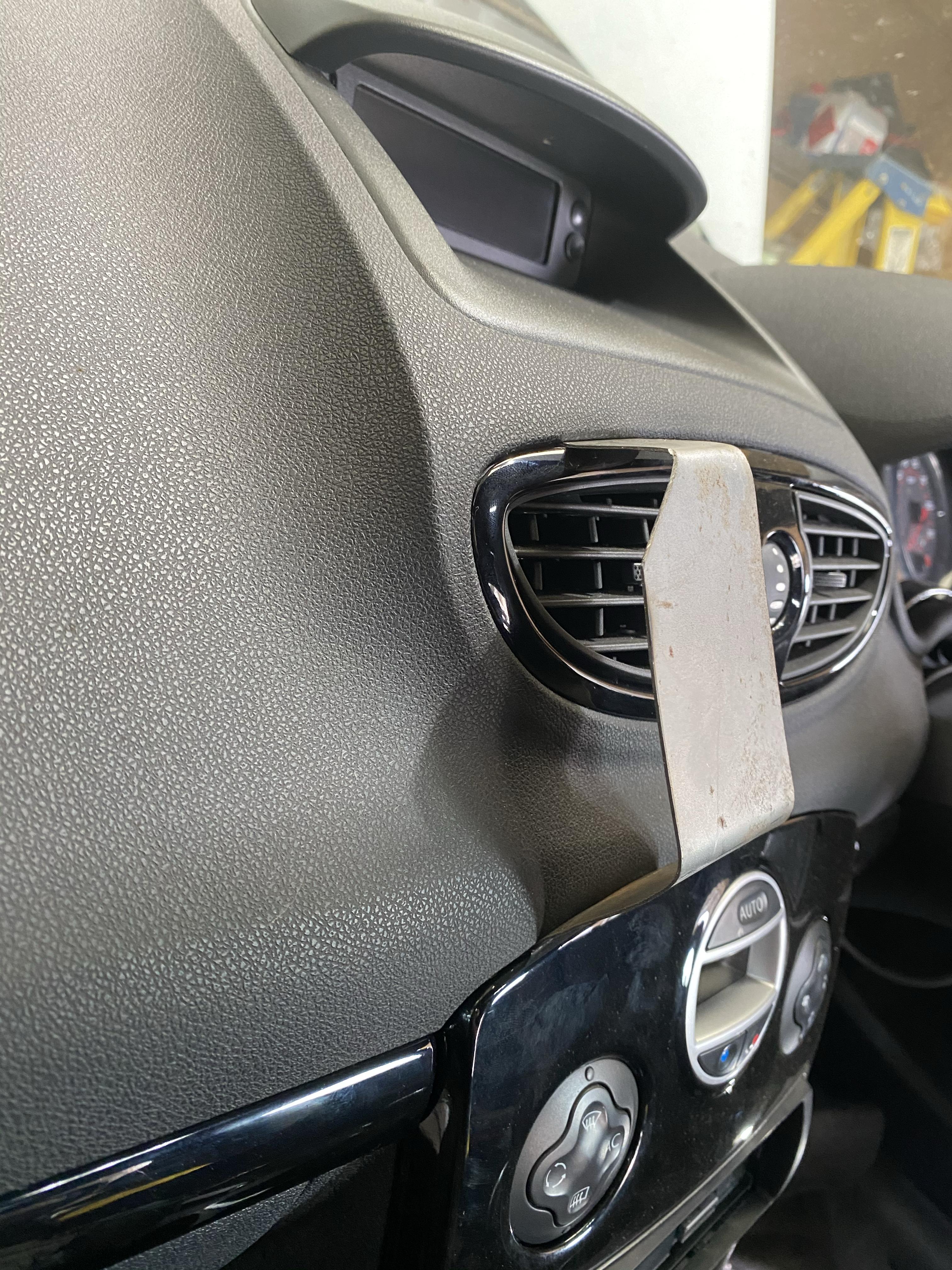

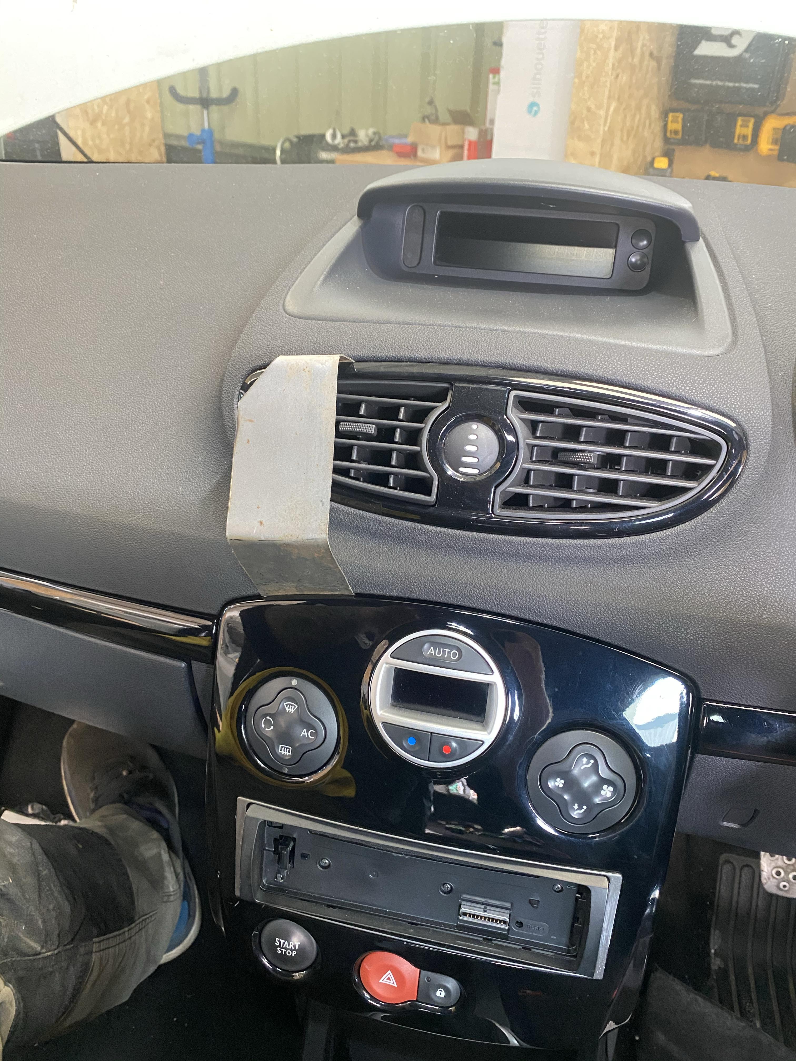

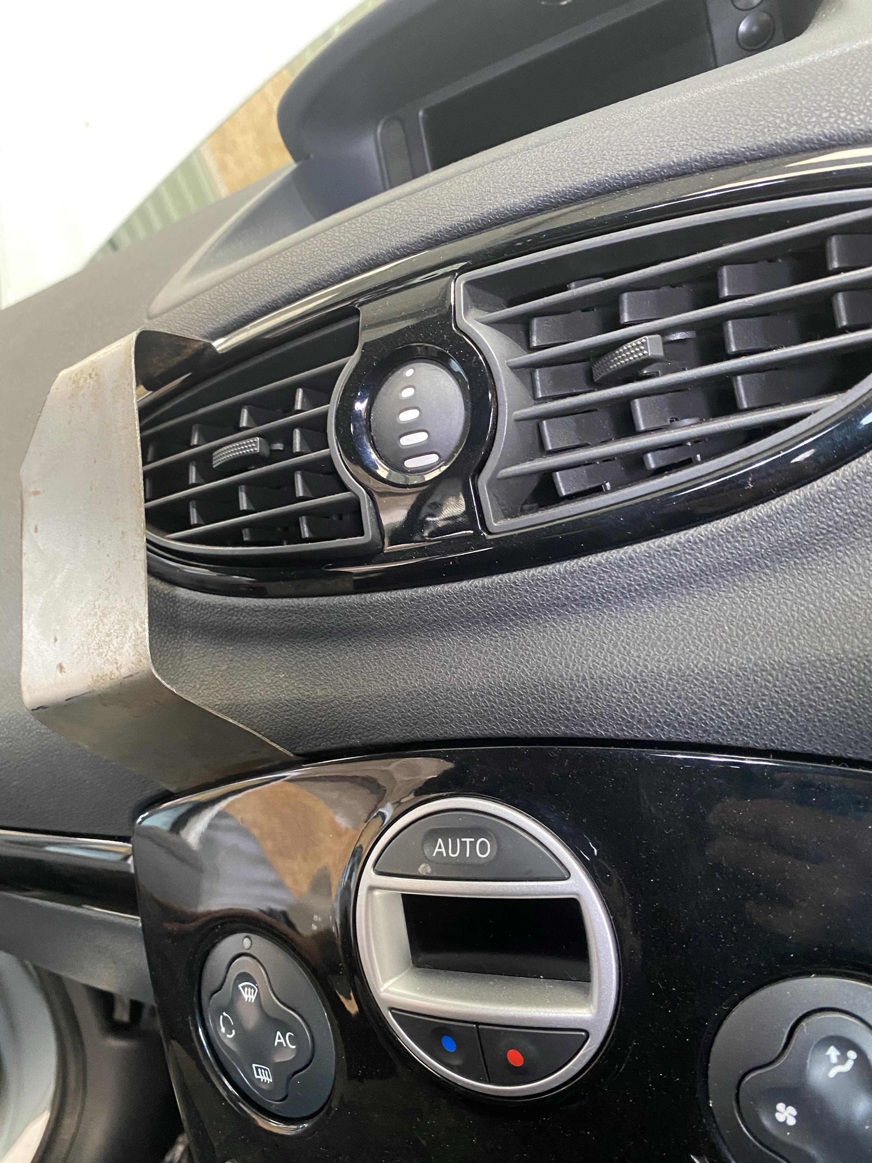

With that all sorted I wanted to get a decent phone holder but looked at the brodit ones and after deciding £30 for the mount alone was out of the question being this is a second track toy, I had some 1.2mm steel lying around so knocked up a quick mount just need the phone holder part to go on next.
Il get some paint and get it painted up over the next few days.
