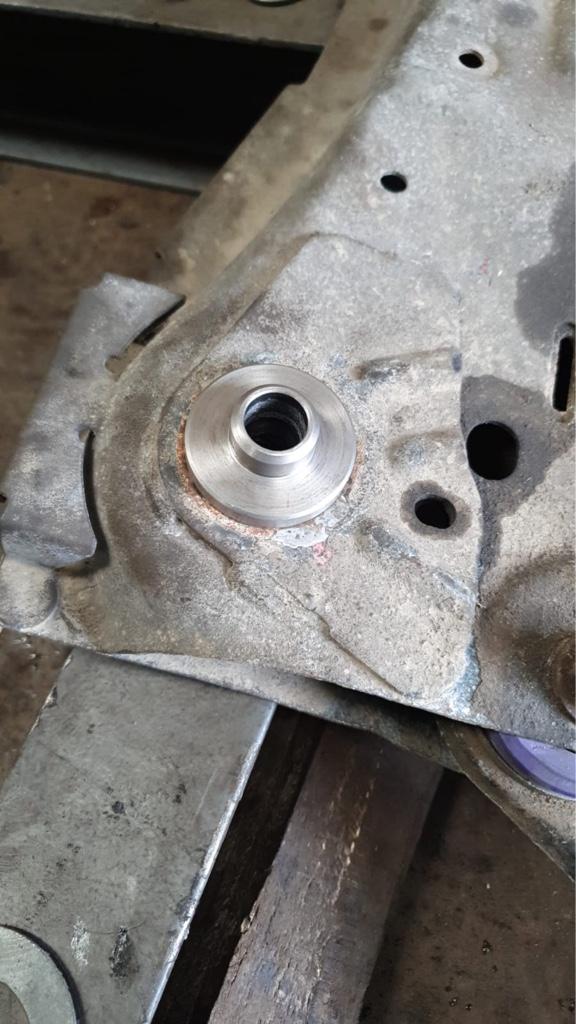

Has anyone got any photos of the josh wheeler solid subframe bushes installed going to be installing mine in the new year , and wanted to see how they fitted and where cheers
Paul

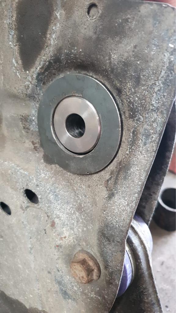

These are just placed into position pre-welded. They don’t press fit, they’ll need tacking then properly welding into position:

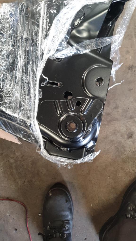

After welding I had the whole thing powder coated in black:
How do you find the solid subframe bushes? Would you recommend them on a modified road registered car, or are NVH levels too high?
If you're looking for enjoyment on the road then I wouldn't bother, it just adds to the headache of looking out for potholes, cats eyes and uneven road surfaces. You're sacrificing road comfort for stiffness, accuracy and less flex.
