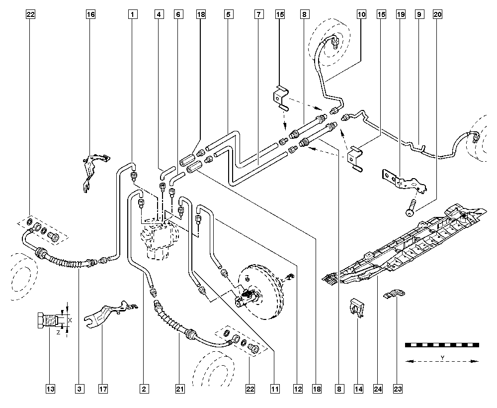

I'd noticed a small leak of something coming from the rear drivers side, which turns out to be brake fluid! Traced it back to the line that runs along the rear beam, where the pipe clips in its worn away all the plastic coating and eaten the pipe away :disrelieved:
Looks to be part number 8200658037, but are there any other OE options? Looks to be about £50 from Renault, I don't seem to think HEL etc. Includes the fixed lines, just the flexi's under the car??
