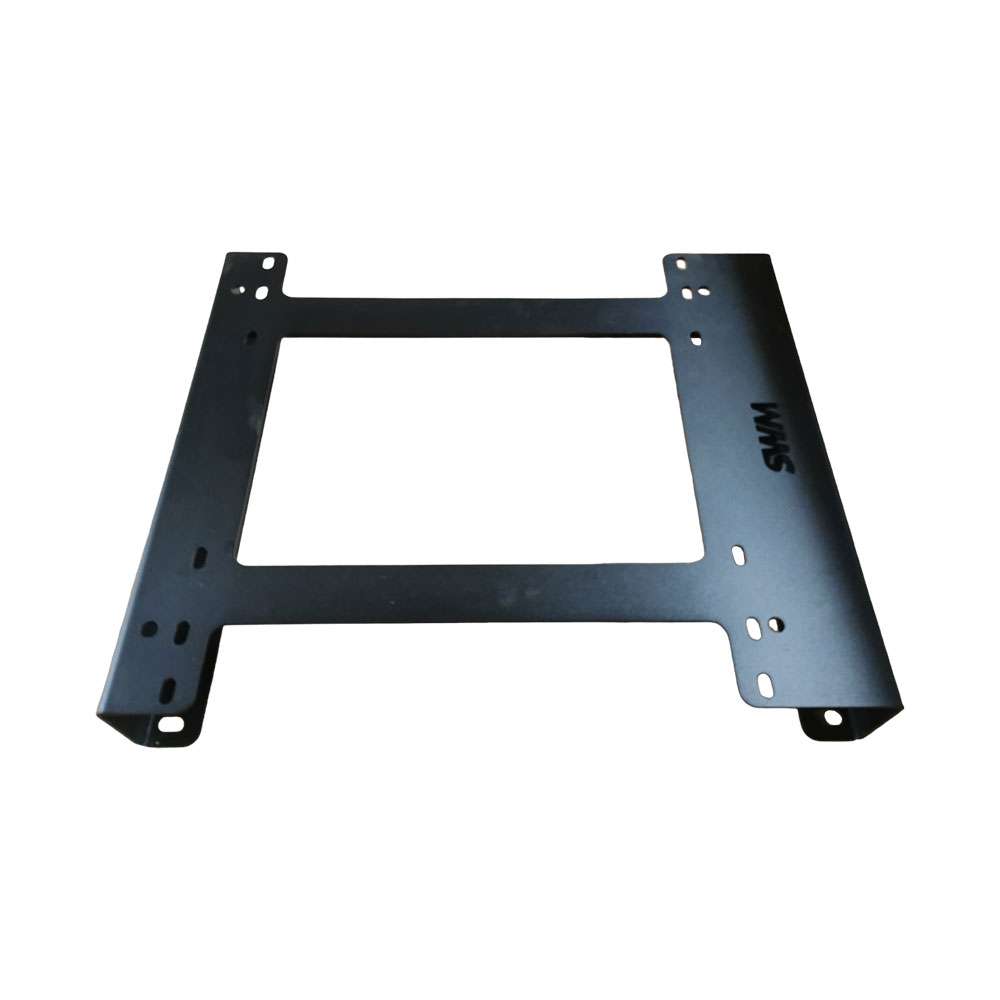

ktec do a subframe that seems to act as an adaptor -to which you could use recaro side mounts or sliders:
Gsm / sportseats4u does a recaro mount, its not really clear what exactly this is… i’m guessing its just a subframe. Desc says options will tell you what it is, but they dont, and the image is for illustration only
Havent actually found the recaro subframe anywhere yet!

The (official) recaro adaptor subframes specifically for Clio Mk3:
1. they do not direct fit to the car, they rely on you using the standard sliders off the stock seats.
2. they are TALL .. i mean, a slim low profile bucket seat with relatively short side mounts and they sit at the same height as stock sports seats.
3. they have no cross-bracing (like i'd expect an adaptor plate or similar to provide) so a little bit of sideways wobble

So far the best plan i have is to reverse the side mounts so that the rear of the seat sits lower, then drill new side mount holesat the front to lower the front. you can see pics below of the seats mounted with side mounts (presumably) the correct way, and then reversed.
I think with hindsight i should've just bought an adaptor plate and used the height standoffs/spacers i have to lift it up if needed. If i was shorter (i'm 6'0") i'd perhaps be fine with this setup.

going to keep the LHD passenger subframe setup, by reversing the side mounts and drilling some custom holes i've managed to get an acceptable height for a passenger (given their position is less important vs driver side seat/wheel/pedal positioning).
i've returned the RHD subframe and recaro rails. they're neither compatible with eachother nor much use for height adjustment.
worth noting the GSM website labels these subframes as 'direct fit', they certainly aren't (unless you include using the OEM rails as an adaptor as 'direct fit').
