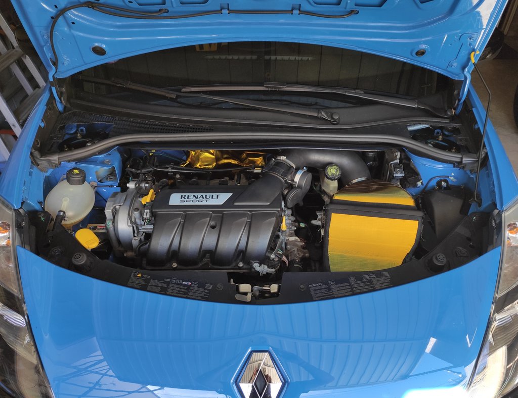

Next step for her is : 403 Catcams, new timing belt kit, new accessory belt kit. I have to decide if I send my plenum, my intake manifold and the throttle to MS Custom Engineering... To scratch some hp with a new map.

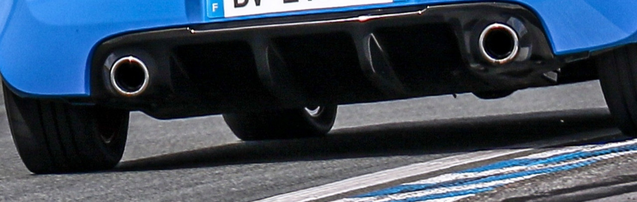

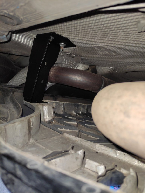

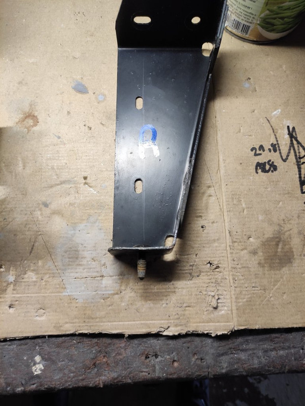

Can you please explain what the raised diffusor does and what you've done to raise it?

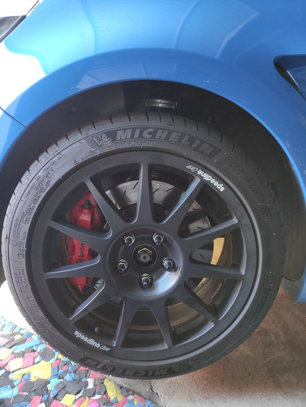

The R3 rims are Speedline 2120 Turinis?

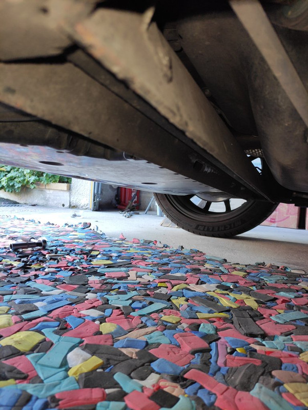

On the Clios, the diffuser is lower than the rear axle of the vehicle. In the photos it is quite clear.
The objective was mainly aesthetic, while limiting the umbrella effect.
Just cut and then resolder the supports close to the rear axle.
Yes, collected from a R3 Max race car
Thank you for the explaination and pics. I've never heard of an umbrella effect in that regard. Does this cost topspeed or does it negatively impact the generated downforce by the diffusor?
No idea of the effects, it would require measuring devices that I do not have.
For the downforce, I fear that the effect of the diffuser is anecdotal. It would take a full flat bottom for a real effect.
I’d like to see data, that’s nothing more than a picture with coloured arrows. Marketing, if you will.
