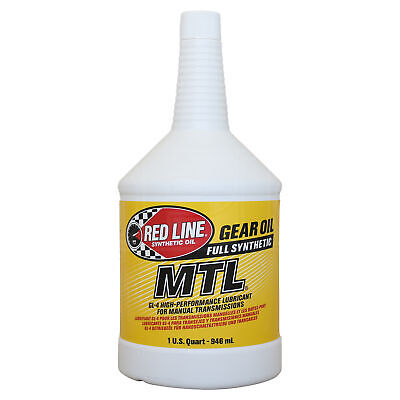

Could it be gearbox oil not being good enough quality for this kind of driving?
I had crunch in 3rd and 4th so I tried changing to a good oil as it had very good reviews on the forum and after some driving haven't had any issues since,I do try to be careful generally anyway considering the chocolate gearbox,and this is with the ZPO too.
+ for this stuff! I grabbed 2 bottles, just about enough!
