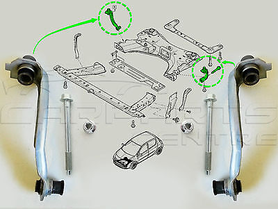

Hi all, I'm having trouble finding the correct front subframe mounts for my 197
I originally ordered these, as it lists 2.0 16v sports. I was messaged this morning to say they don't fit according to their main dealer parts system.
He provided these numbers, which I don't seem to get much back from
8200431515
8200431516
Are any differences in the Mk3 subframe brackets as everything brings me back to the link in this post.
Any help would be appreciated. Thanks.

These are the correct OE Part numbers as per my Clio 197 Chassis number.
I have checked on the OE parts site and this is what's listed.
Item 6 and item 7

Thanks Marc. What website is that? As I've been told that these part numbers are discontinued.
I've found a set on ebay. Not genuine Renault but says for a 2.0l 16v sport. I'm just waiting for a reply to confirm with reg.
The website is a Genuine Renault Parts website with username and pass required.
One side can be ordered from UK (1516) and the other side is back order (1515)
If you speak with a Renault dealer worth there salt they would be able to see if there is any dealer stock and then what Renault UK have in stock along with French stock. If coming from France you are talking 9 days.
I ordered the ones you've put a link albeit I ordered mine one at a time separately and they fit ok, same seller Johnboy or something like that. Mind you he sent the wrong side first time around!
