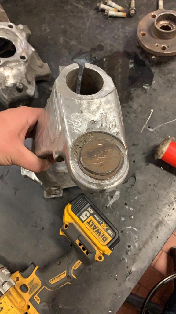

Front ABS bracket
alex.murphy2011
Has anyone got a pair of the abs brackets that bolt on here , thanks :smile:
If you still have the original brake pipes open the bracket jaws to remove the original hose from the bracket use some fuel hose to pack the gap out if you are changing to aftermarket brake lines and if you cant figure out make one slice along the length of the rubber hose so you can slip it around the brake line. New genuine brake lines come with the bracket fitted.
