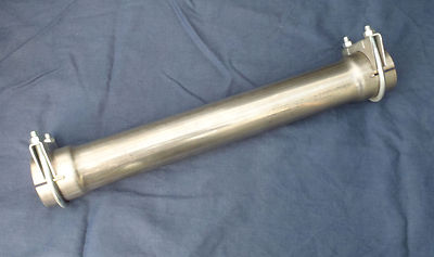

Easy DIY if you have an angle grinder?
Yeah I’ve got grinders welders etc, I might try one of these. Is there one that could delete the secondary ( main) cat at the same time?
My only reservation is that I’ve read that just deleting the centre box can make the flat spot worse? Mines already pretty terrible. If it can be Mapped out then I’m fine with that
Any exhaust mods will cause a flat-spot... Remapping is really the only way to eliminate the flat-spot, although it doesn't remove it completely. If you went for the gravity/toyosports catback exhaust, it's bolt-on from the manifold backwards. This eliminates the post-cat and middle box.
