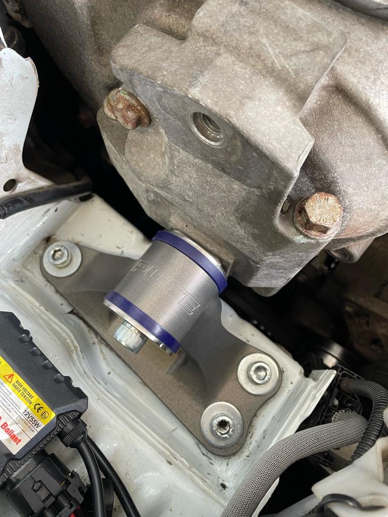

The PMS kit comprises 3 x mounts:
- Billet aluminium hard anodised upper engine mount
- Billet aluminium hard anodised upper gearbox mount
- TIG welded steel dogbone mount
All three come with uprated polyurethane bushes and mounting hardware. They are also serviceable.
Once fitted, the upper engine torque mount is not needed and can be removed.

Did you guys have any issues with getting the gearbox mount on the car? My garage is saying the central hole of the upper gearbox mount is too small to fit the mounting location. I will call PMS Monday, but wanted to check here first.
