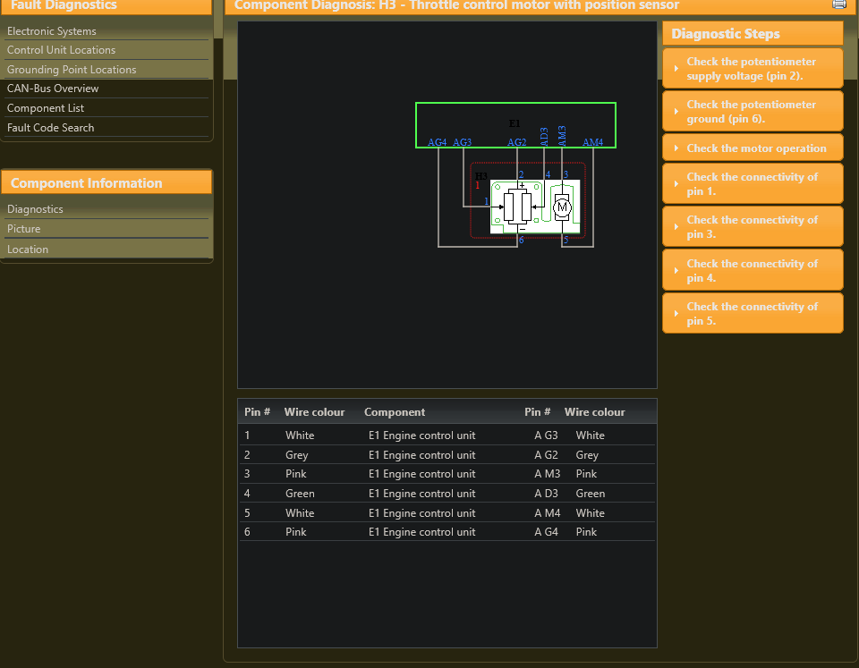

Have you looked at the throttle body and pedal connections and the plug to the ECU? From memory I think the engine will cut out like this if the ECU thinks it has lost connection with either.
Reactions: VeiRoNv2
Is this supposed to be wide open throttle? lol,it says full and 86% on my diag but the throttle body doesn't open anymore than this,this is just with the ignition on.
