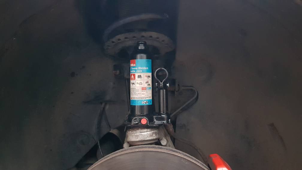

Thank you all for your advice
I managed to get both top mounts changes today
In the end I used a bottle jack on top of the upper ball joint. I found that tip from another post on here so I went out and bought myself a bottle jack and it worked perfectly
