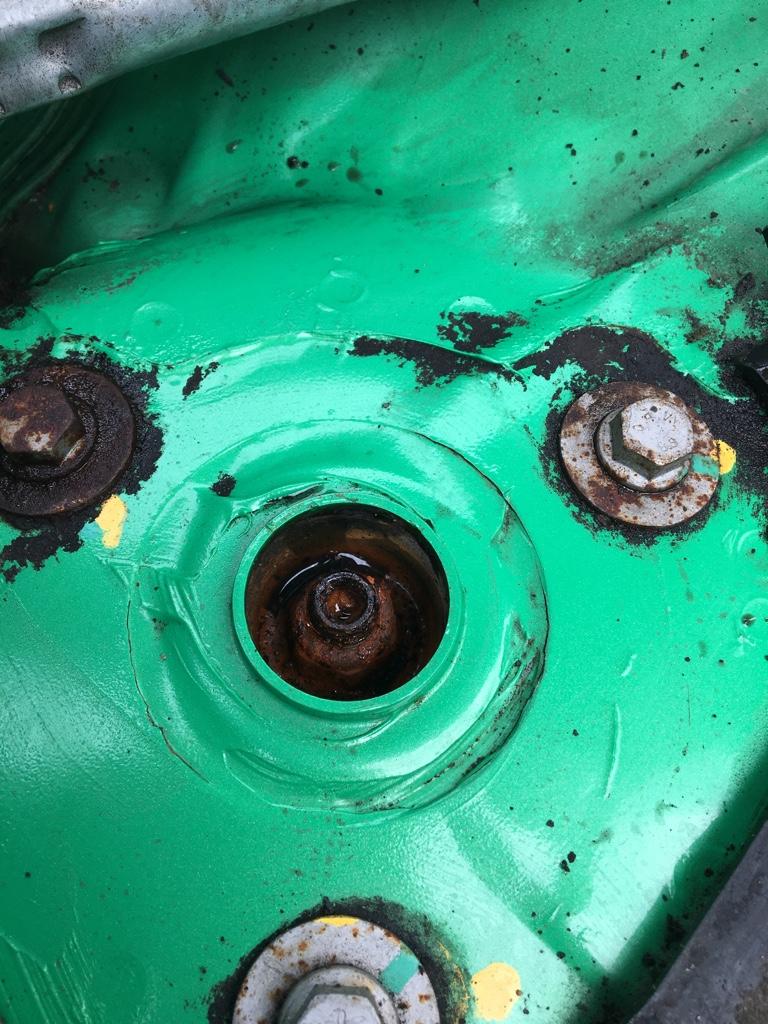

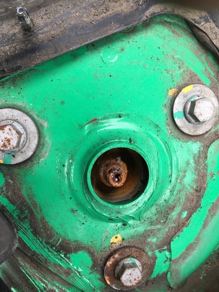

So I was cleaning the scuttle drains on my pride and joy. While I was at it I noticed what looked like a little crack on the strut tower. (At the 11 o clock position)
I checked the other side and it seems to be almost all the way around.
[emoji24] has anyone else come across this?
The state of those top mounts is horrific!
It shouldn’t be much of an issue.. as its no where near the fixing points, always just cut it out and get adjustable top mounts
They’ll definitely be getting replaced anyway. Is it just the sealer that has cracked I wonder?
