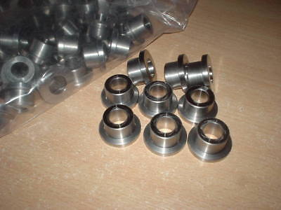

have you made sure the metal bush is in the hub steering arm?????
its like a small top hat shape...they usually come out with the old track rod end and if you dont swap them over the new t/r/e dont fit correctly...

Craig you cannot buy it separately, Tim Finch used to make some (and someone else I cannot remember).
If yours is currently stuck on the ball joint, heat it up (or i've seen people take off the track rod end and heat it up on the stove lol) then use a windscreen wiper removal tool (or ball joint one, as long as it's the screw type) and it will come off.
