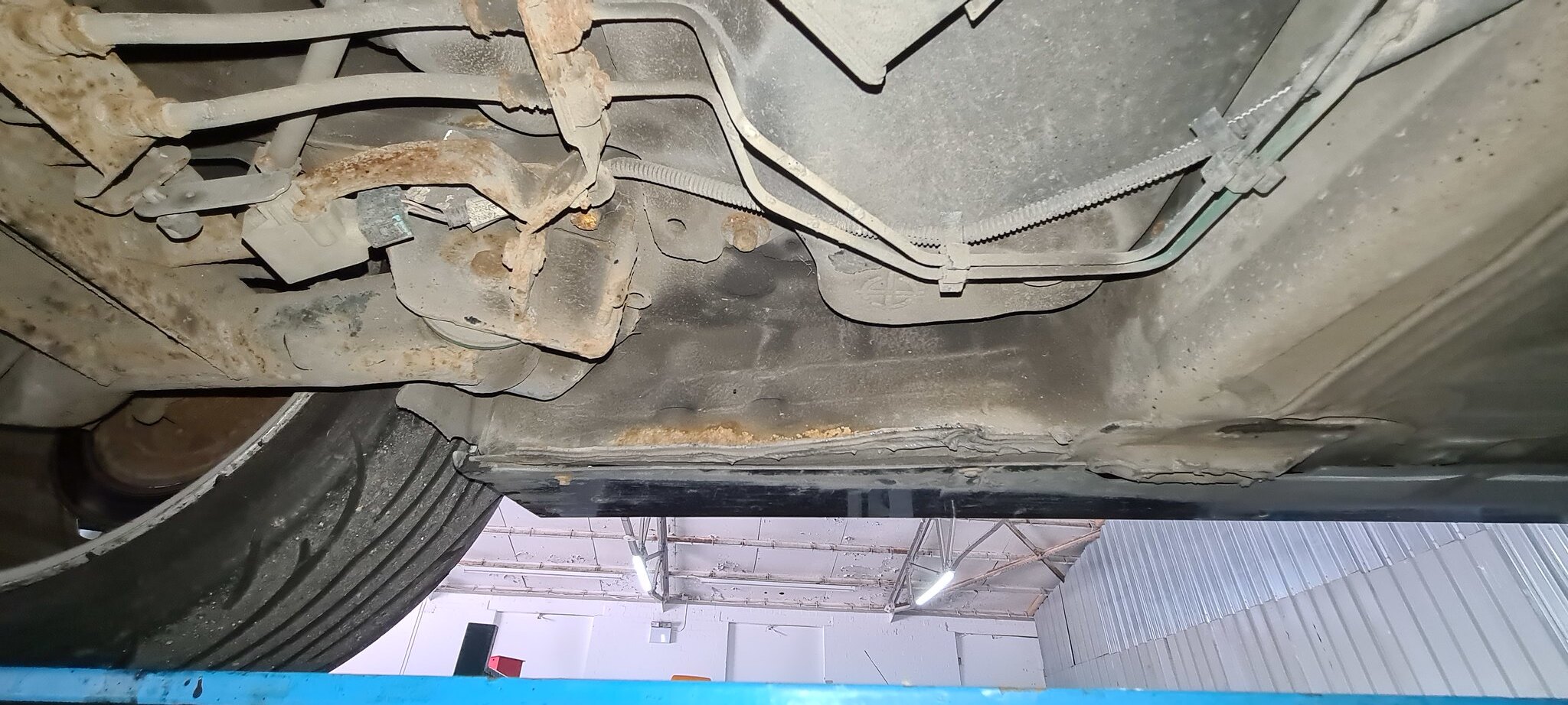

One of my mates kindly let me borrow his lift so i could get a good look around the new motor.
One or two surprises but all in all not bad,

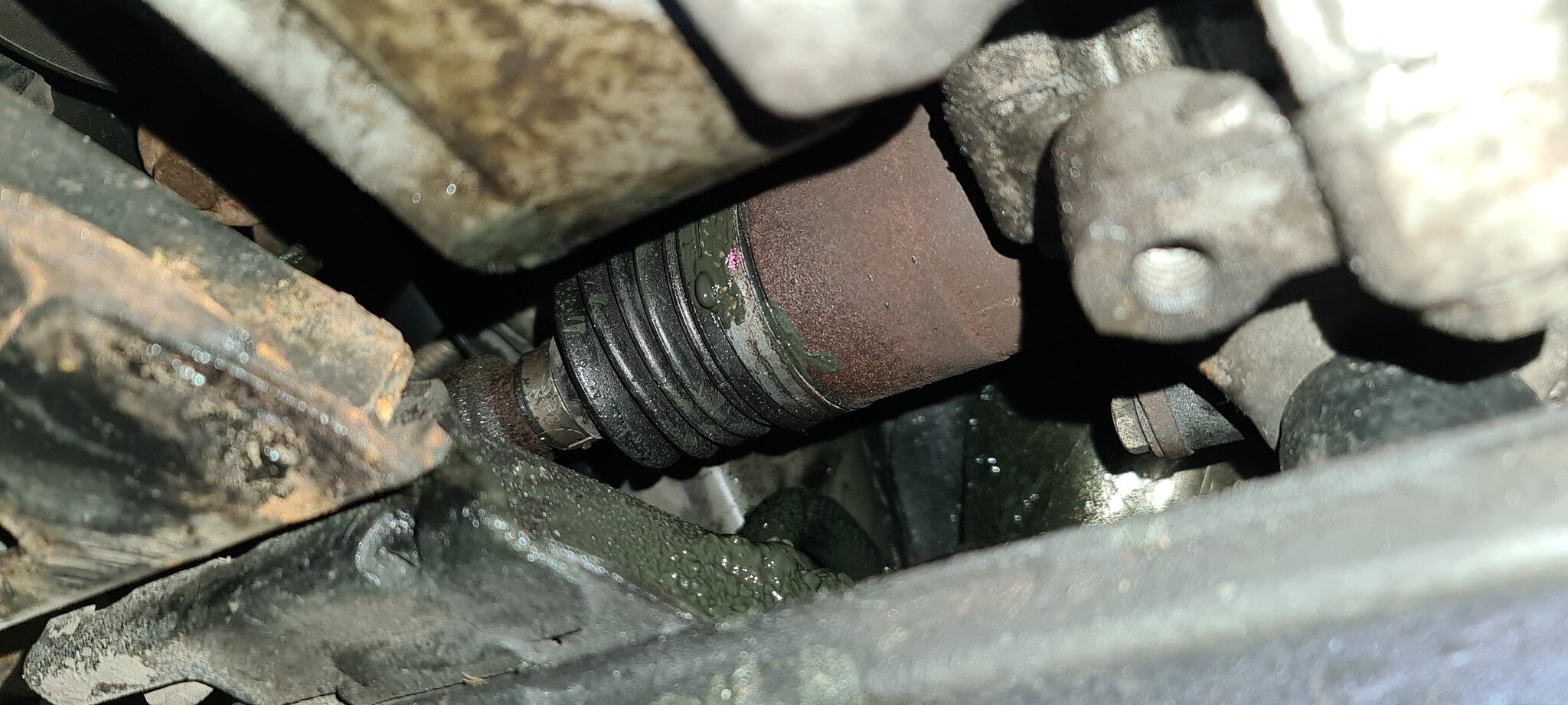

Drivers side CV boot to the half shaft either isnt on all the way or has died, cv grease everywhere... yey !

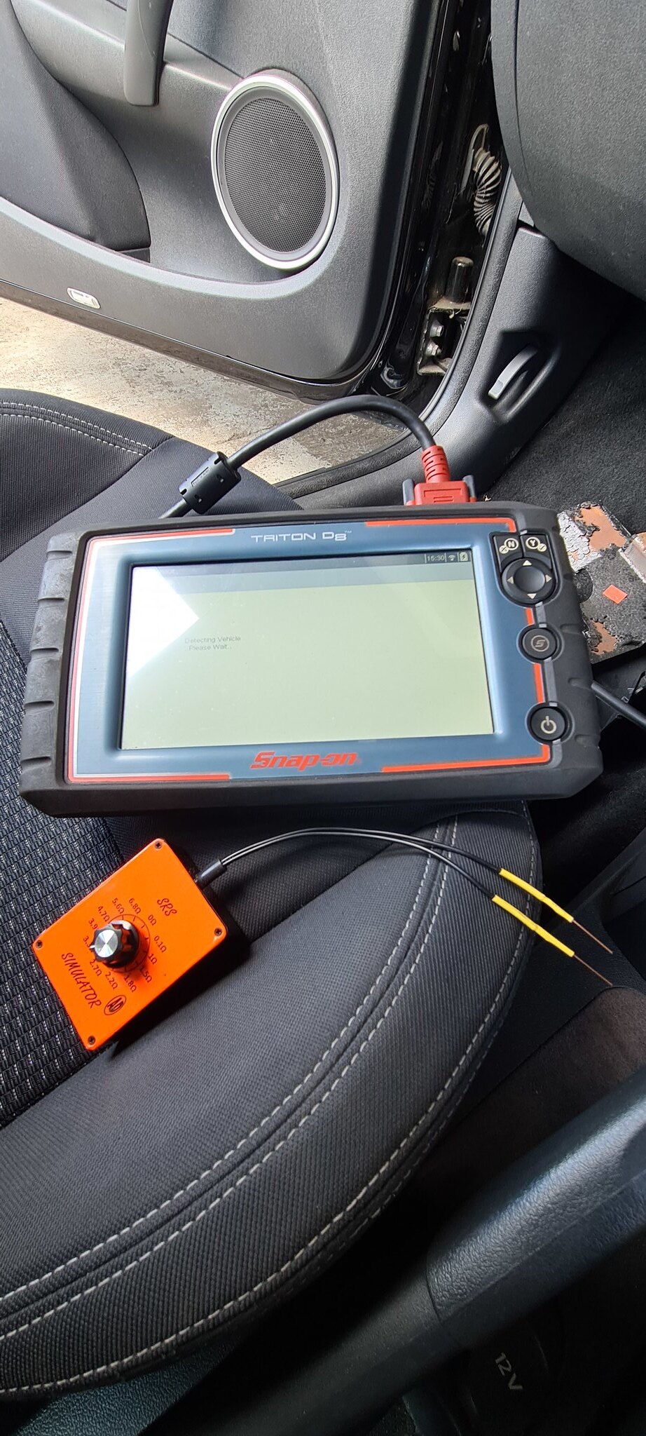

Borrowed his snazzy snapon scanner to see what the state of play was.. quite a few issues but im 99% sure the majority are due to the steering wheel not being standard.
Speaking of which does anyone happen to no if you need to run the clock spring for things like abs to keep working? do they have a steering angle sensor on them.

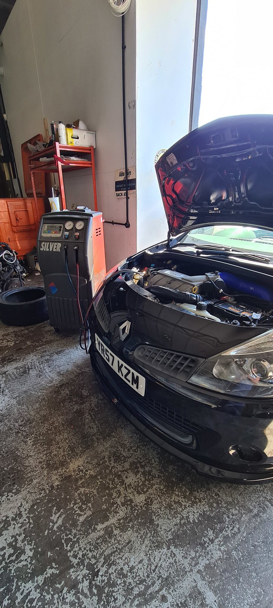

Moving through the car i hooked it up to the AC machine to see if it would hold a vacuum, hey presto it works ! so i now have AC again, quite nice ! Although i found out that fan number 4 doesn't work, 1-3 work fine but when you hit 4 it shuts off, im assuming a dodgy contact, ill investigate more later on that.

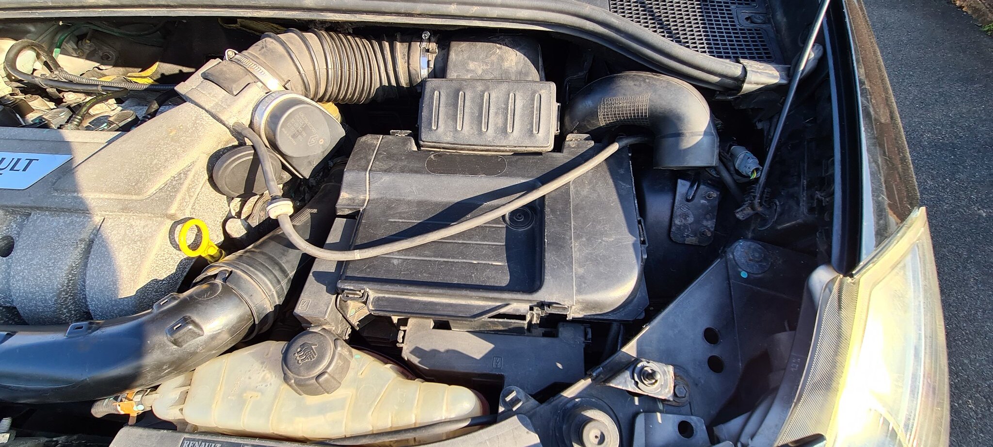

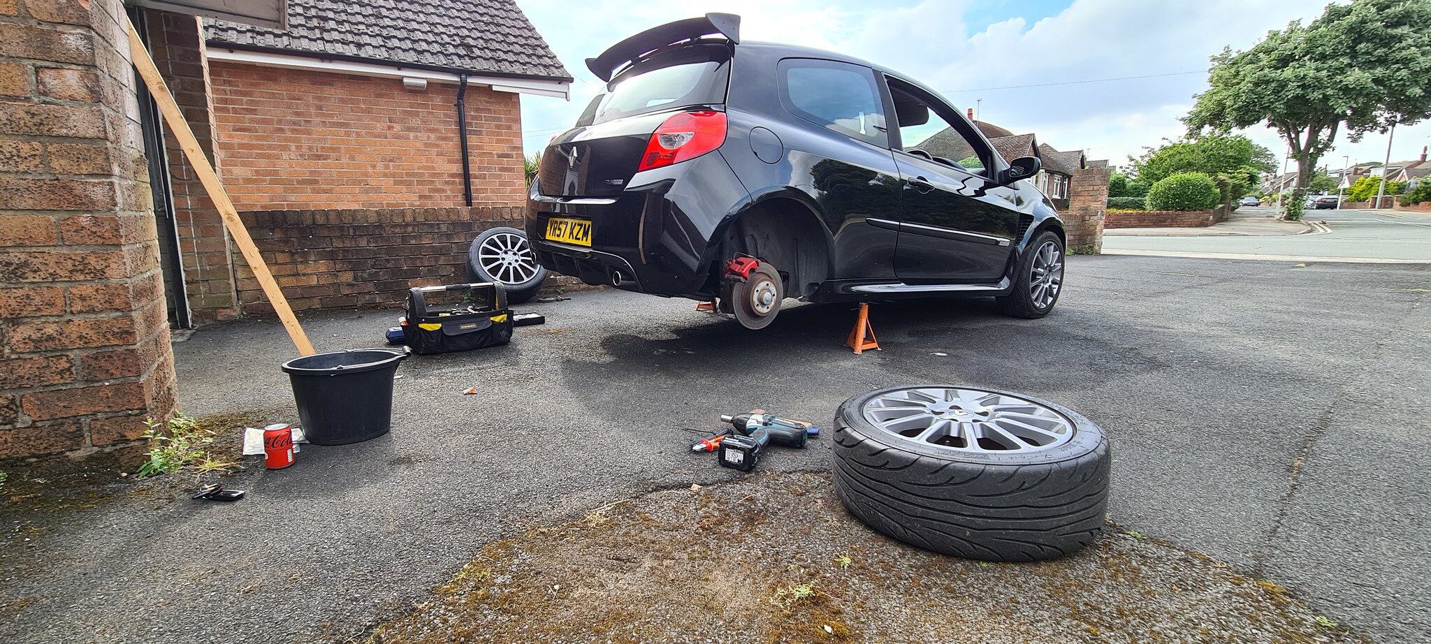

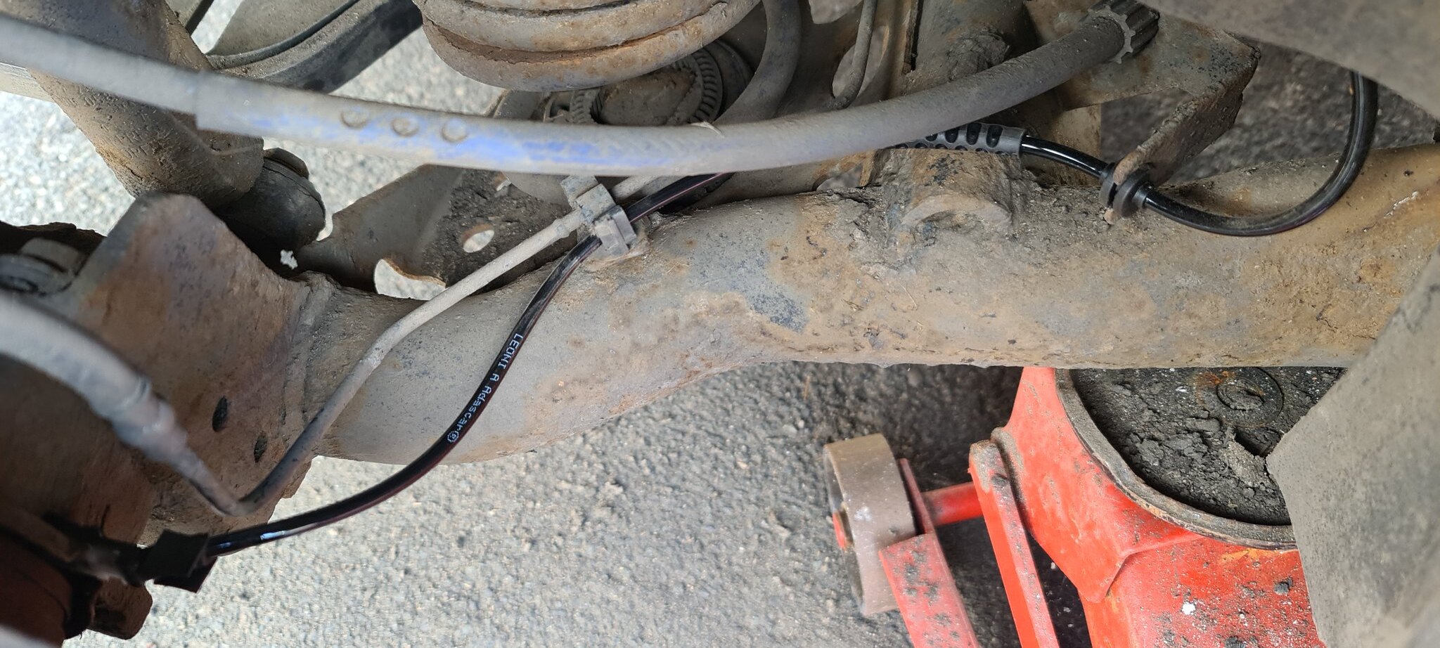

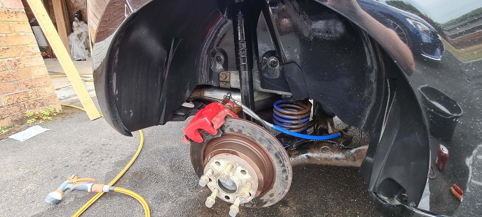

I didnt want to take the mick on the free lift time so i came home and refitted the stock airbox and the new rear right wheel speed sensor. This in itself was really easy but iv got loads of unanswered questions now ! if anyone could help out that would be great. ill put them in between some pictures below.
New Sensor in

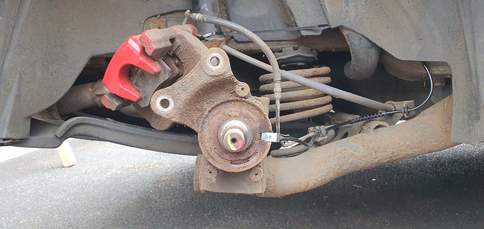

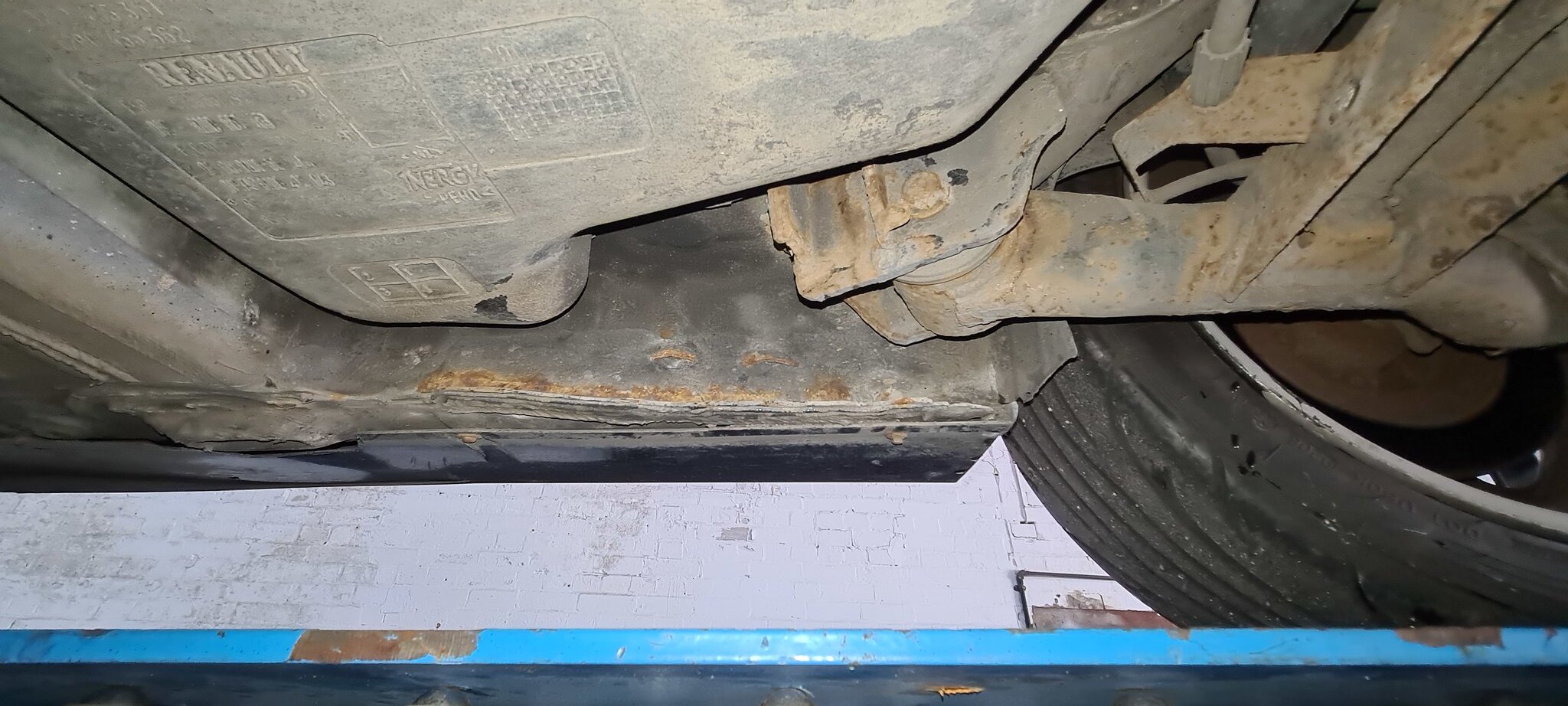

Bit of Rust Developing on both rears.
AC topup :smile:

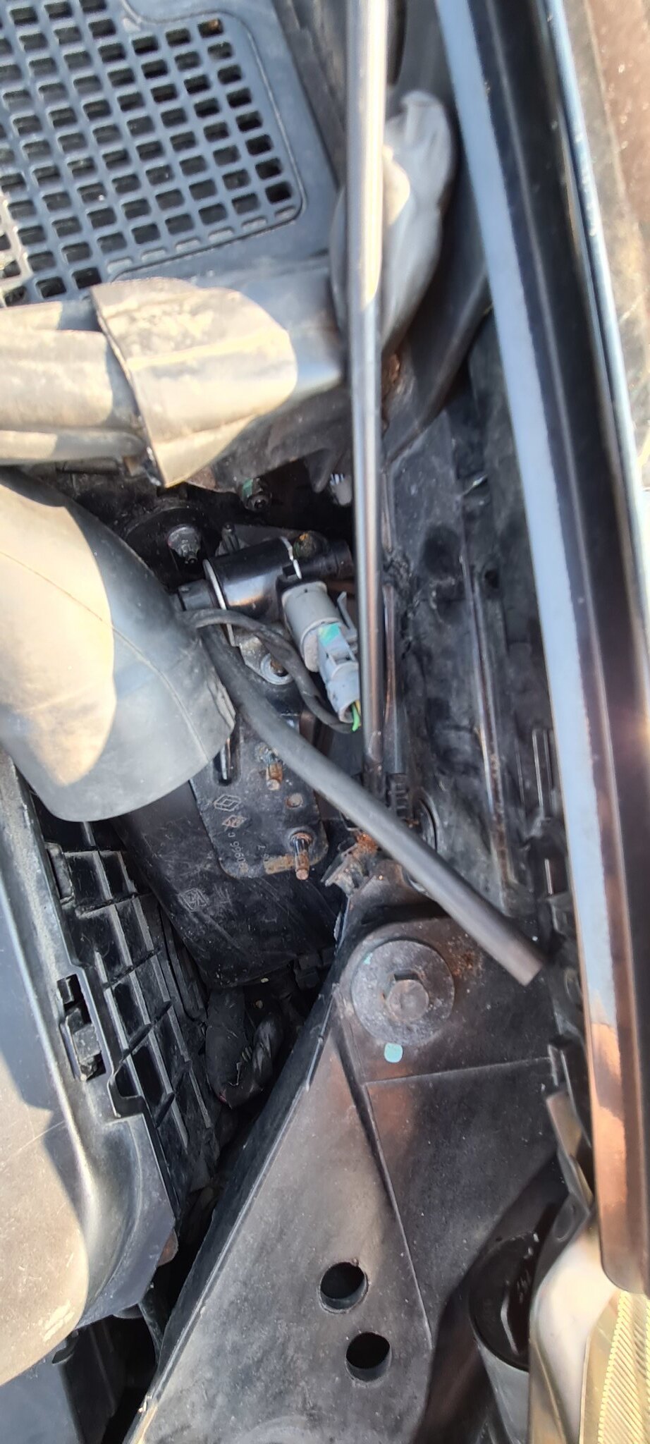

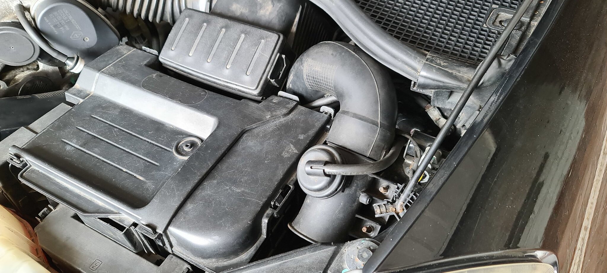

Question Time, can anyone tell me whats missing on the right hand side, im fairly sure itl just be a tube that runs into the passenger side arch liner + more importantly that vacuum hose that comes across the battery, is that correct? it goes to a device on the right then a small tube comes out and goes nowhere.

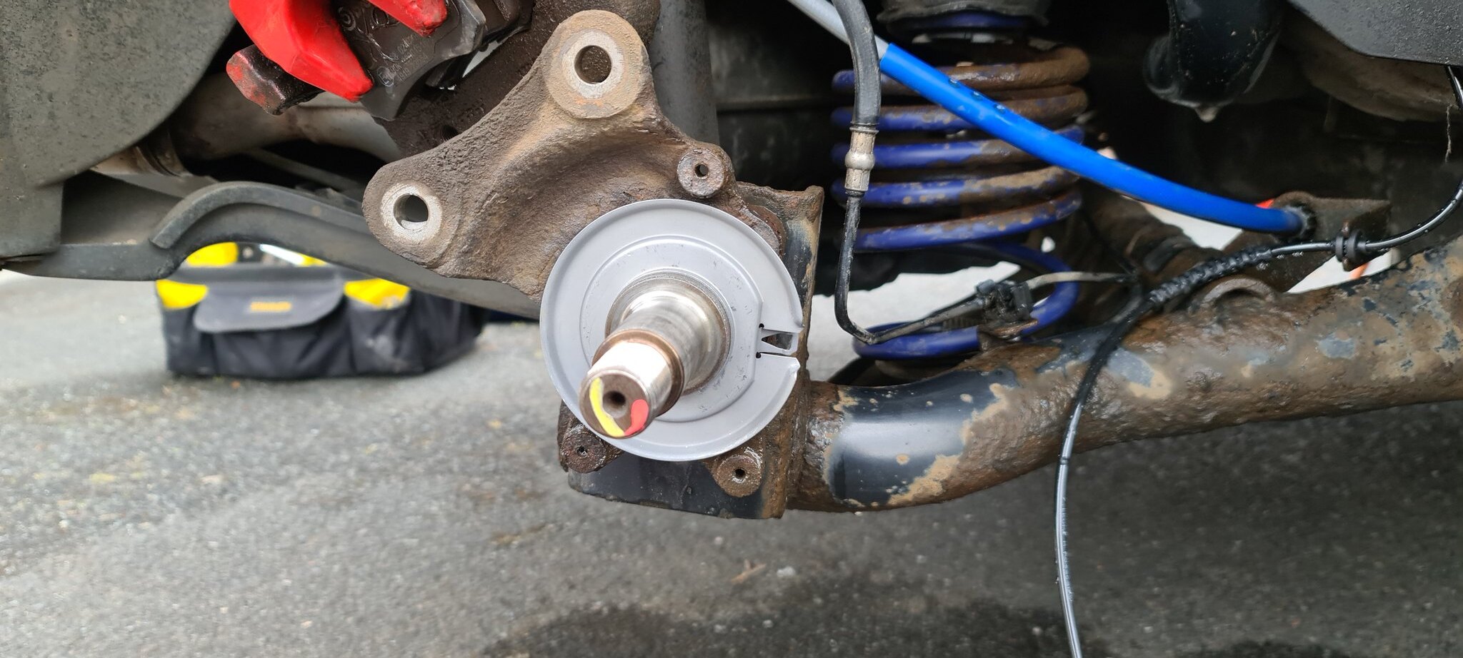

Now unfortunately the new speed sensor hasn't resolved the issue with the ABS lights coming on which is a bit of a pain, but at least its new. More on the fun side of things, new parts are on there way, iv got a set of OMP buckets with all the brackets and fixings on there way, downside is the floor mounts are in italy... really hope they get here in the next month.

You are missing the acoustic valve from the end of the airbox. It is a bit of plastic tube with a valve in the end of it that is controlled by the solenoid in your last photograph.
Reactions: PaulF
The pipe that goes into the inlet, goes into that solenoid, it is controlled by inlet pressure and opens the acoustic valve (mentioned above) that is missing.

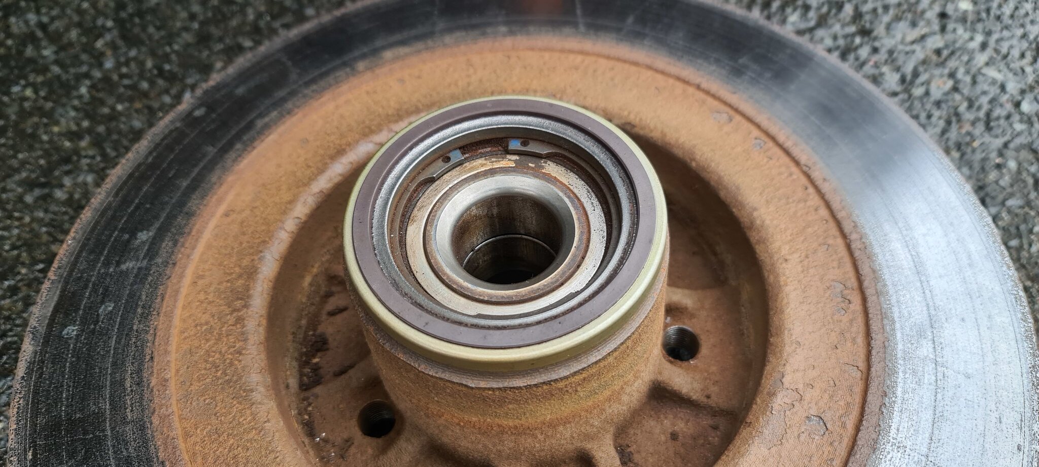

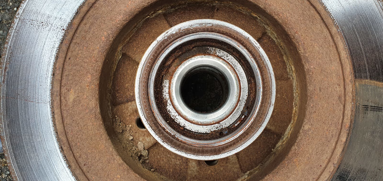

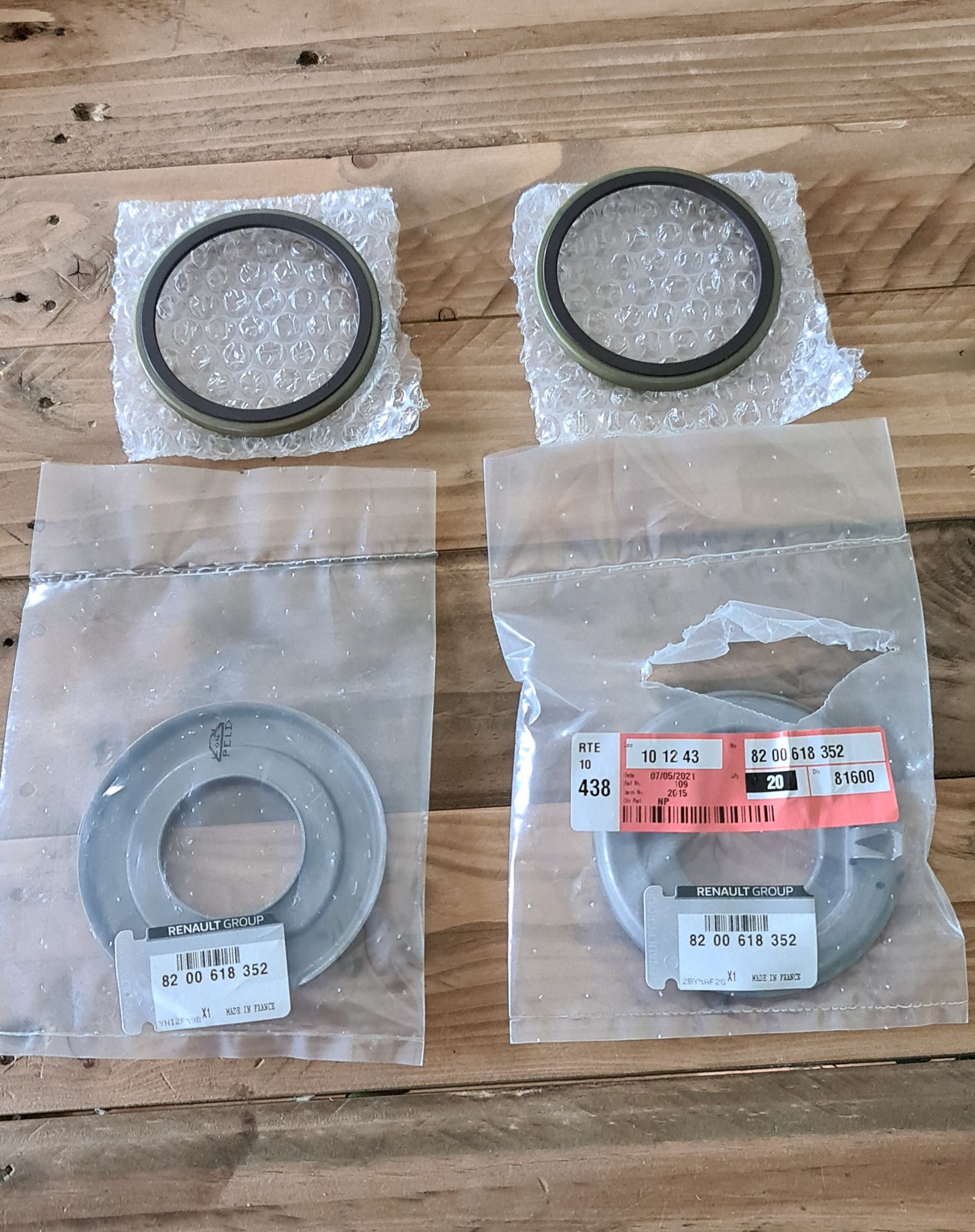

Also regarding your ABS problem, it'll be the ABS plate that has corroded and damaged the ABS ring on the rear discs. Take the disc off (36mm nut in centre of disc) check the condition of the ABS sensor plate.
If it needs changing, it's about £18
If it's also taken out the ABS ring on the disc, you can buy it from eBay for about £7
The centre nut of the disc needs to be done to 175nm (don't over tighten it, or you'll ruin the bearing)
Here's a post from my thread of how messed up mine was, if I was you change both sides.
Last tip is, the stub axle has an indent, make sure the sensor plate lines up with that (you'll see when you get the plate, it has a bit that sticks out that the sensor goes into, it needs to perfectly line up with that indent) or you cannot knock it far enough back, which then means when you tighten the nut to 175nm it will be rubbing.
So knock it as far back, then put disc on, tighten to 175nm, then spin the disc by hand, if any friction, take it apart and start again, the goal is free spinning, or you'll take off the ABS ring strip then the light will come on again.
You were spot on there by the looks of it suj thankyou. looks like both need replacing on both sides.

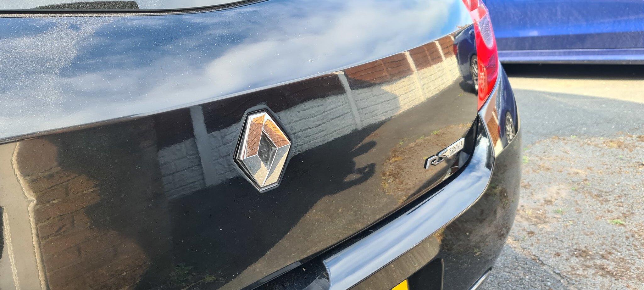

However it didnt stop the mrs sorting out the rear badge, removed the knackered overlay stuck on and gave the original a polish up, much better !

New Stuff on, the old one put up a bit of a fight but gave in eventually.
New ABS Ring, the old one had a small line of material left, this has much more ha
Back together and a good clean later.
The other side wasnt as bad but i like doing things in pairs so that got the same treatment too :smile:
@suj thankyou sir abs all fixed !

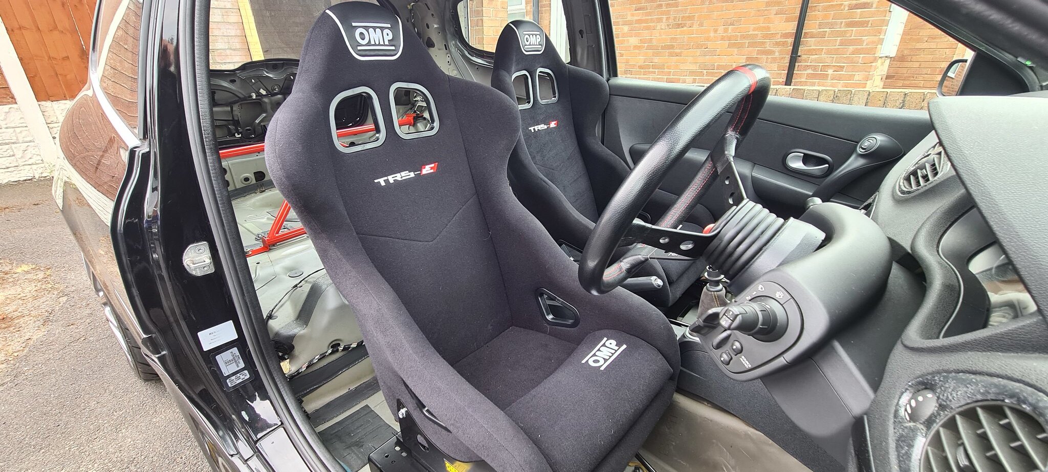

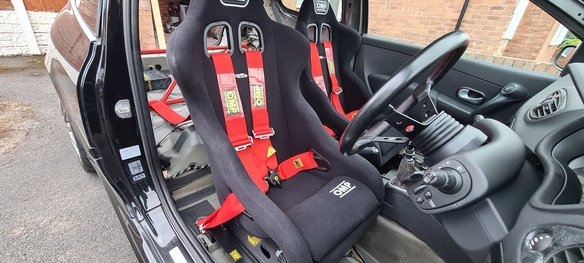

So i finally got some time to have a mess with the clio again, Stripped out a bit more of the interior, fixed a whole bunch of rattles on the interior and installed the new seats, they are snug and feel a little undersized for the car but after a bit of messing about i got the drivers seat into a good position so im happy :smile:
Just waiting on the harnesses to arrive now, i may have made a slight error when i bought the first lot of harnesses, in my excitement i didnt spot they were for 2 seaters... so there way to short, ah well haha.
Im going to pull the rest of the sound deadening out eventually, currently its keeping my feet in the right place, ill grab some foot plates at some point and sort it all out.

so harnesses are in and fitted although the pic i got was from a while ago but yeh you all no what harnesses look like.

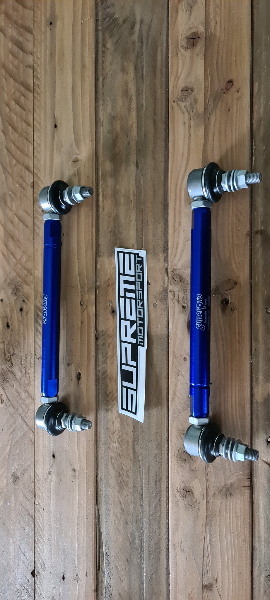

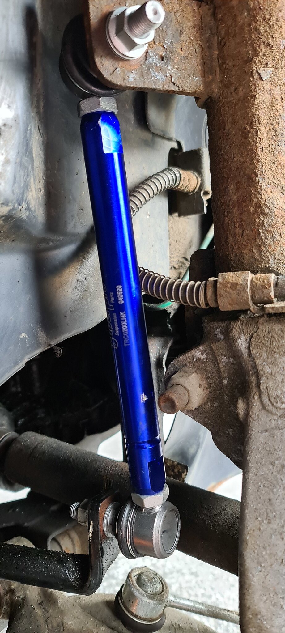

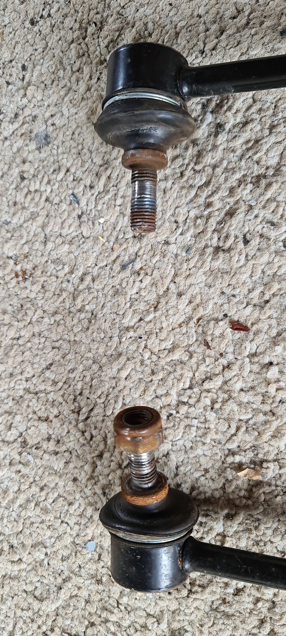

once that was all sorted i turned my attention to the really bad knocking sound i was getting. Fun story eventually. took the fronts off to see if there was anything obvious and result, yes there was, both drop links were stripped on the threads.. not entirely sure how that's come about as it was knocking like that when i got the car, either way i see it as a really good excuse to buy some shiny bits !
And after some shopping on my new favourite site the nice guys over at supreme motorsport sent me these.
And fitted
Harnesses layed in
And i had a helper to put the old seats in storage.... shes only 6 months old.
