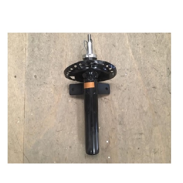

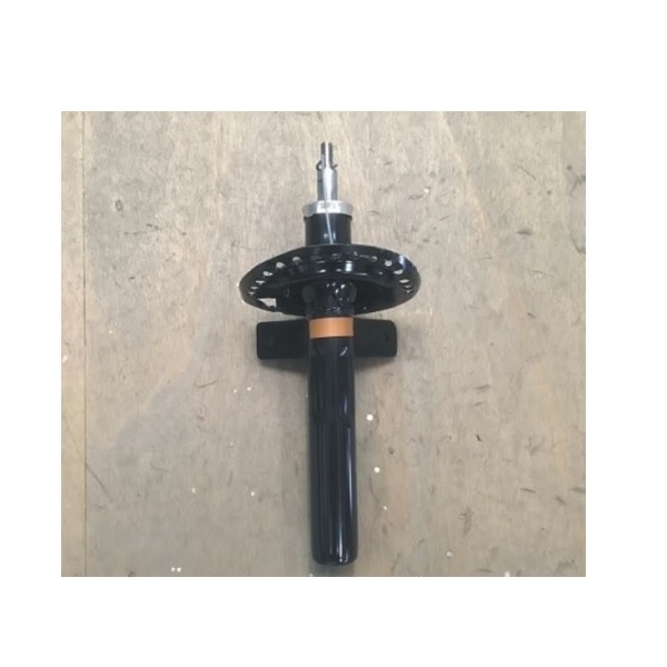

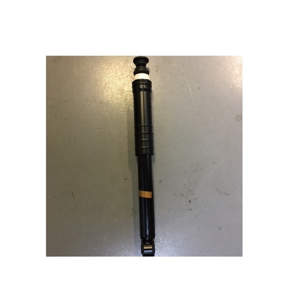

If you have early large mounts, then these are the Cup dampers you need:
Fronts:
Rears:
If you have later small top mounts:
Fronts:
Rears:
Fronts:
Rears:
