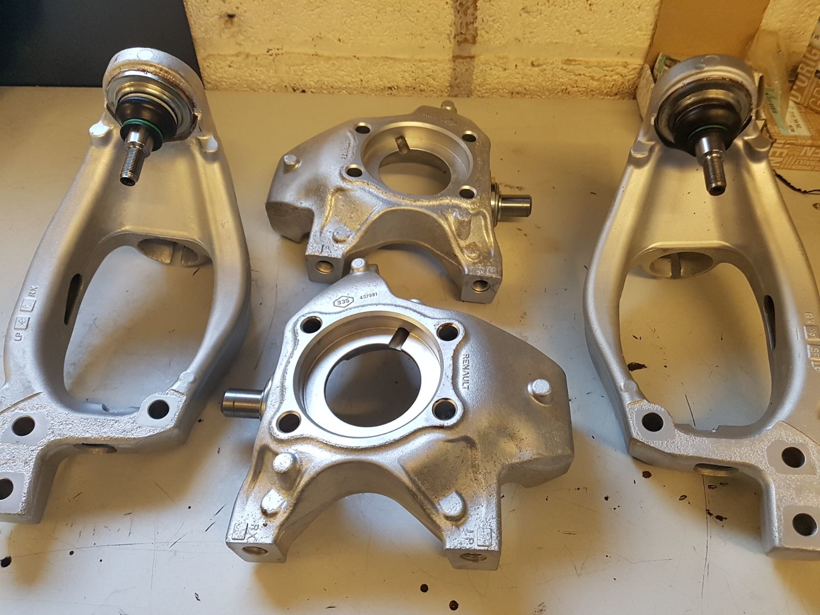

    Blimey I haven't updated this for ages. I had to go back quite a few pages in the section, always a sign of how long it's been!
    I took the car back from Sean about a month ago, I just didn't have the time to do a proper update. Lots of bits and pieces done, service, preventative maintenance, upgrades and restoration. As mentioned on a previous post the whole lot of the front bits were taken to pieces and sent for vapor blasting. Whilst at it we decided to change all 4 ball joints, no play there at all (obviously) but I hadn't ever changed the top ones, now it was the time to do the whole lot. We also did the anti rotation links and droplinks as these cost peanuts. Inner rods inspected and maintained accordingly, all calipers the same. Subframe replaced with an already restored one, rear cup racer axle fitted alongside the new 2 piece rear brakes, cambelt service with all peripherals done and engine covers also vapor blasted, yellow seat belts fitted, rear anti roll bar removed (for sale) and various other tidy ups.
    Not any feebdack from the upgrades as yet as I haven't literally purposefully driven the car at all. It was snowing the day I picked it up (lol) and raining even since. Unfortunately (or fortunately??) I've got tons of holidays coming up so I won't be driving the car at all, however I've got Brands booked in for beginning of July and I'll be booking Mallory Park for end of May.
    Some pics;

    @Cossers I got them from a member in here mate, I've been looking for a set since Renault fitted them on the yellow pack'd Clios (back in 2010 iirc) but buying new would be so expensive. Last time I checked it was £75 each for the front ones and £125 each for the rear ones! I got the whole lot for £100 so not bad:smile:
    @trackspec197 these are bespoke rear hubs mate that I initially fitted quite a few years back. One bearing failed though and it took the hub with it so I had to have them made again. A machinist in Greece built them, I sent him a pair of OEM ones and he created two identical hubs from aluminium, using the discs (rotors) from the OEM ones with the bearings and ABS rings. These bad boys are 3.1 Kgs lighter per corner.
