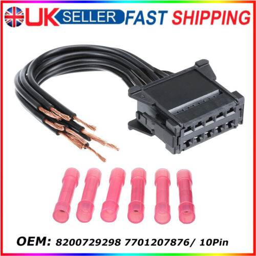

Check the connector most likely it has melted around the pins you can get a new splice in part but what I did so I did not cut the loom is remove the pins and put them into the new connector but best to check the pollen filter if it is wet or blocked that's the main cause of the heater blower coming under load and melting the connector. Trying to see if it was wet is the hardest to check the scuttle bay can fill with water and spill down into the pollen filter which most likely will have dried out when you go to check it. The one in the picture would not run on number 4 position and the resistor you see is for the non climate control option ( not the digital digital one) but check this out first its simple and all mk3 Clio's have the connector so you have a chance to get it local.

Find many great new & used options and get the best deals for Heater Resistor Wiring Loom Harness Connector For Renault Megane Scenic Clio MK3 at the best online prices at eBay! Free delivery for many products.
OK you seem to have Climate control look at this picture check the other plug for melting the climate control has a sub harness find and check the plug further up the harness which is the non climate control plug. Or someone has already spliced in some other resistor pack to fix yours before you got the car as yours is missing the two screws that hold it in and is sitting the other way up in the housing.
